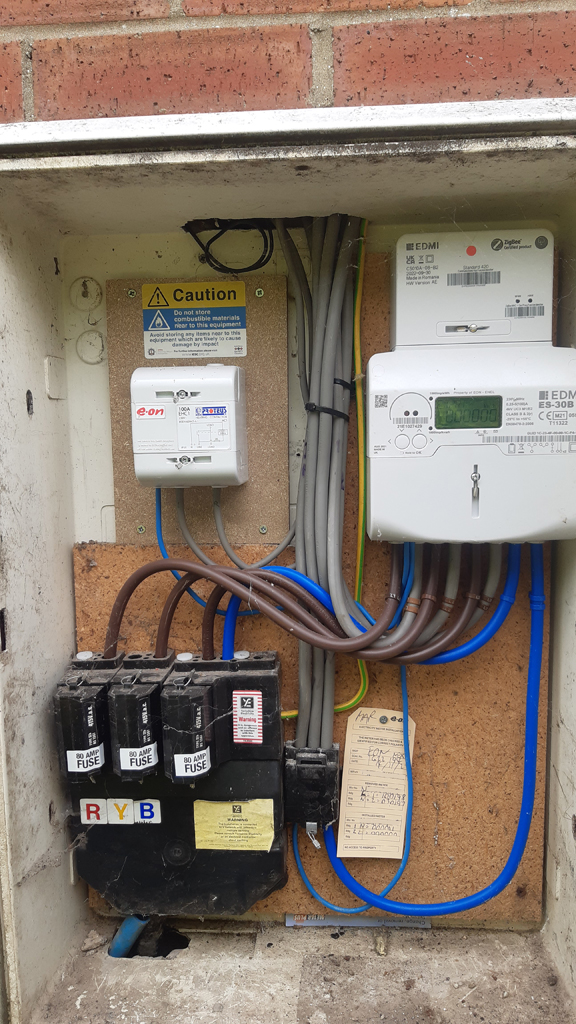

Hallo, I've moved into a house that used to have storage heaters but is now on an oil boiler for heating. All the storage heaters have now been removed and there are just a lot of blank fronted electrical boxes where they used to be. I got told that it is a three phase wiring and it doesn't need to be now so I can get it all updated. So I know who to ring can anyone explain what bits can be done by which engineers ?
Do i need to call the electricity company the electricity supplier or a local electrician to remove it all ? I'm hoping that one person can do everything including removing all four fuseboxes inside the house to save having lots of different engineers around.
A photo of the box outside. Thankyou
Not sure if you would want to get rid of the three phase, handy for EV charging etc. But however you do it, you will need an electrician to advise on what needs doing, not sure if there is a charge for having three phase? But I know where I work the cost of removal = standing charge for 10 years, so it was decided to leave it for future use.

.... I got told that it is a three phase wiring and it doesn't need to be now so I can get it all updated. So I know who to ring can anyone explain what bits can be done by which engineers ?
I'm sure that you do not "need" a 3-phase supply at the moment, but there's no harm, in having it, and with most (all?) suppliers it doesn't make any difference to what you pay (if you look on-line, you can get 'quotes' for electricity supply tariffs without being asked whether it is a single-phase or 3-phase installation).
As everything gradually changes from other fuels to electricity (electric vehicles, heat pumps etc.) it's not impossible that you might need (or, at least, benefit by having) a 3-phase supply in the future -so if I were in your position I would keep the 3-phase supply. If you reverted to a single-phase supply now, and then wanted/need to have it upgraded to 3-phase at some point in the future that upgrading probably would cost yopu a significant amount.
For what it's worth, I'm in essentially the same position. When I moved to my present home, a few decades ago, I inherited a 3-phase supply. I have never 'needed' it to be 3-phase, but there's no way I would even consider having it changed to single-phase.

That presumably means that only one of the 3 phases is currently being used. There's no reason why you couldn't have all the currently unused consumer units (and associated bit) removed, but still retain the 3-phase supply.
... but my neighbour said something about having to get a new meter fitted as well because the one that is in the meter box outside is not the right one.
It is presumably a 3-phase meter, but will still work fine (and register the right usage - they only know about the total across all 3-phases, even if two of them have 'zero' usage) if you are only using one of the three phases. Indeed, neither the DNO nor your supplier need to even know that you are only using one of the phases - but, as I've said, I believe that it would be sensible to retain all three, just in case you need them in the future.
That is why I would like to know who I should be getting in to do the work. He said the only people who are allowed to touch anything inside the meter box are the electricity company. Is that correct ?
Any electrician could remove the 'unused bits', but the DNO or supplier might have to deactivate the installation (by removing the service fuses) whilst the electrician does that.

I was surprised to see so many pieces of equipment in the meter box outside as in my old house there was just a meter a big fuse and a very big red switch that i could turn the whole supply off into the house with. There is not one of those in this house so how would the electrician turn everything off when he does the work ? Woudl he have to fit one of those type of switches on every phase of the wires in the box to make it safer ?

Is that all in an outside meter box? It shouldn't be!
... a very big red switch that i could turn the whole supply off into the house with. There is not one of those in this house so how would the electrician turn everything off when he does the work ? ...
The (one an d only) reason the electrician may need to involve DNO/supplier is to 'turn everything off' whilst she/he did the initial parts opf the work

One last thing. How come there are four different coloured wires in the meter box ? I thought the colours where blue brown and a green yellow like my old house but this one has a lot of grey ones as well. Is this because it is three phase ?
