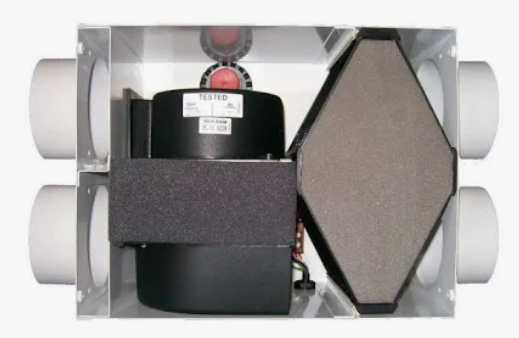

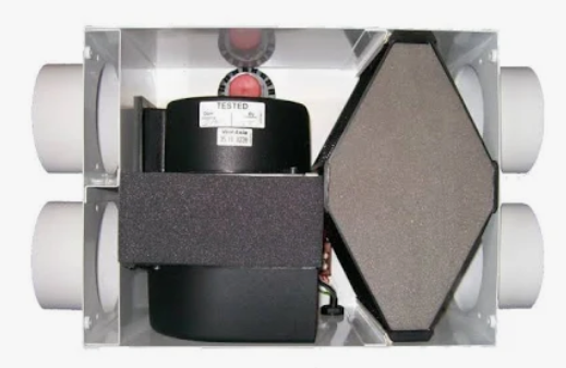

I have looked at fans myself, 1711445285332.pngthere are some very good ones on the market, but do I want to spend over £300 on a fan, or heat recovery unit?

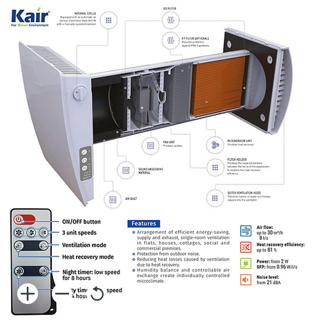

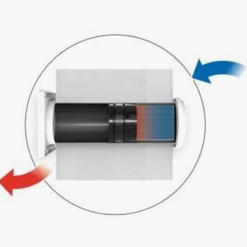

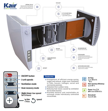

For a unit turned on when cooking or showering I can see using a cheap fan, but one which is continuous we are moving into a completely different product 1711445596925.png and for the all in one units to work, one is looking at how well sealed the room is, this type 1711445736799.pngtends to force air in both directions so it does not really matter how well sealed the room is, but the type where the heat exchanger is built into the pipe through the wall tend to only force air in one direction, and rely on room being reasonably sealed to cause air to go in the other direction. They all seem to cost between £300 and £400 and to be frank I would not want to spend that sort of money.
