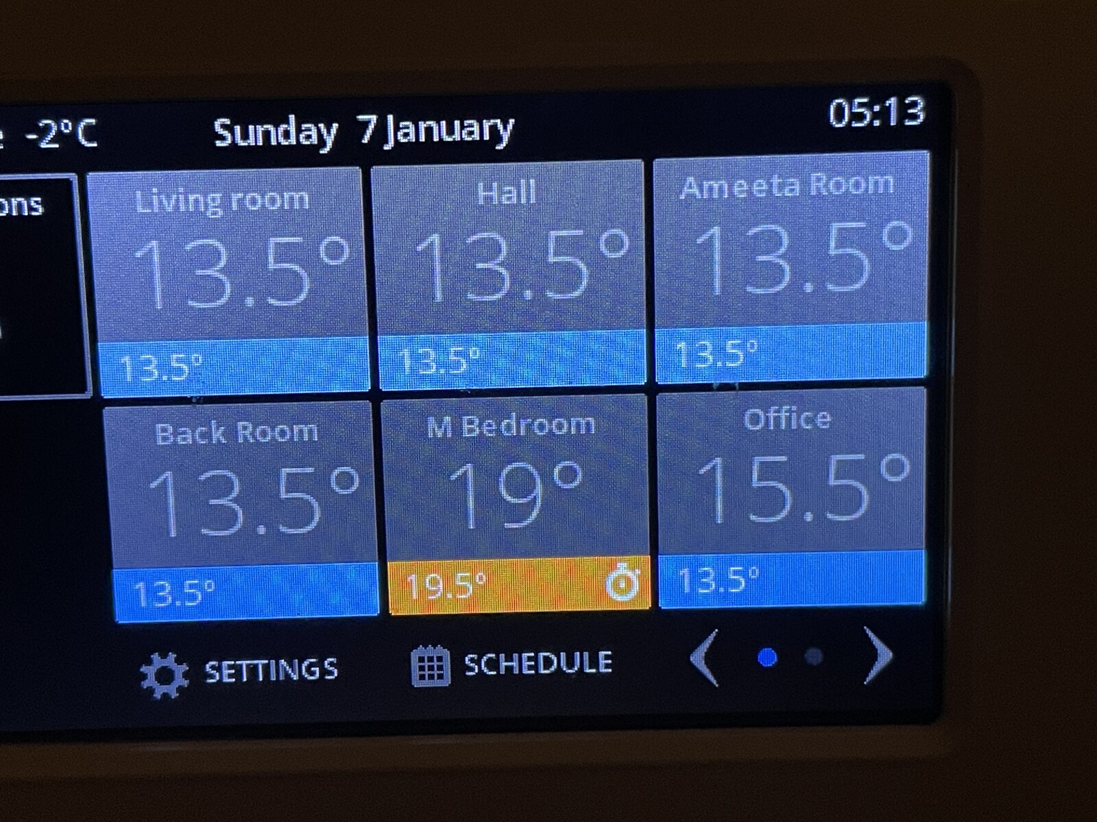

Bedroom radiator will be sized to heat the room to 16 degrees, bathroom to 25
Two zones mean one zone is off until you go to bed when other will go off ideally
TRVs- very rarely these are set to a lower setting so pointless having them.
Above is what I have. 6 zones.

@DP – Radiator sizes. I was under the impression that the bigger the size, the faster a room heats up? TRV set point – good point, I will have to have a look at mine. I might have to up the thermostat to get them to do something! Your zones look very granular, are they smart trvs?
