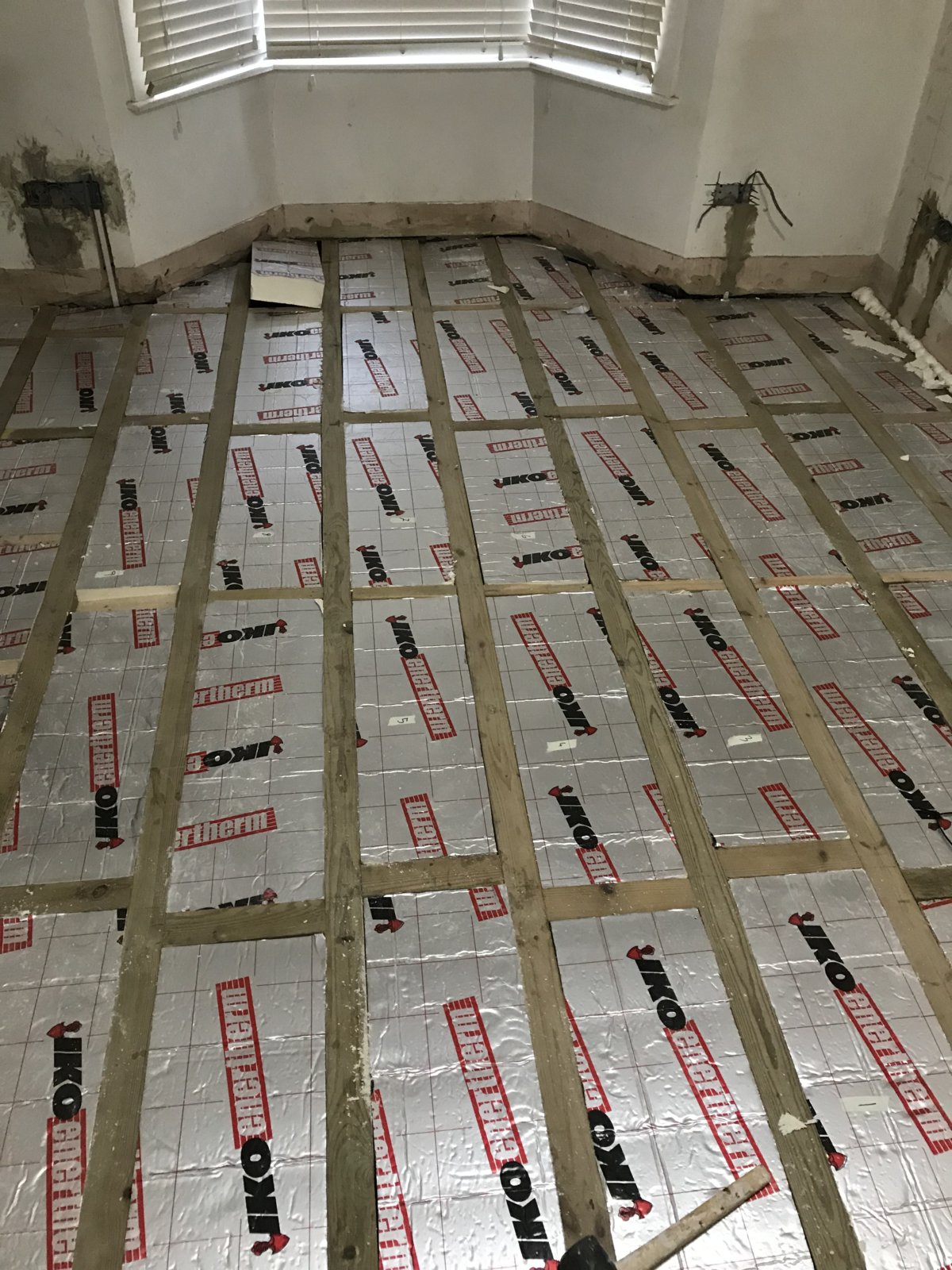

In hindsight, I would have made many changes to how I laid my new ground floor joists, but I installed 75x100 joists with 1.5m clear spans at 350 centres. Noggings every 2ft or so. I'm using cement overlay UFH boards which are 18mm think screwed to the subfloor. Another 6mm ply on top screwed into the overlay boards, with either engineered or vinyl as the finished floor. I could use 22mm subfloor but I'm concerned I'm losing too much room height with an already very low ceiling. 2.2m in the kitchen with an even lower arch into the conservatory.

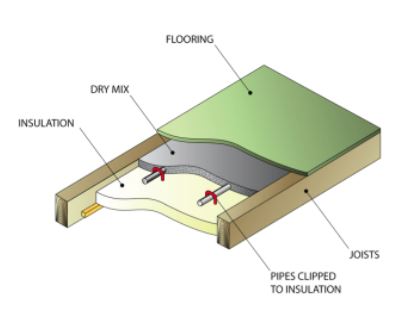

I regret not remove 1 course of brick on my dwarf walls and using large joists with a pipe in screed system (much cheaper to buy and install UFH). But I can't do much about that now.
Is 18mm ply at 350 centres adequate? Is the WBP plywood what I should be buying?

On 350mm centres I think plywood makes better sense than chipboard - just remember that you still need to support the end joints in the plywood sub-floor so you will need a circular saw, a straight edge (although a 6ft level would do) and a couple of clamps to make the sizing cuts. Standard 18mm WBP plywood should be OK but I'd screw to the joists on something like 200mm screw centres. The plywood need only to be construction grade (i.e. it can have surface defects, knots, repairs, etc as it'll never be seen) - ask your timber merchant for the best deal, which is probably going to be a Chinese sourced plywood, or even look for salvaged boards (generally new boards with a defect such as oil staining or over-orders from construction job. You didn't mention the 18mm cement board earlier; I'd recommend screwing that through into the joists 65/70mm screws) and I'd also screw to the plywood on 200 to 300mm centres (40mm screws) which make for a more rigid sub floor. Be careful to set-out the cement boards so that the joints are all staggered from the plywood joints (if needs be make a few cuts to accommodate this) and lay the boards at right angles to the plywood. Wear a good quality mask when cutting cement board (outside!) as it is terribly dusty stuff to work with (and use a cheap blade as it wrecks TCT saw blades or better still a PCD blade designed for the task).

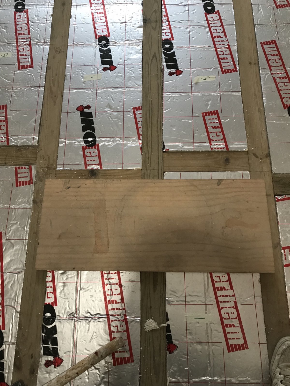

I've noticed a problem. My noggings are staggered with insulation filled to the top of the joists so I can't installed supports for the joints... any solution to this?

Sorry I don’t think my reply was clear. Subfloor ends will be supported at a joist, however there won’t be support for the ends which go against the joists.
Looking at the photo attached, imagine the sheer is a full sheet of ply. It is supported at joist ends but it won’t full on every nogging. Is this okay?
Yes. The important thing is to support the ends. If you use a T&G product such as P5 chipboard you'll get additional support along the long edges.

Hi @JobAndKnock, thanks for your reply regarding OSB3.
Could you check my images in my previous post and let me know what you think?
You only need the ends of your boards supported on a joist.
So on an 8ft x 4ft sheet, the 8ft side that runs perpendicular to your joists does not need supporting with noggins.
