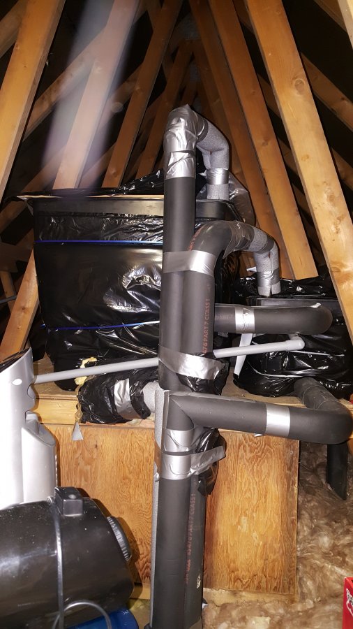

I have a new property which has 2 huge eater tanks in the loft - each approx 8ft wide by 4ft deep. I've never seen 2 big tanks, only 1 big and 1 small.
I'd like to free up some space, is there any reason to have 2? Possibly water pressure related? (we are on a gravity system)

I went up to take a pic - I totally overestimated the size :oops: they are 60x60x130cm - so by my calculations hold about 0.5 Tons of water each...
If both tanks were full to the brim then your weight calculations would be correct - they won't be anywhere near full.
They sound like coffin tanks and are not unusual - restricted access to the loft being the usual reason for installation.
It's worth checking that (assuming they are inter-connected) that the connections allow both tanks to circulate their contents properly.

Both tanks are full up to about 6 inches from the top. The tank at the back (you can't see it in this photo) has a water feed going in (assume from the mains) and this has a hole & pipe at the top that fills the next tank. There is also a third smaller tank up there too (assume an overflow tank). All of this is on various planks of wood - adding to the weight.
It's not above any wall either - I have read heavy tanks are usually placed above a supporting wall...
That said - I have been here 2 years and the previous occupants were here 15 so I assume it's legit!
