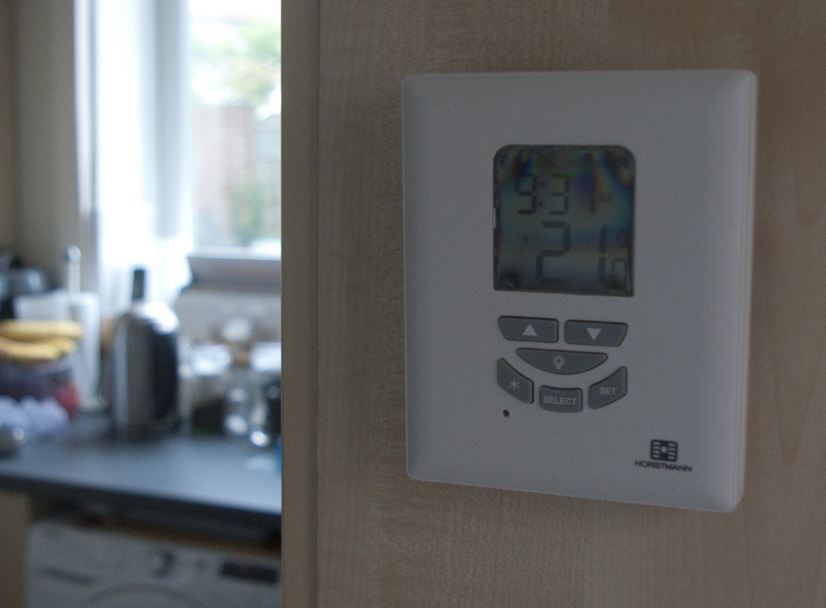

Hi,
I have a W Bosch combi boiler and have noticed that in the middle of the night the radiators all over the house get piping hot. This is despite the wireless thermostat not activating the heating. I left it for an hour last night thinking the radiators May simply start to cool down. They did briefly but then started getting hot again.
I then went down to the boiler which wasn’t even showing as being on, I.e the red light was not on which it normally is when the heating is on. Ended up having to manually shut the boiler off.
This was happening earlier in the year and as it’s still under warranty a WB engineer came out to have a look. He said he couldn’t find anything wrong with it but had changed one of the valves. It worked normally for a bit but then same thing started to happen again.
I am going to contact WB again but it would be useful to know if anyone has experienced anything like this and what the fault is likely to be? Thanks.

Salus badge is found on many thermostat this
one is also badged as Horstmann see previous post and it has issues losing wireless contact with base station. Also Worcester Bosch are know for problems producing RF noise, the receiver needs to be some distance from the boiler, think it's the boiler fan which causes the problem.

So what thermostat have you got? Is it programmable, is it hard wired or wireless, have you read the instructions, if so does it fail safe?

I have now uploaded pics of the thermostat and the Salus control unit on the boiler. I would have thought if the batteries were low it would start to lose contact but there is no low battery symbol. I then thought maybe it was because I had it too far from the boiler so last night I left the thermostat right next to the boiler. However the same thing happened again and the boiler randomly turned on the heating at night.
Not really sure what to do to be honest. I appreciate your post and advice given but I don’t think I am technically enough minded to find a fix myself in all honesty. That leaves me either calling someone to try and fix the fault or changing to WB controls which you have noted may cause other problems. I will see if it has a fail safe.
Reading the manual it seems it does have a fail safe for battery going low, but does not say anything about RF interference, it also it seems has both on/off and pulse width modulated mode, and reading the instructions I would agree with

The unit connects into the boilers electronics so it's impossible for anyone other than Bosch or Salus to know what it's doing.
