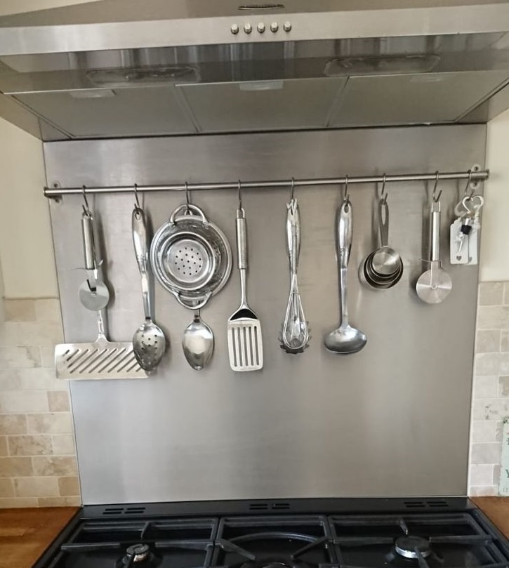

I've been left with a bit of a mess by an electrician. He came in & put a hole in my brick work (which I've now fixed) and didn't chase the twin and earth into the wall. I thankfully didn't pay him a penny & he's never asked for it (I think he knows he ****ed up) but he also isn't willing to come back & fix it.
My next job is to chase the twin and earth into the wall, the only issue is the twin & earth is connecting to something to the bottom left of the plug socket it's coming off. Meaning I was planning on just running it diagonally downwards but I've read twin & earth can only run horizontally & vertically. Why is this?

I like the surface clip idea but the only issue is it's going behind a splashback, so I could just recess it in a bit hide it behind the splashback (as no one will be drilling into that) and I won't plaster over them.
The cable has RCD protection & it goes to just a fused spur with a 3amp fuse as it's for a boiler.
Surface mount is no longer surface mount if you cover it with splashback.
Concealing cables outside of safe zones is a foolish thing to do.
no one will drill into the splashback.
No one - except when they do to install a utensil rack and damage cables where they shouldn't be
which is the very thing which resulted in someone being killed

Hmm, that's fair enough. Maybe the right thing to do is get this electrician back as I can't see how else I'll tackle this as he's put it in a really awkward position where it can't go vertically or horizontally (and I'm not too skilled with electrics if it wasn't already obvious)
Surely it could be argued that running a vertical cable within the width of that rack IS in a safe zone, as it has a very large electrical unit above it.
Appliances and current using equipment do not form cable zones. Only the point, accessory or switchgear.

Any zone would only be that formed by the FCU, socket outlet or other connection point, not the entire extractor assembly.
So, to keep it simple, where can you bury the wall a supply cable for the cooker hood if you aren't using an accessory such as an FCU?
I would imagine where you want the cable to emerge from the wall would have to form the cable zone, and that a junction box would be fitted - that is of course even if the unit does have a pre-fitted flex.
I would also imagine folk would have to dismantle things to determine where the cable may or may not run - something which many, many people would not do.
There will be other units, not necessarily cooker hoods, where the cable entry is nowhere near the wiring termination.
My thoughts (without making stuff up) are that the entire width and height of the unit should, or could, form a wiring zone, to deter people drilling there - only no one would be aware of such a rule even if it did exist.
