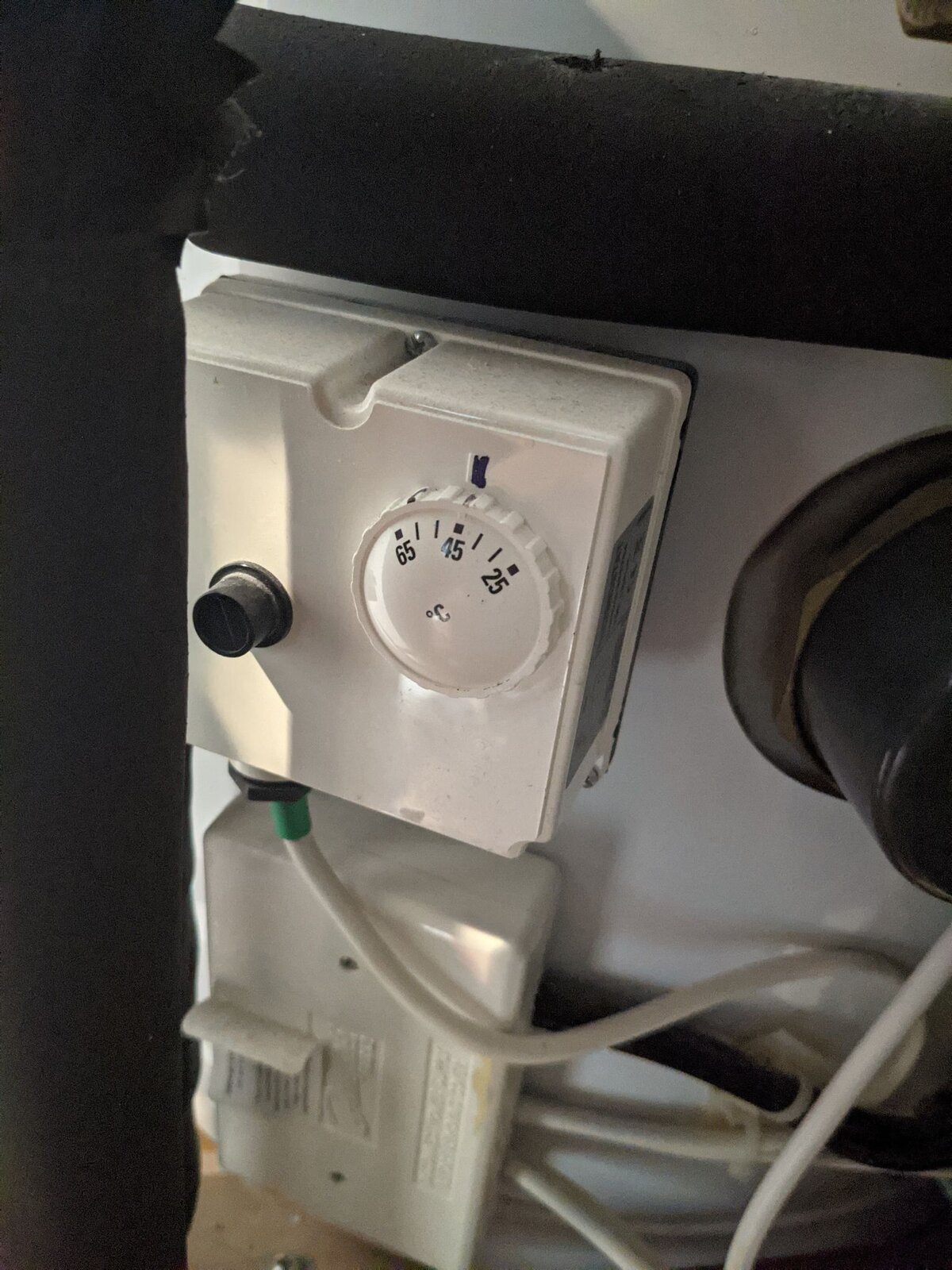

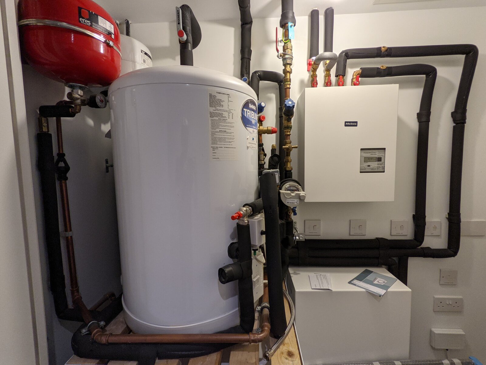

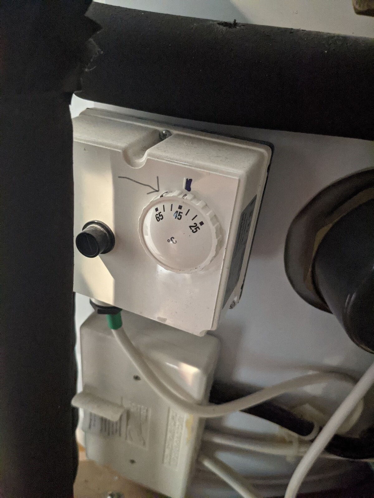

That is your HW thermostat that controls the HW temp in the cylinder, what actually heats everything ? do you have a gas or oil boiler, or is that cactually a thermal store , post a full pic of that cylinder
It's on a water cylinder from Kingspan, which I believe heats both hot water and underfloor heating in the apartment. There's no other boiler and no gas in the apartment.
That is why I asked post a full size pic of what you have, you dont have what you posted a link for

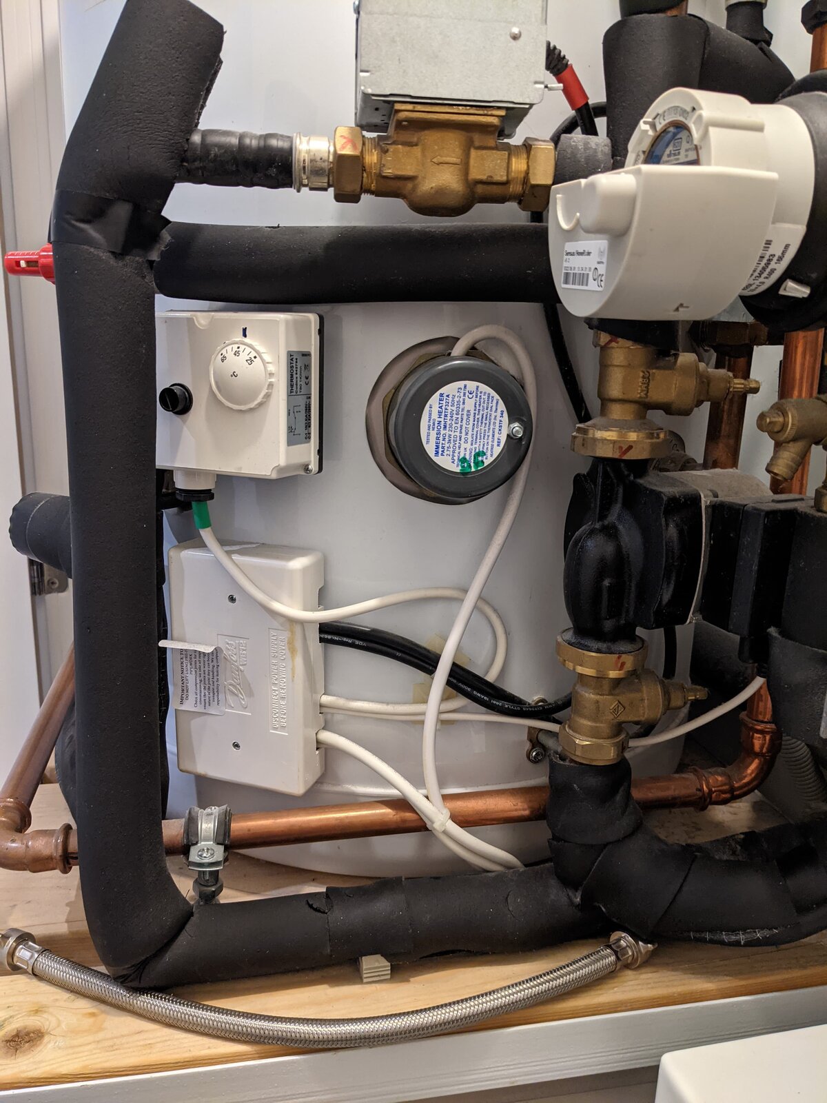

Apologies, was a bit hard to get the angle in a photo, but I managed to do it:
You have a direct cylinder/thermal store.
Can you explain the difference? I thought it's indirect because it also receives heat from an external source (there's hot water in the building).
Not often I disagree with @dilalio but in my humble opinion you have an indirect hot water cylinder and you are supplied on a district heating system, hence the energy meters and the two expansion vessels, this doesnt make any difference to how your thermostats get wired , but the immersion heater that you thought heats things up is simply an emergency backup, for each thermostat there will be an individual zone valve, so for each one you will need a single channel hive and receiver, so will start to get expensive, you can change all or some zones with hive units, dont see any point in changing the bathroom one for example
And you need to turn that thermostat up to that mark that someone has made, it has to be at that setting to prevent the formation of legionella
Well, this was potentially life-saving information that I never would've thought to ask. Thanks!
Is there a reason this isn't simply always set to a high temperature then? I find it odd it's even possible to have it lower than the temperature needed to kill legionella!
