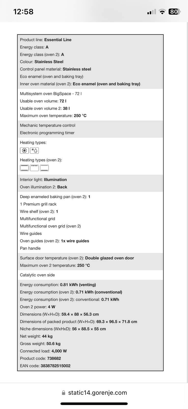

Product fische isn’t the greatest but I’m reading it as a 4kW max load. Top oven seems to be 4Watts……
Also this:
Still not clear but it does say total power 4,000W.
(A 4W oven wouldn't be much use. It does then state 4,000W below that)

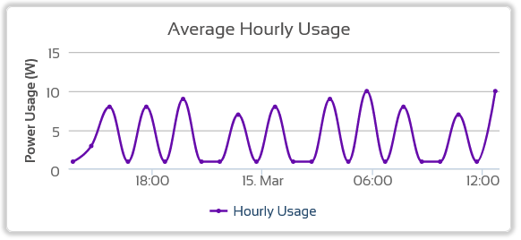

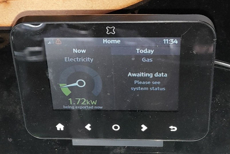

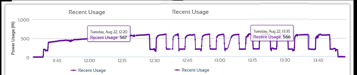

So we measure what some device uses. This Tuesday 1 all small load.jpg is the result of measuring what my tumble drier uses, the energy is the area under the graph, power is the graph, and it is near impossible with my maths to convert that graph into energy. The fact it switches the heat pump on/off at latter part of cycle, means only way is to have a device which measures energy direct, same with fridge 1710510023420.png that does not help, and this 1710510131193.png is the bit we need from the energy meter software, showing what the fridge has used until 13:40 today. This means it is even harder to work out cost, not helped with a in house smart meter display showing 1.72kW export on IHM.jpg if one looks very careful it says 1.76 kW export, but such a small increment on the scale one needs to pick it up to read the values.
If one tries to measure what a non heat pump tumble drier uses, or an immersion heater (unless using an iboost+) it is easy to work out energy used, as straight line graph, but a hob, oven ect, it turning on/off all the time once it has reached the temp set.

I would guess the 4 W is the fan, not the heating element.
Oven 2 is conventional so no fan, it’ll be a typo.
I could pull it apart and find out but my suspicion is it’s got 6x1kW elements for hi/lo grill, top and bottom ovens.
Where did I put my screwdrivers……
Actually got 3 according to the spares list.
1800W Fan & 900/1300W conventional.
Who knew….
It doesn't matter for your query of adding a socket.
The specifications do not really make sense.
In the link I found it says oven 2 is the small one yet that is the one for which all the figures are given and which has the fan; nothing is shown for oven one.
