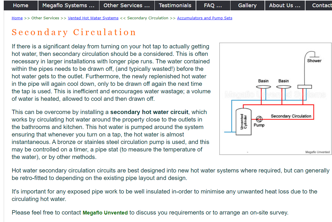

I've just moved into a new (to me) house. The CH and hot water setup obviously have a few issues that I was postponing diagnosing until the autumn, but the hot water programmer is now failing to call for heat, so I need to get to the bottom of what's going on sooner rather than later. The house is about 20 years old.
Prior to the failure, we only really had HOT hot water downstairs, and upstairs only if either (a) a particular tap in the main bathroom was turned on first, or (b) if the programmer under the boiler was currently calling for heat.
Today, spurred on by the failure (which I assume is likely to be a failed tank thermostat or zone valve since the boiler successfully fires up when the CH is turned on) I had a good look in the airing cupboard for the first time, and was surprised to see a pump on the outlet of the Megaflo. Given the Megaflo is unvented, why would it be there and what would be its purpose?
I've added a photo elsewhere in the airing cupboard -- the pipework looks to me to be a bit over complicated. There are two zone valves and an additional pump there so assume this is a y-plan system.
Will eventually call a plumber to remediate but would like to do as much as possible to diagnose the problem first. Any recommendations for good fault finding plumbers in Suffolk gladly received.
