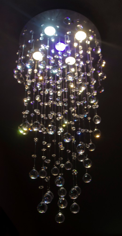

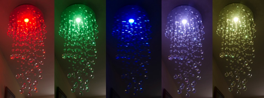

So when I wanted landing lights with high and low level output I used a duel relay DSC_6799.jpg I can select centre only, outers only, or all 5 so three levels of lighting, well actually a lot more, as centre bulb is colour changing, Centre_bulb_colours.jpg and dimmable, but there are some wall switches which are claimed to work with LED lights, but if you want ambiance, you also need to change colour temperature, even if not actual colour, so way to go is smart bulbs, however there are it seems some dimming switches which have less problems, but that does not change the colour temperature.
