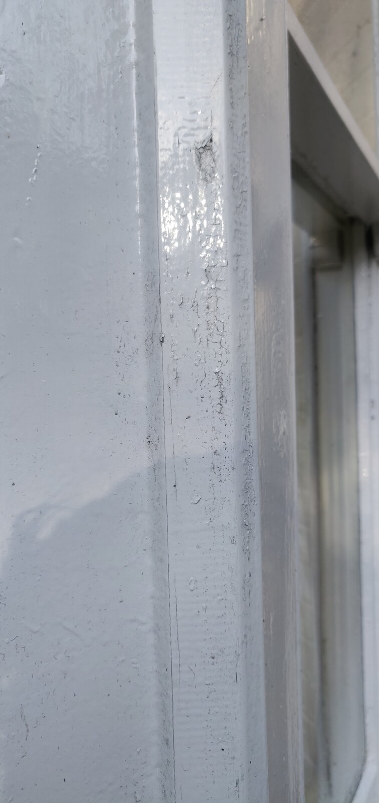

We have a lot of old, traditional wooden sash windows. It had been quite a few years to my knowledge since they were last painted, with a lot of cracking and even some bare wood patches on sills.
About this time last year I hired a painter to repaint them all, he came recommended and seemed like he knew what he was doing but already there are some quite bad looking parts, cracks and discoloured or rough looking bits.
Can anyone tell what's caused this from my photos and what I can do? It seems the problem areas are all on the parts that were in the worst condition previously.
A good paint job takes more time than labour. I am not convinced painters you hire would ever get enough time for a good job. Unless you are willing to pay a painter to sit there and wait for the paint to dry, the job will probably fail in the time period you observed.
The big crack in the first pic looks to be failed caulking. Try a non-shrinking wood filler instead. If there's movement there then silicone sealant would work.

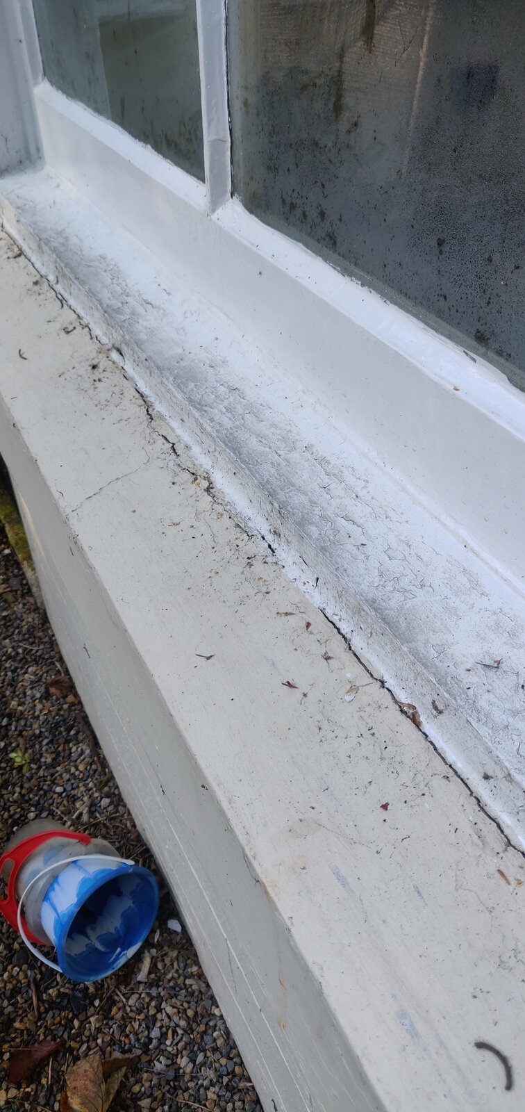

The second pic is probably to do with the sub-surface. Sand it back, clean it out, fill it in, prime it, and then overcoat it. You only need to repair the failed bits. Providing access is not a problem, painting is not hard to master or even hard work. In my painting DIY, I paint for 10 minutes and sit for 16 hours waiting for it to dry. I don't even need to clean the brushes. After painting, I put brush into jar with water or white spirit depending on paint type. When I need to paint again, the brush is ready to go. I use and reuse the same small plastic cup as a paint pot. I only put just enough paint in the cup for one cycle of painting. The leftover could stay in the cup to dry.
Regarding the crack, that was pre-existing not part of the job - but the sill has gone a funny colour and obviously looks weird. From memory this was one of the places where the bare wood was showing through. I wondered if he'd been lazy in the preparation department.

The dark patches on the ledge are likely caused by denatured wood (bare and grey looking), which may also have contained excess moisture when painted. This will cause the wood and colour to deteriorate further, while also allowing mould to grow below the paint surface. This makes the paint system fail and produces the cracking/crazing and discolouration you have.
It's vitally important to thoroughly clean and sand back denatured timber to a sound surface, or even replace it if necessary, in order to avoid the issue you have. Stopping further moisture ingress is also vital, so after sanding, repairing and priming, all joints should be caulked and then painted.

I was curious to see isolated cracks in paint that appears otherwise good... Perhaps movement of the underlying wood as there are different pieces and it's in direct sun?
Or maybe bad adhesion; though I didn't watch the painter work I'm suspicious that he didn't appear to do any prep other than washing the existing paint down.
I would say looking at the vertical bits he didn't do much sanding.
Is there shiny paint under the peeling areas?
Sanding seriously increases the life of paint, and avoids that annoying peeling which is so hard to rectify on the next re-paint.

Not sanding and providing a key is one of my many pet hates. A couple of years later, I turn up to paint woodwork. I start sanding and the paints just rips off the surface. It can result in increasing my prep time by up to 30%.
Looking at the pictures, I am not convinced that undercoat was used. I could be wrong though.

I'd recommend that you fill the sill crack with a MS polymer (eg CT1, sixaflex, etc). They are almost as flexible as silicone but they can be primed with waterbased paint and then coated with both waterbased and oil based paints. Silicone repels paint. If you have any exposed paints, coat them with an exterior primer and oil based undercoat and leave them until the spring (unless you are confident that you can finish them in a 2(?) week window).
Is that the sikaflex EBT? I have a tube but it doesn't seem to advertise as being paintable. Although it's white and so is my paintwork...
