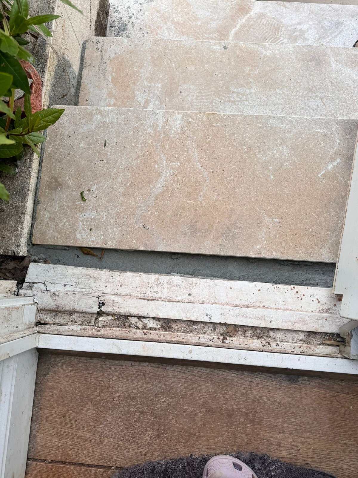

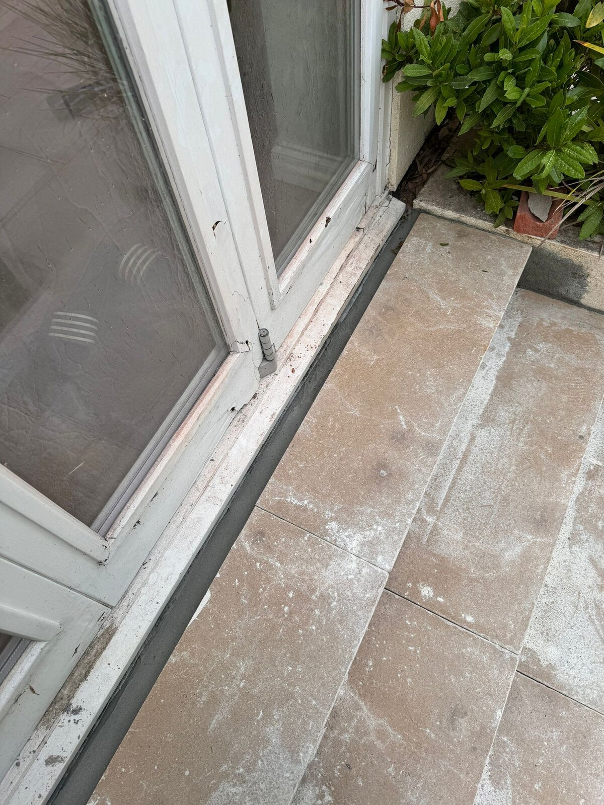

Hi all,
I have a landscaper currently installing my patio and I feel like he is bodging parts of the job, and I would like your opinions please! We have steps leading down from house to the patio, and the top step into the house has a gap of about 3 inches (See attached). Surely the slabs should be longer so they go underneath the sill from the door? Don't understand why there would be such a gap left there, if there is a logical reason please do let me know. I feel like it will just fill up with rain which would eventually damage the steps and leak into the house?
Thanks!

Hmm possibly, difficult to know now really. Though I would hazard they just screwed up the setting out of the steps, it looks like it could be infilled with some tile slips fairly easily. Speak to them.

I will be speaking with them in the morning, but just wanted some other opinions so I have some knowledge heading into what will likely be bit of an arguement. It seems they simply cut the slabs in half, which is why they are too short

He definitely should have gone under that sill. He can still keep away from bridging any damp course.
I would tell him that is not acceptable..

This is what I was thinking too, there's room to go under the sill and still not be bridged. Isn't the point of a sill to cover transitions like this and to prevent water from entering gaps?

Sorry yes please dont get all bent out of shape here. I know its not helpful when some smart arse comes on with stupid comments and I was a bit harsh but you say the landscaper knows about the doors being redone and the sill being replaced soon so perhaps he was leaving you room to do this without having to mess up everything he has done.
If the doors are being replaced later this month then if it were me I would of done the doors first then the patio as ther is not much difference in completion and it is done in a better order.
looking at your wooden sill now if you have a modern upvc or aluminian one for bifold then I think the sill will be wider than it is now and there will effectively be no gap seen like there is now.
But also there are DPC considerations that may need to be thought of too here.
