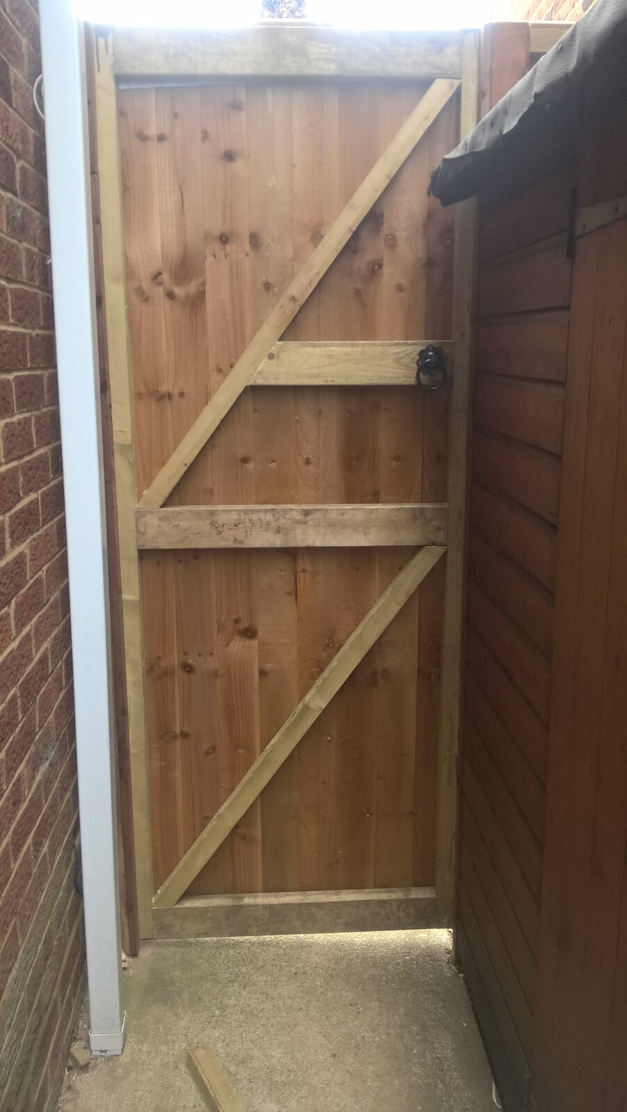

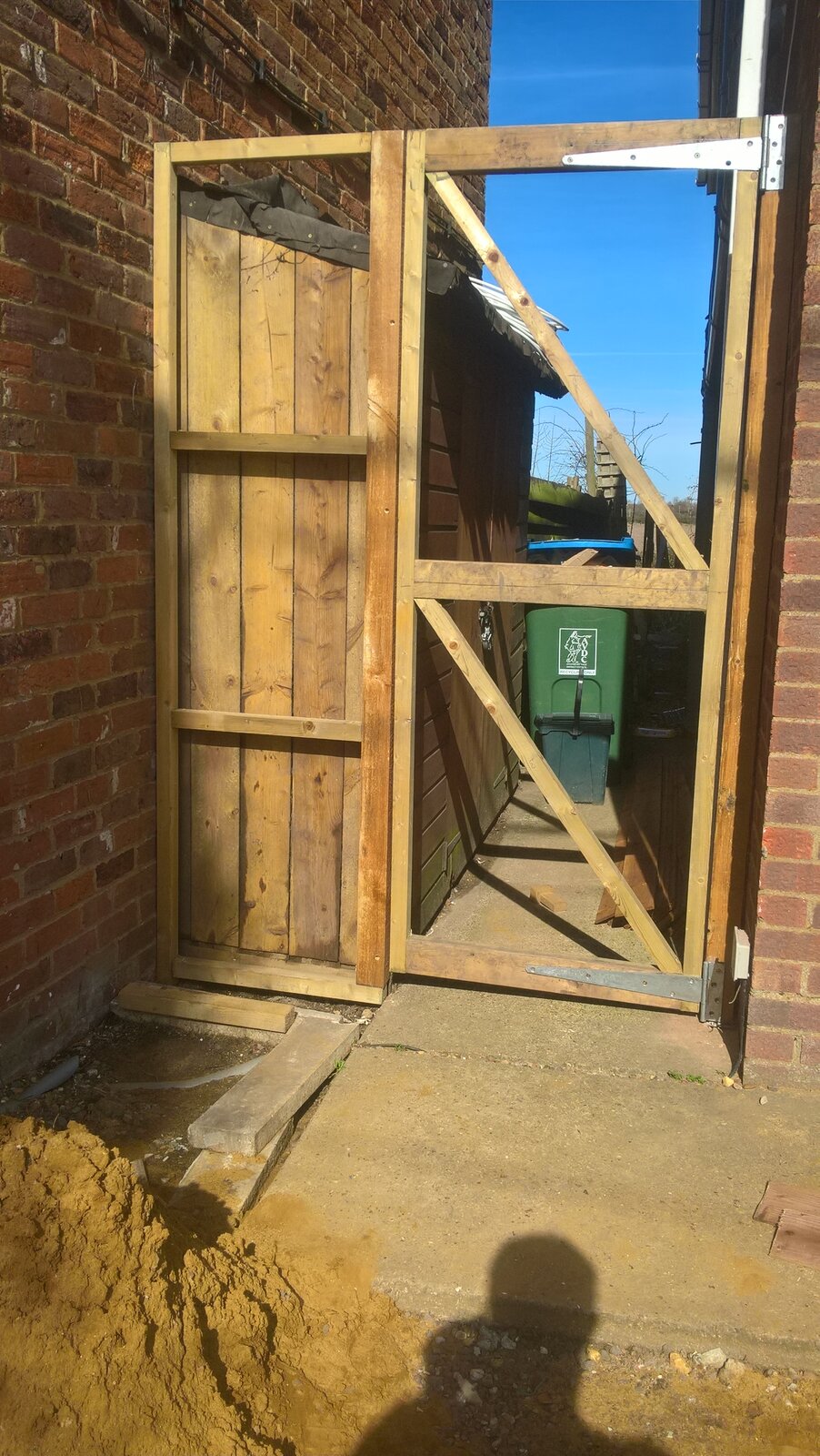

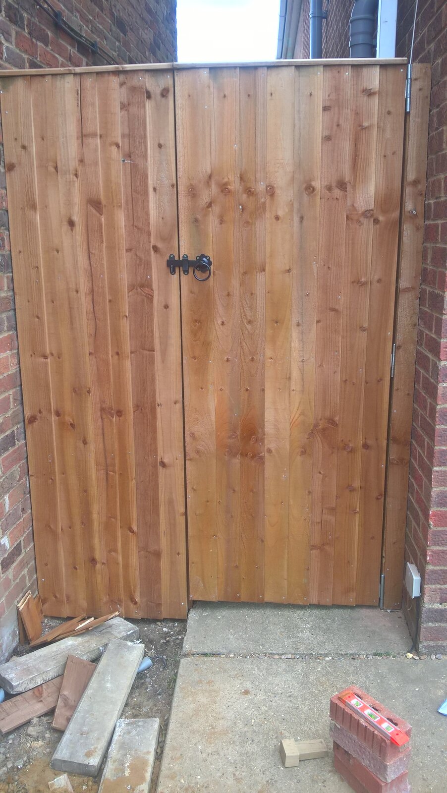

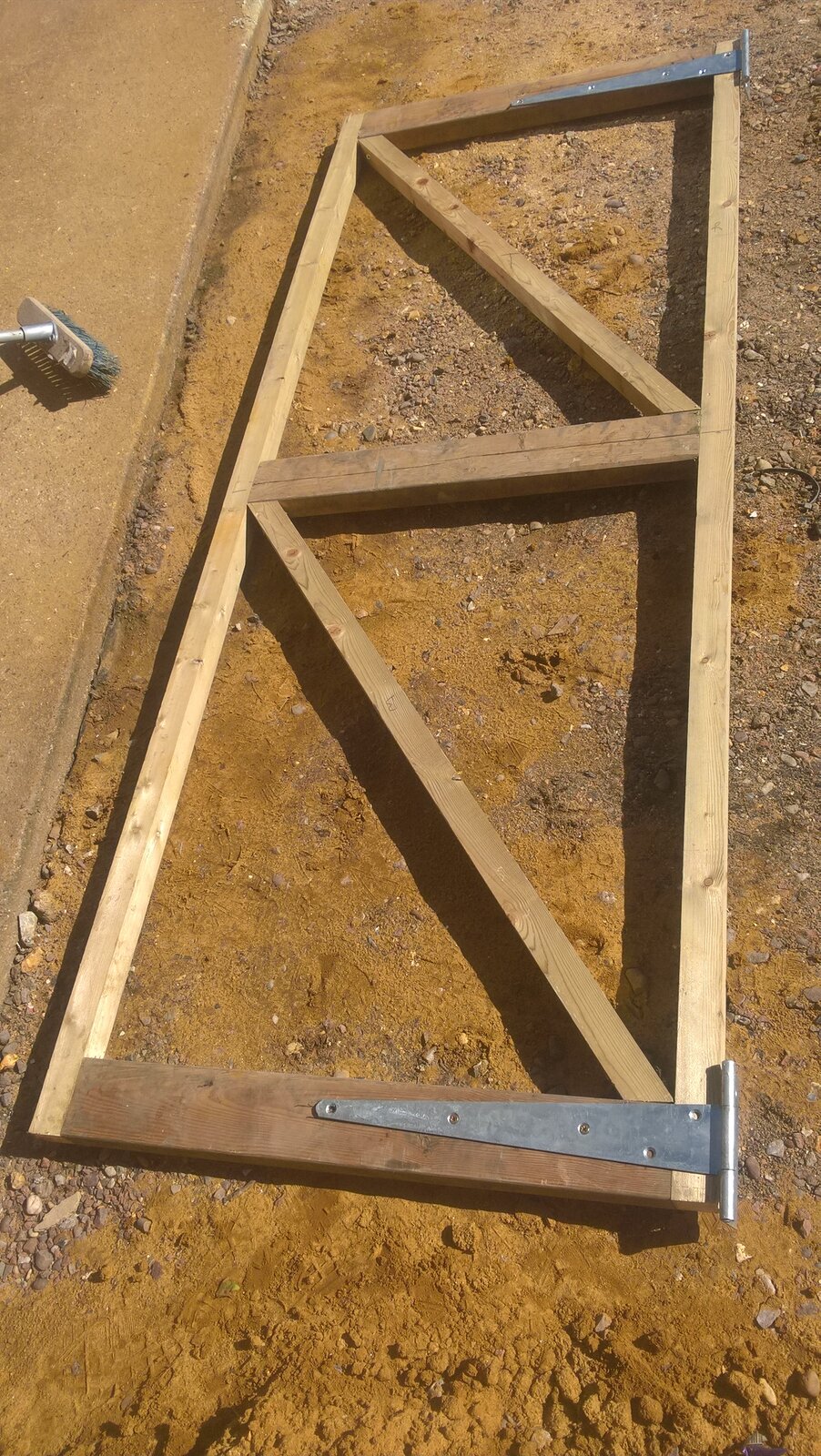

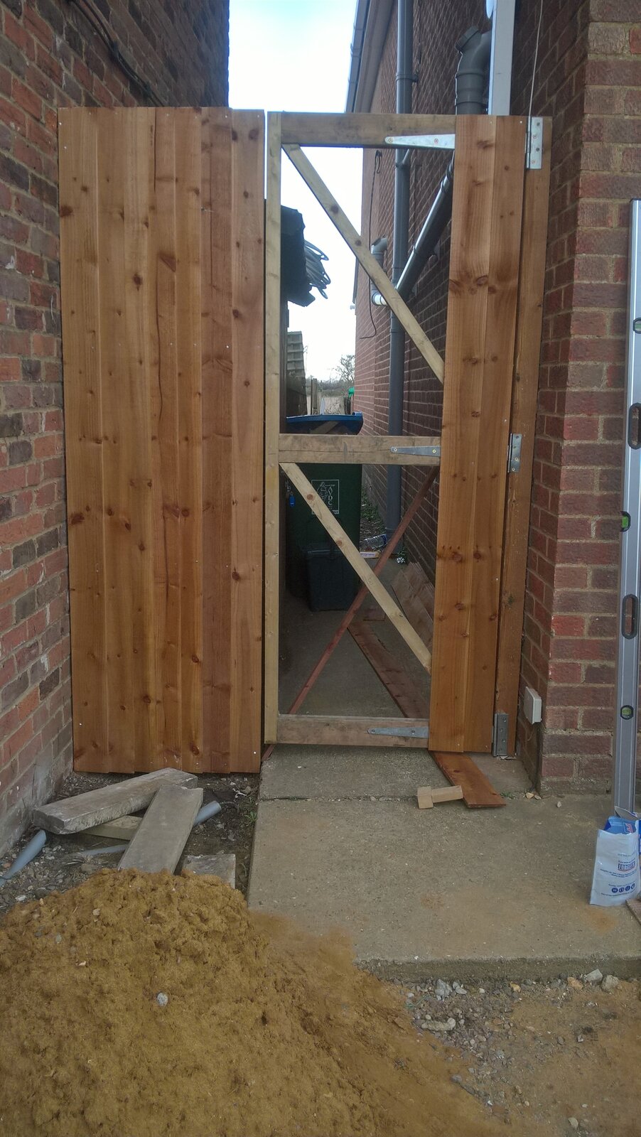

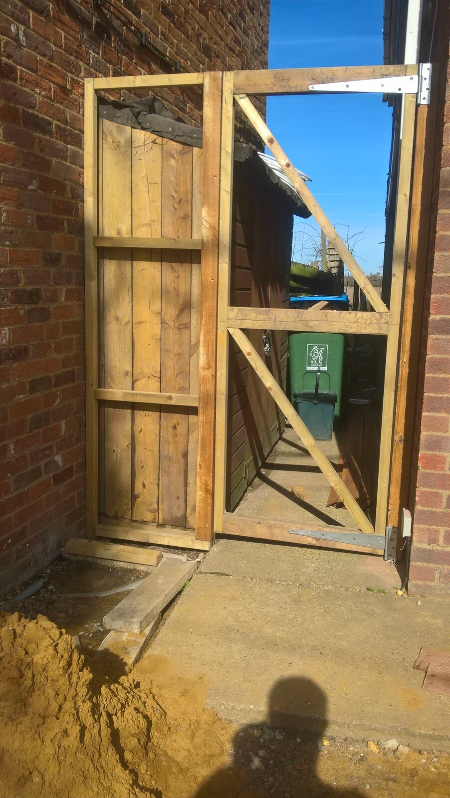

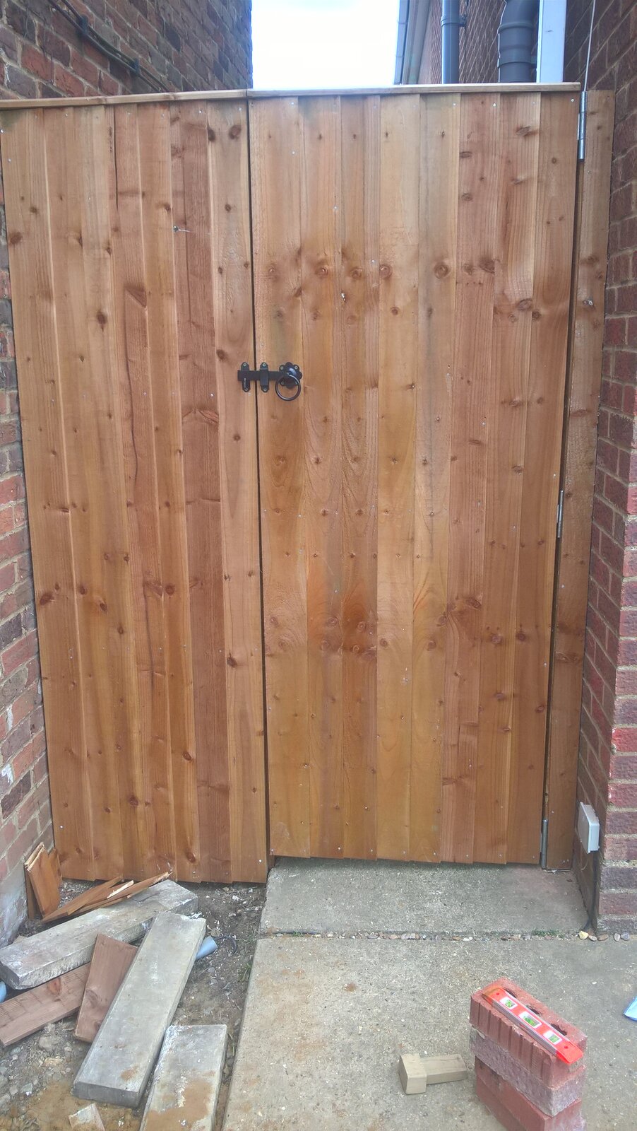

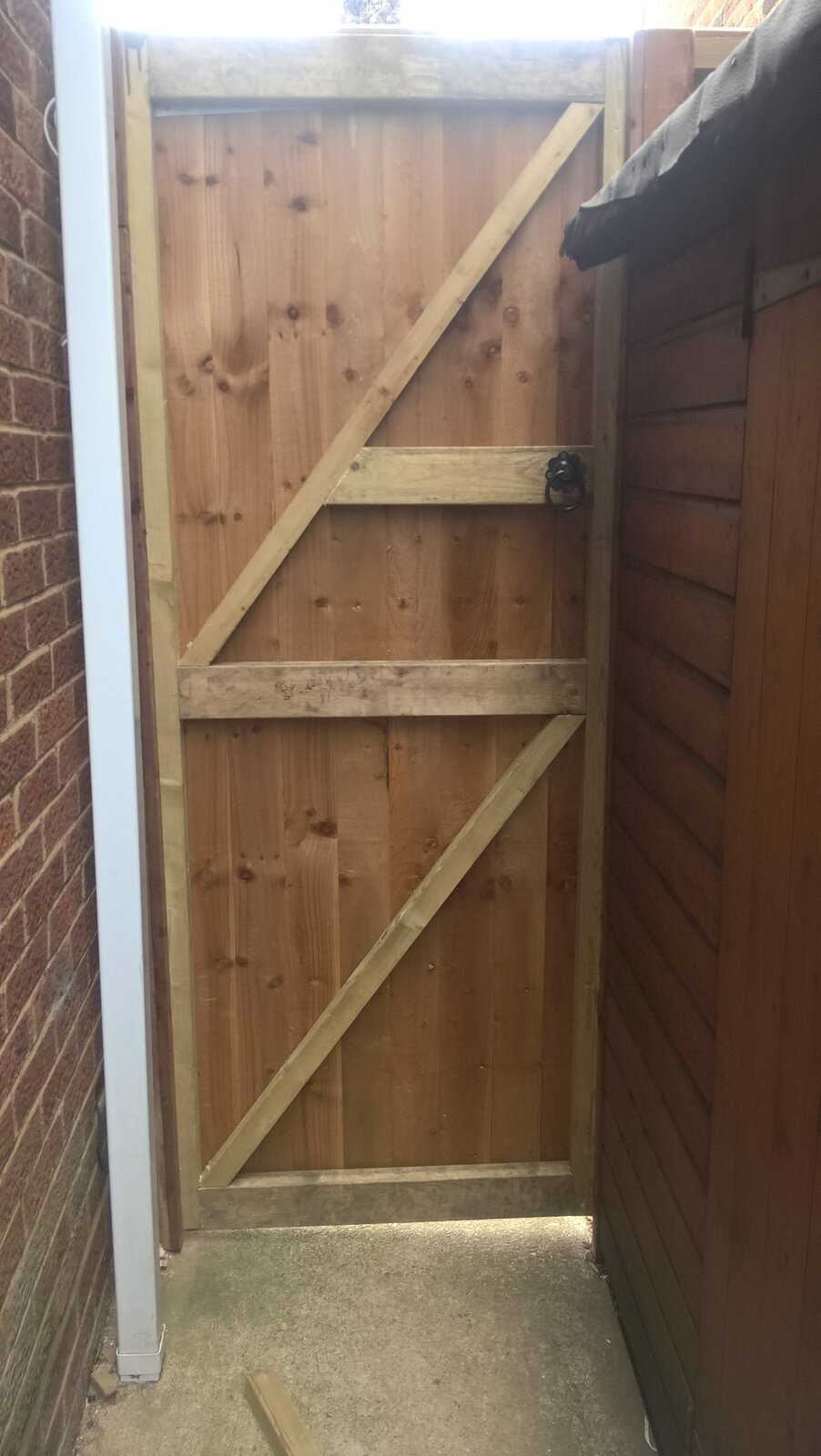

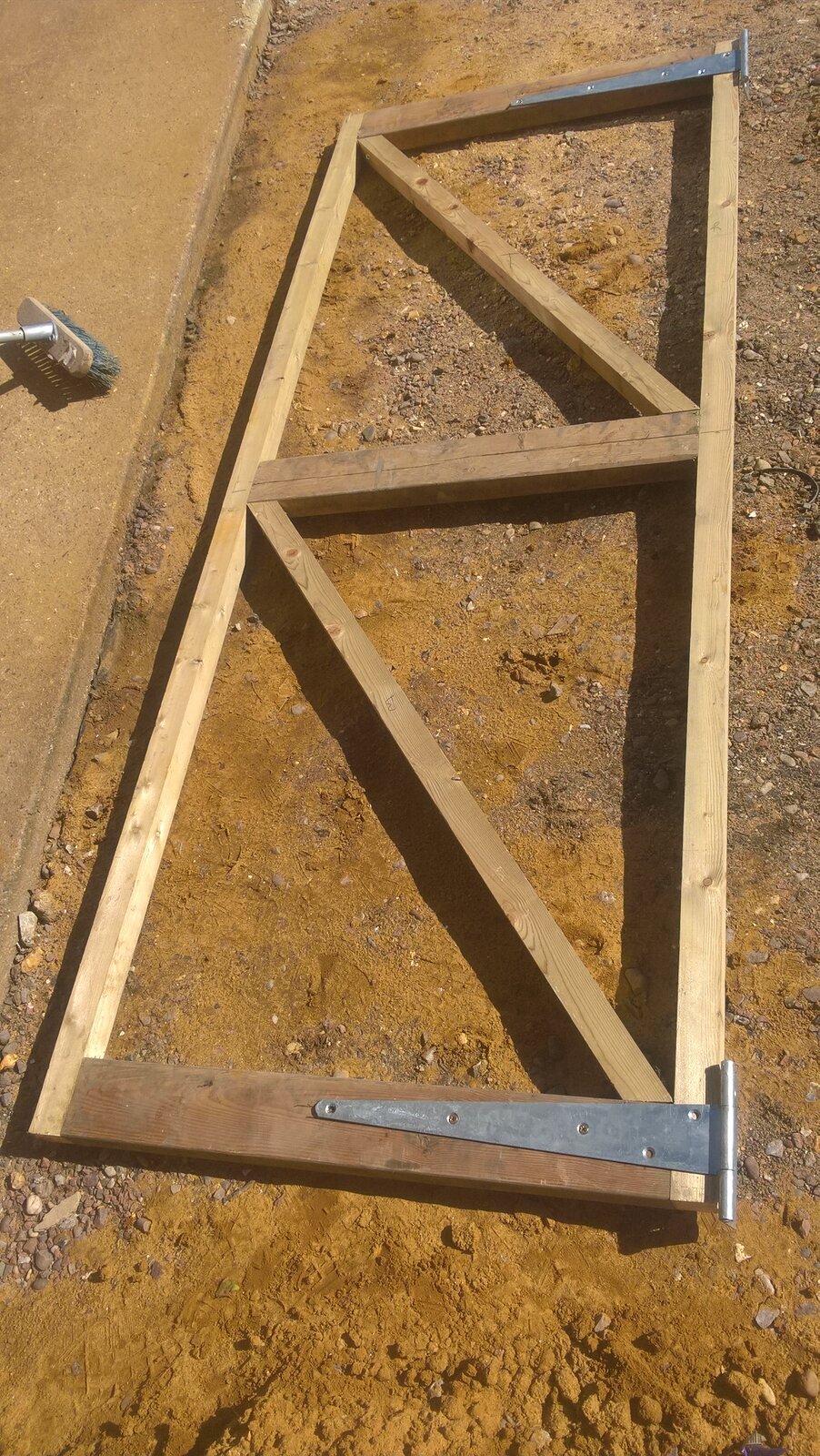

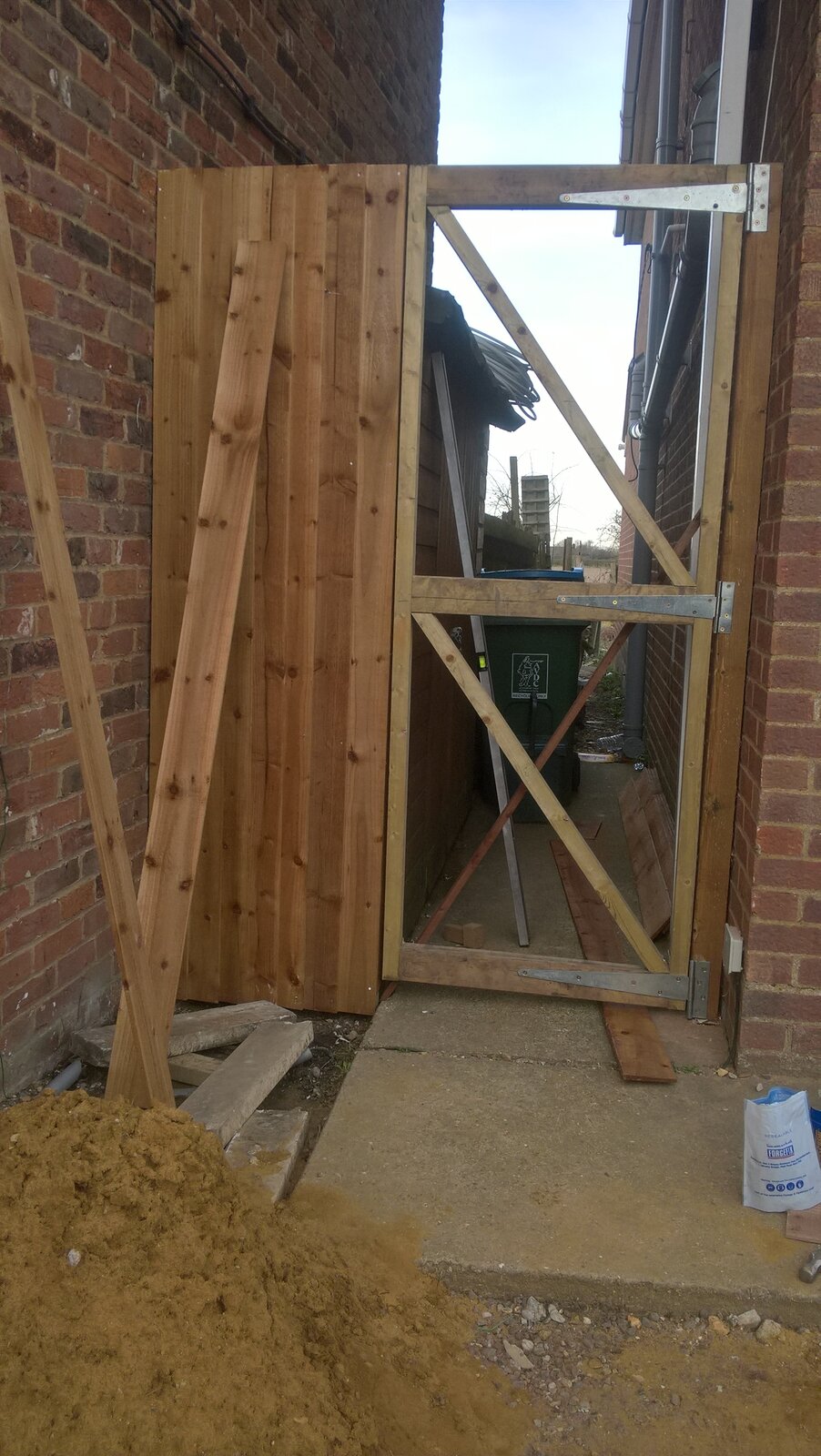

I built this a year ago and it has stood the test of time. I used 4x2x and 2x2s for this
I need a build another gate but much wider on this occasion: approximately 5ft x 5ft. Would the same approach work for this sized gate i.e. frame and braces in the same way and then nailed with featherboards?
Thanks in advance.

Don't see why not - but I'd use Match boarding for the face rather than Weather boarding (featherboards). You have the braces the right way round (low end on Hinge side).
Are there any issues with using 3x2 timbers for the horizontal parts of the frame? I thought I had 4x2s but they are actually 3x2s.
I will be using 2x2 for all the braces.
Can someone please provide some guidance with this as I was planning to build this gate tomorrow.
Thanks again
3x2 is probably on the borderline, I’d prefer 4x2, why not make the bracing one 3x2 as well.
To make the joints stronger it would be better mortice and tenoned. Is your old gate just screwed through at the joints?
just re-read the original post... if you are making this gate 5ft wide, you really need 4x2 and proper joints... otherwise I think it will sag quickly.

looking at your old gate, is it around 700mm wide?
Yes.

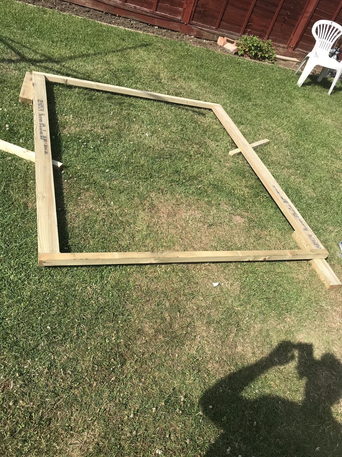

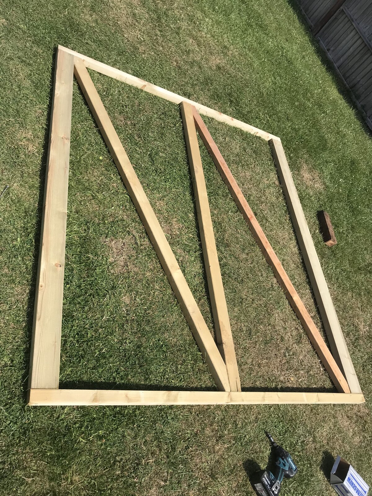

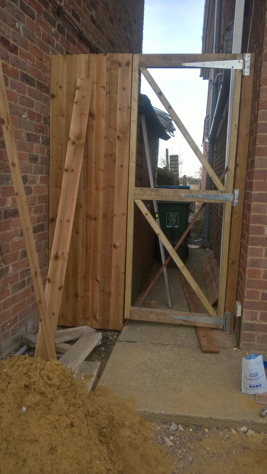

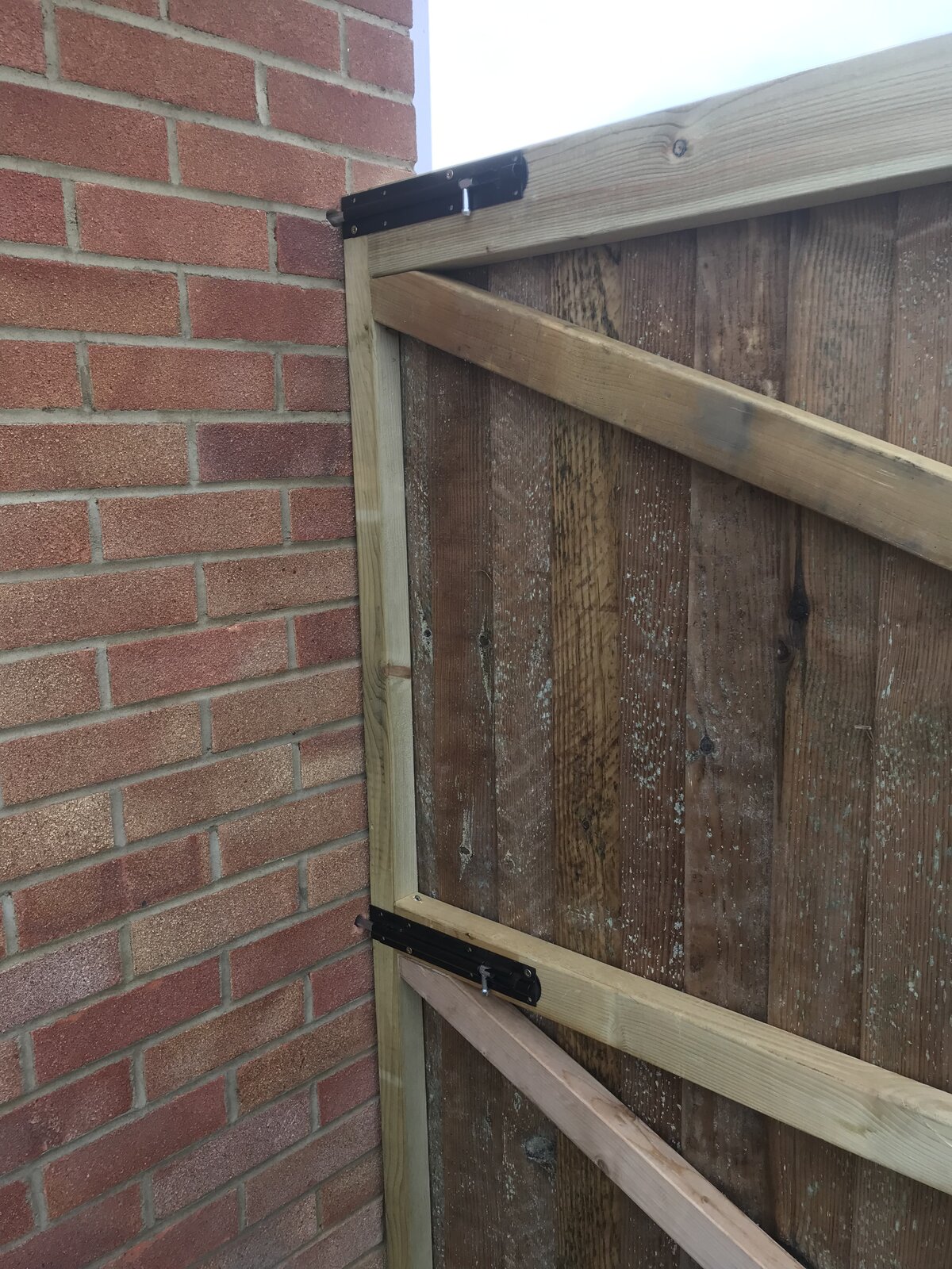

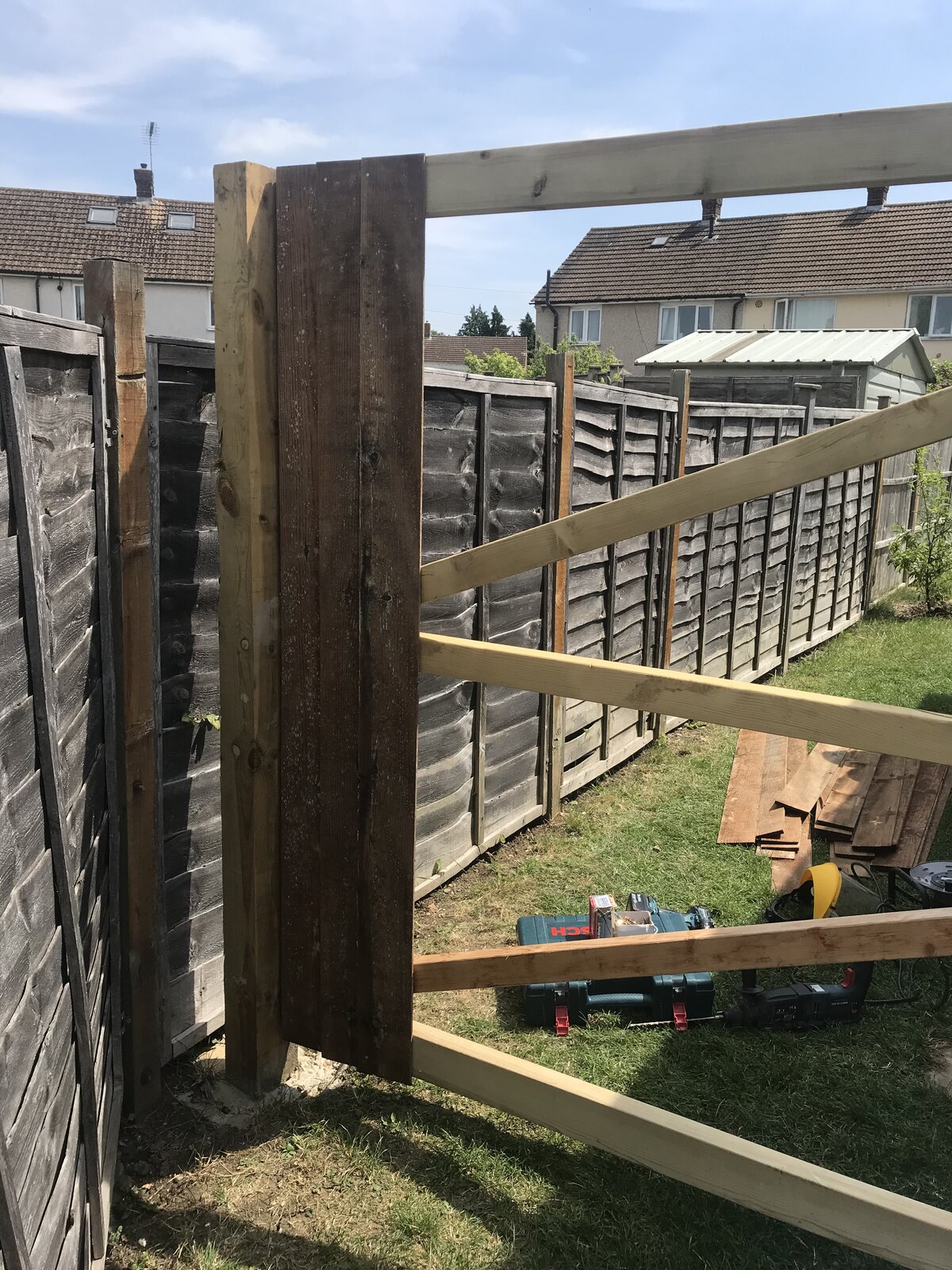

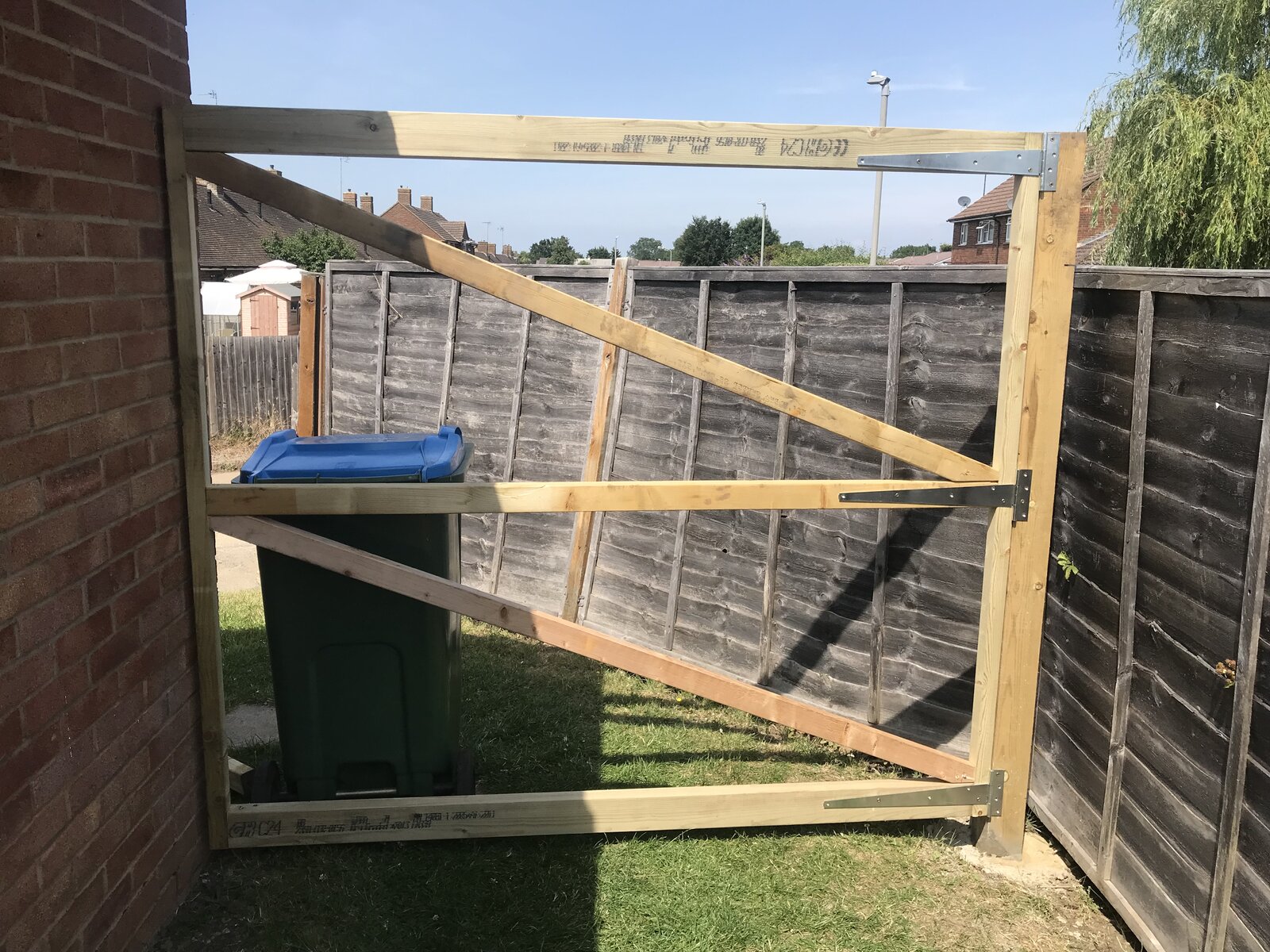

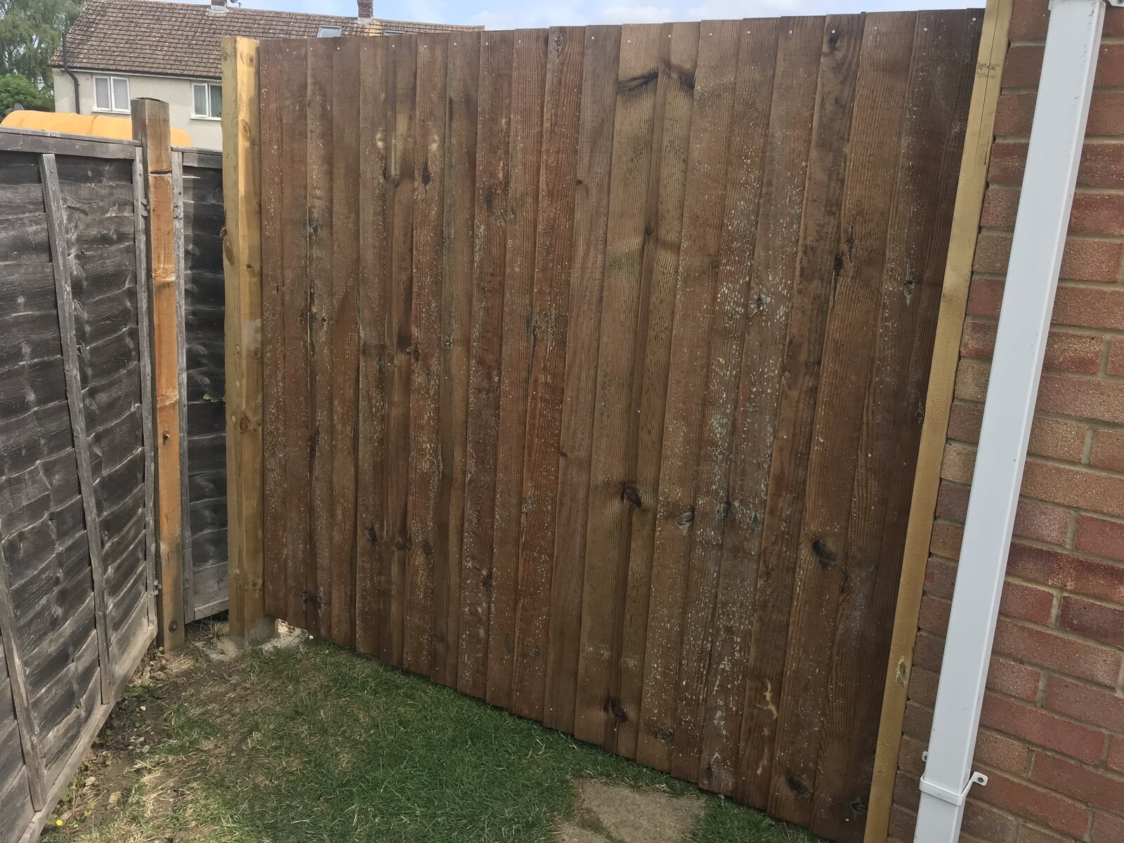

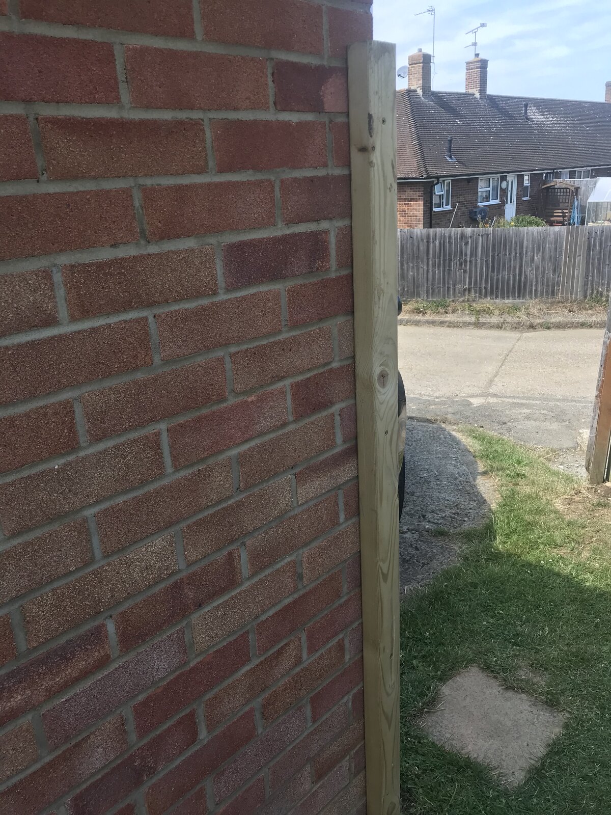

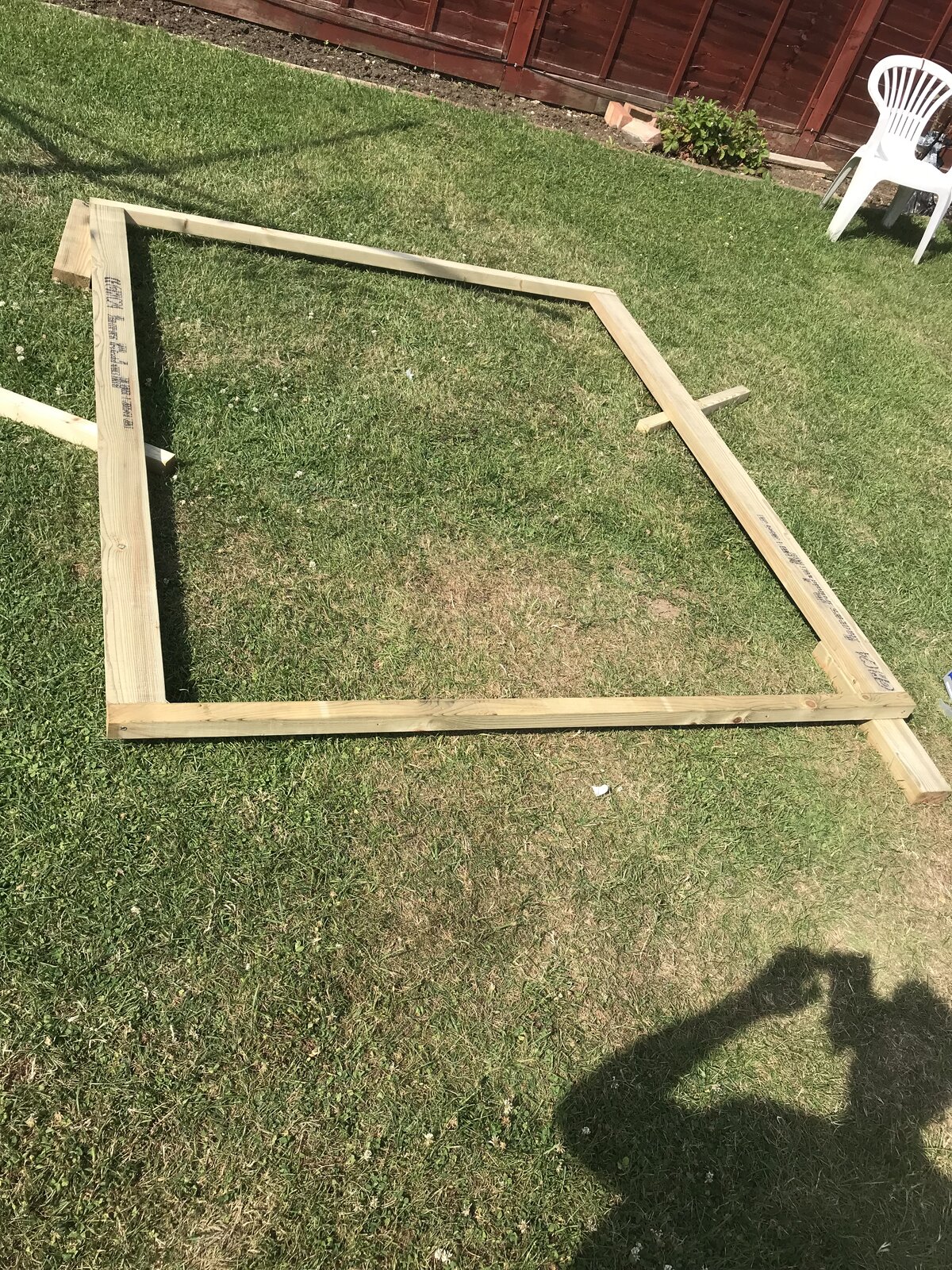

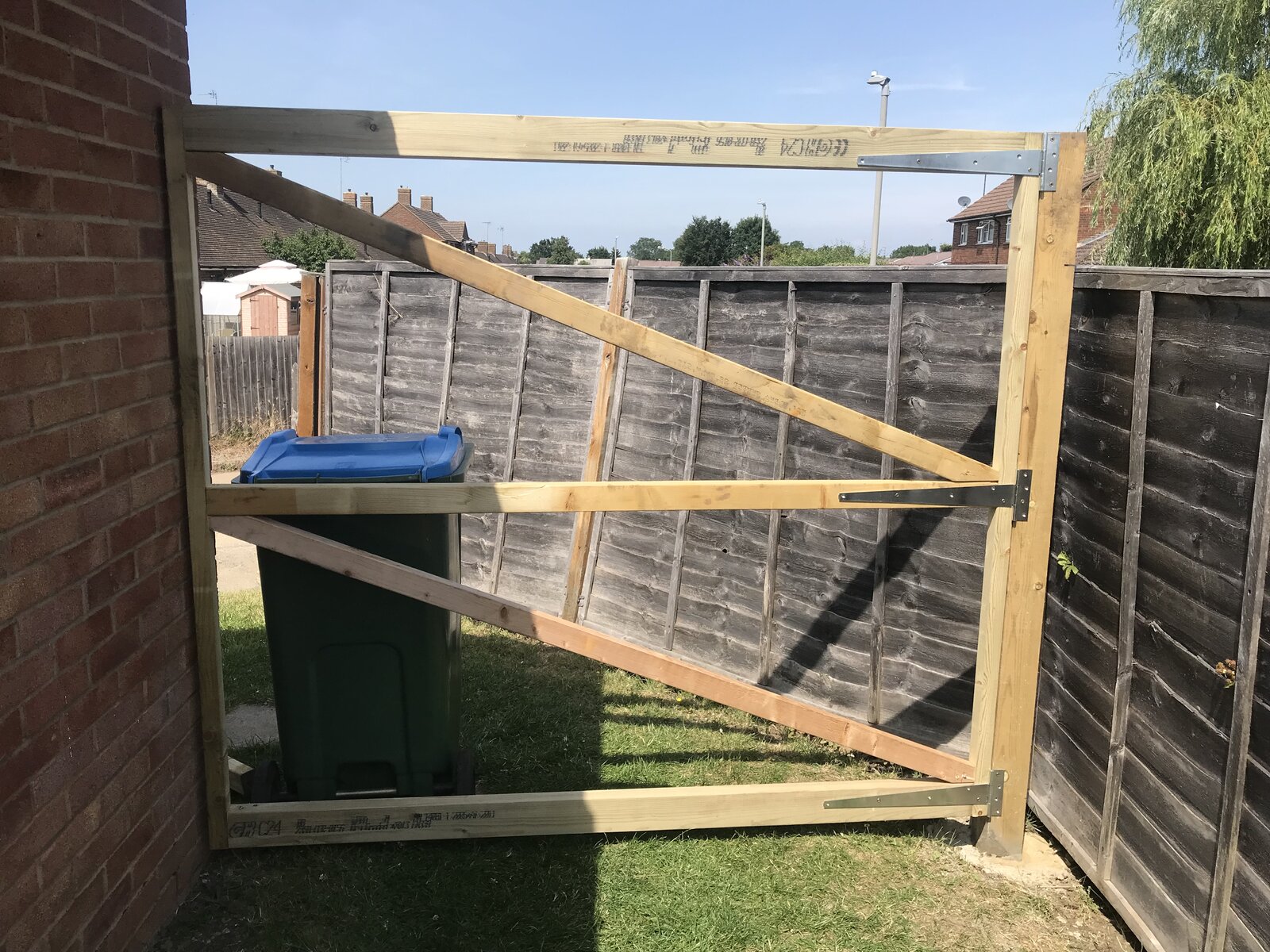

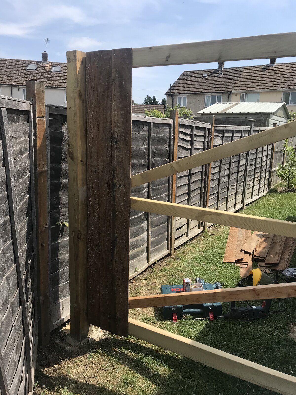

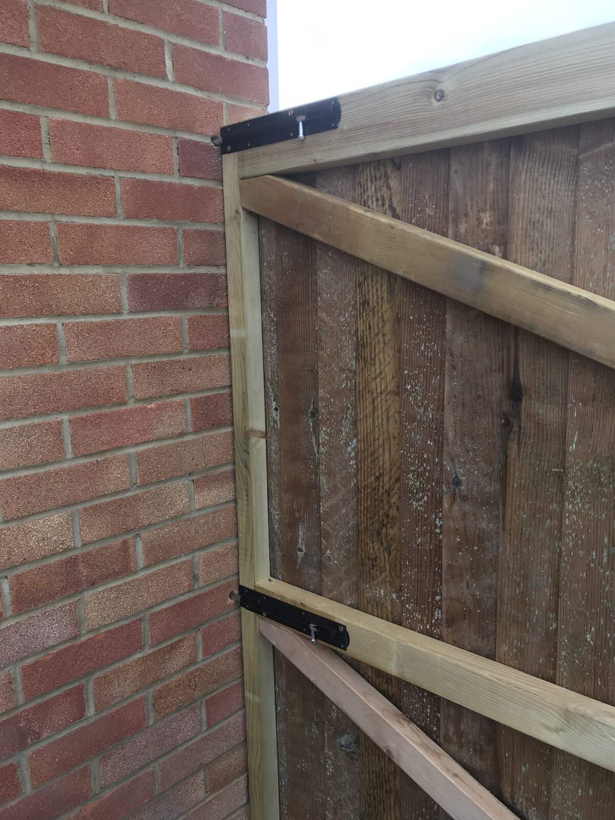

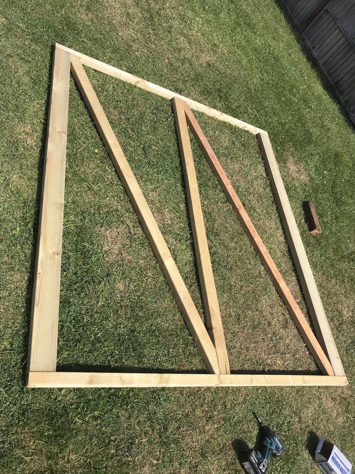

Here you go @Mr Chibs. Would welcome your feedback.
Thanks for all your advice.

Blimey, you didn’t muck around, well done.

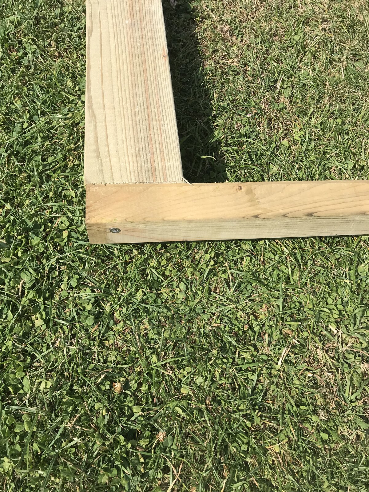

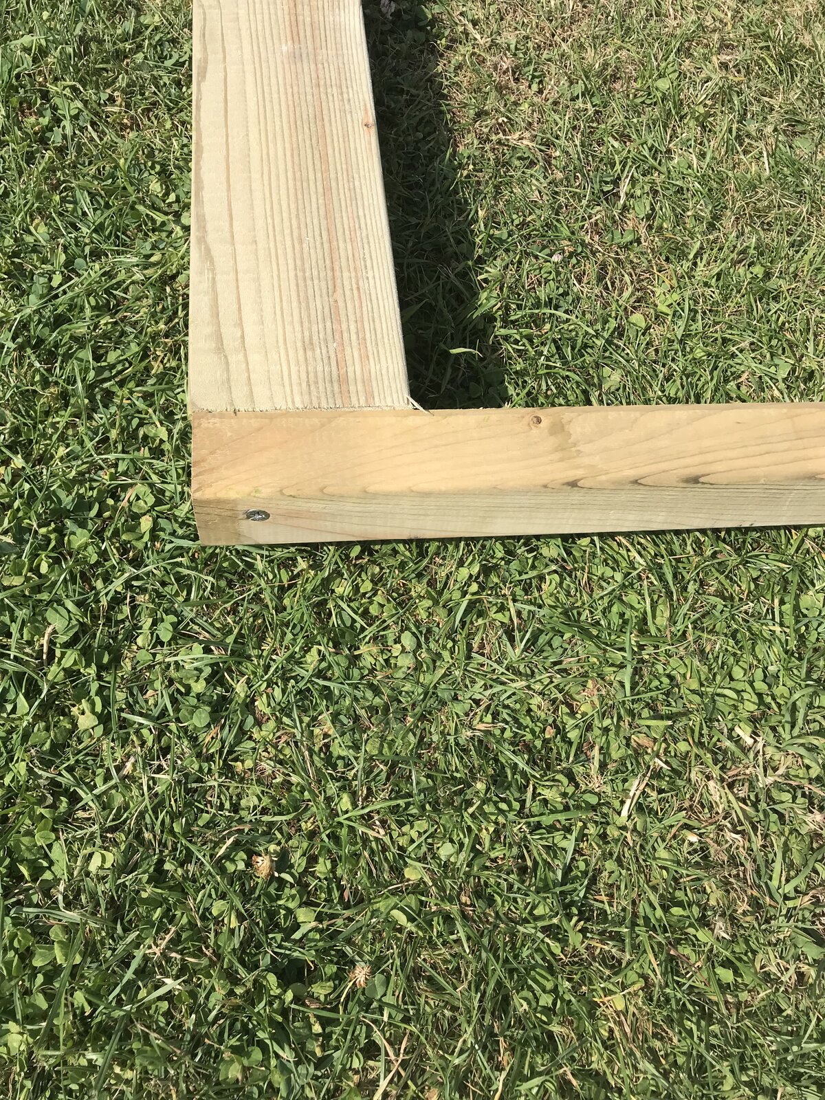

Not wishing to be critical, but in pic 2 I notice you have one screw holding this joint, was thinking it might stop the wood twisting if you could get another screw in those joints... you could do the tops easily, and suck it and see on the bottom ones, as you will have to take the gate off.
