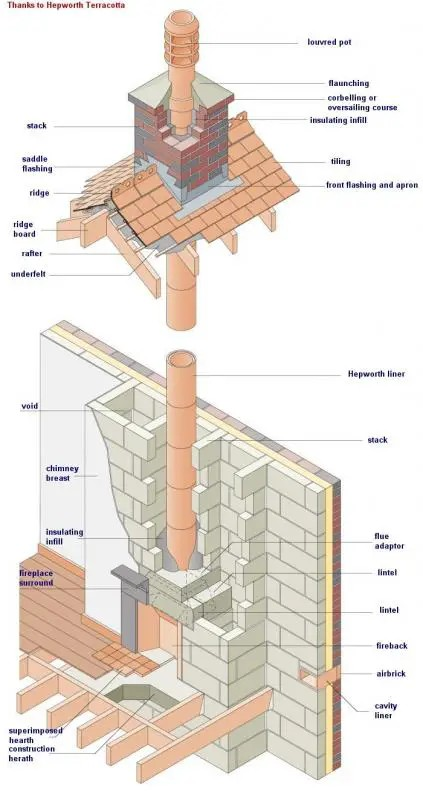

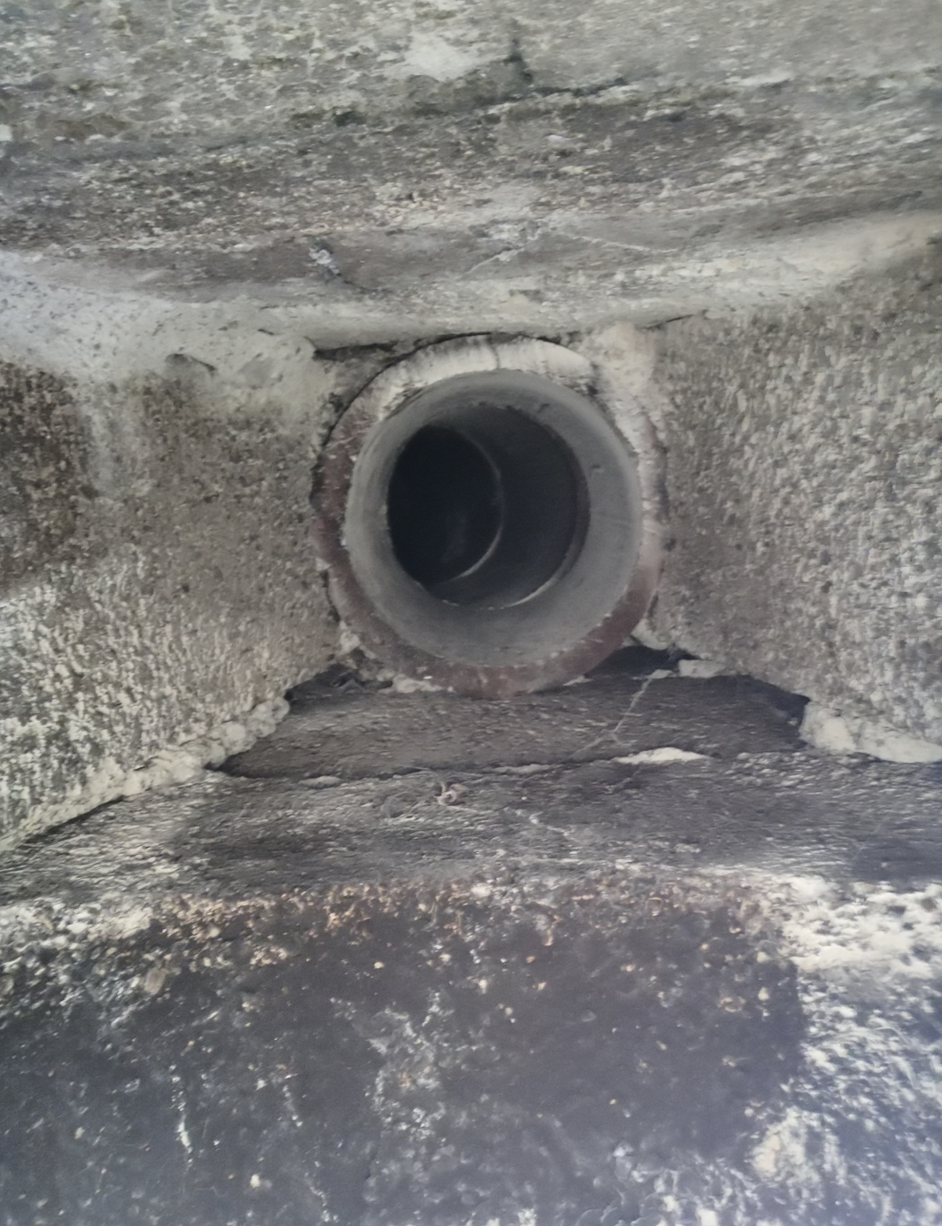

My fireplace and chimney is built from 4 inch blocks. The gather to support the flue is just two angled blocks resting on the first layer of block below the lintel as in the diagram. I haven't figured out what holds these up yet. It could be a pre-cast gather but it looks like block.
I want to open up for a stove so plan to go in with a new lintel above and cut the blocks to widen it. The question is how to support the flue. Has anyone tackled a similar type of chimney design? Perhaps a couple of internal steel lintels (like Catnic CN102) might work best here?

Part of me suspects there is perhaps blockwork behind those angled gathers supporting the flue, meaning the construction is something like this:
You will need to make sure that the stove Mfr's flexi diameter required for your stove - usually 4" or 5" - will fit through the existing masonry flue.
Your "gather" arrangement was probably the simplest & quickest solution for the brickie who built the construction?
You could cautiously open the chimney breast up for a look above the "angled gathers"?
I'm not a brickie but hopefully one will come along on here to help you better?
I'm a brickie, but I've never seen that method used before. The precast gathers are in one piece, or when brickwork is used, the bricks are cut and corbelled.
Looks like there were gaps for smoke to enter besides the flue.
Existing flue is 8 inches diameter, blocks are all 440x215x100
