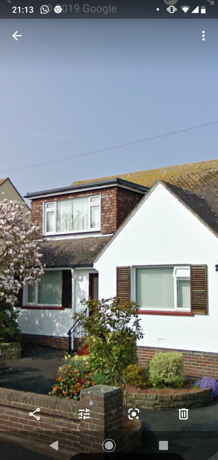

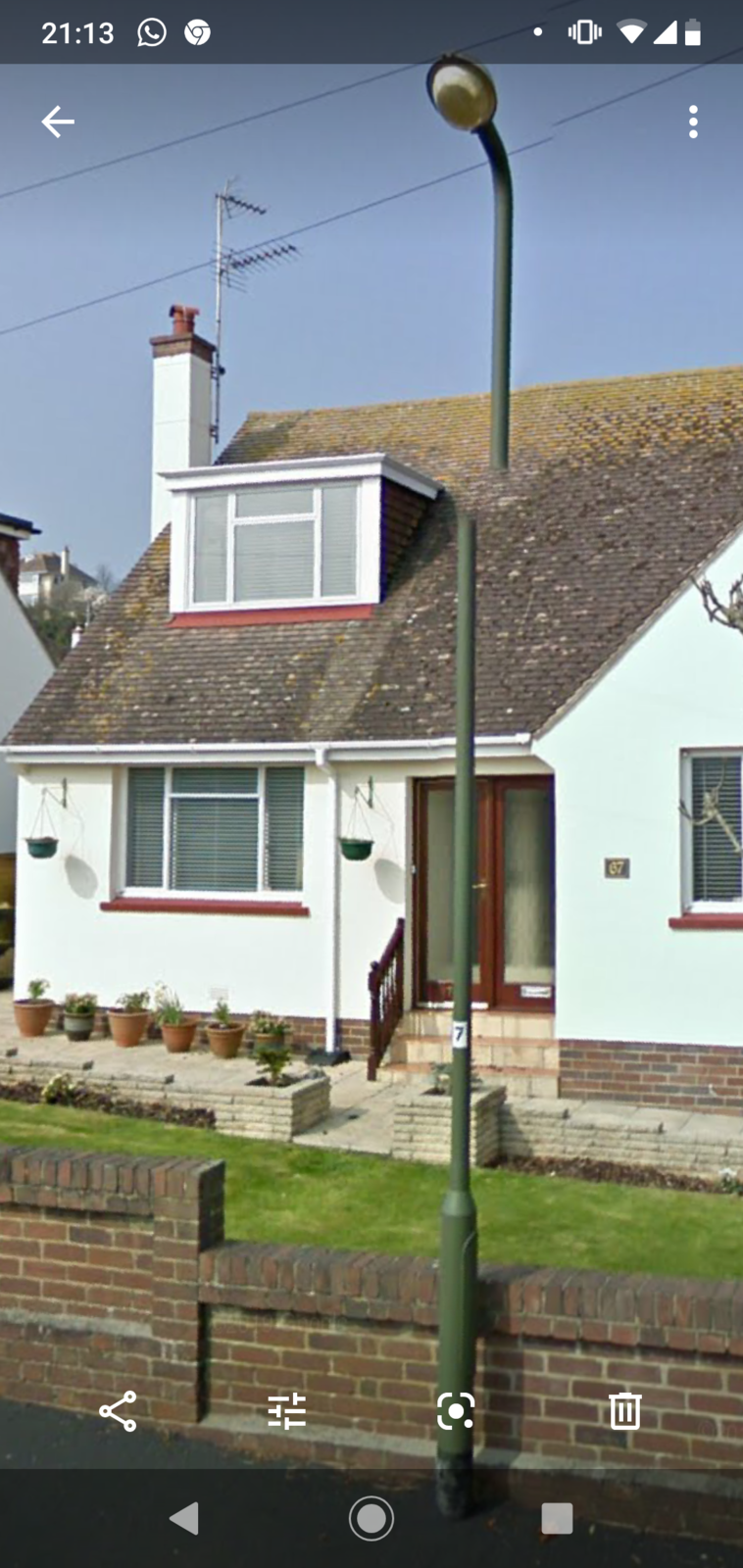

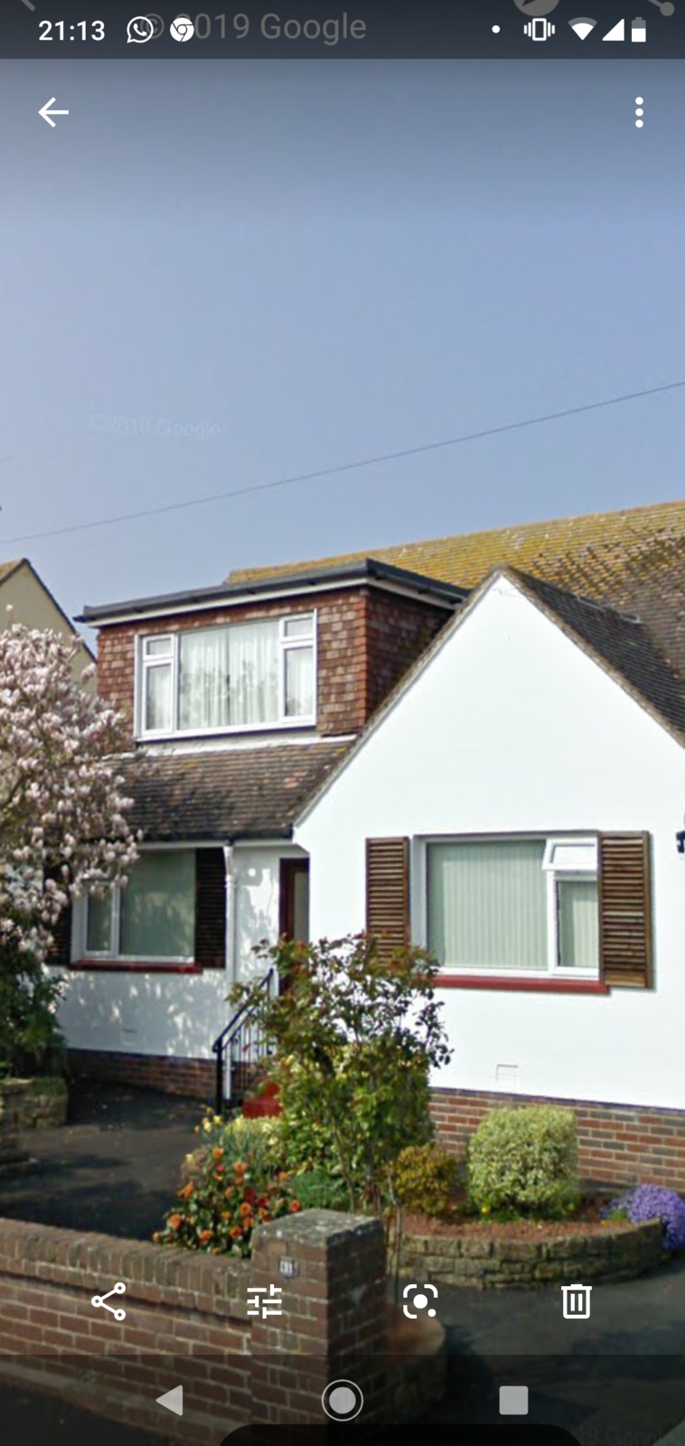

I have a small flat roof dormer out the front of the house which I would like to widen by approx 1m. If it's relevant my next door neighbour has an identical property with a wider dormer.
Any roof enlargement on a front-facing roof slope is not permitted development and needs planning permission.
Cheers for the prompt reply Tony. Is that because it is changing the appearance of the frint or because "No extension beyond the plane of the existing roof slope of the principal elevation that fronts the highway"?
It's not so much the appearance as the fact of increasing the volume of the existing dormer.
You might still be able to do it of course, you would just need to apply for planning permission ( and obtain approval obviously ).
