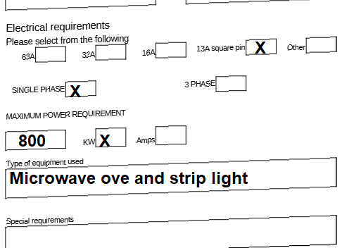

Today a fete, their booking form includes the electric 'hook-up' requirements, I was sent scans of the 5 stalls requiring power, including this one:
Seeing them requesting a 13A socket I assumed the microwave oven to be 0.8KW

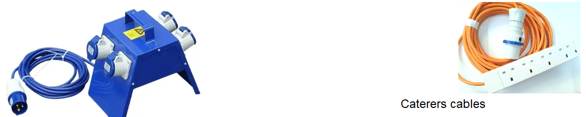

I positioned a 4 way 16A splitter box behind this catering stall with a ~3m 16A to 4 way 13A for them, plus 2 16A leads to feed 2 others further along the line.
The caterers turned up, set up their 2 gas barbies and gas urn and hooked up their power. When I checked in on them their kit consisted of their 13A to 16A adapter cable, 16A to 4 way 13A ~10m long, microwave oven and 6ft LED batten plugged into it. Roughly this:
When I saw what they had done I replugged without the 2 middle leads:
And they didn't understand why I removed their adapter cable. I truly don't know how but unpacking later I found it in my vehicle.
I see the problem here, ⁣
but what is the problem here
the 4 way adaptor has a fuse, but this one
has no fuse in the socket strip so relying on your fuse/MCB/RCBO.
The 4 ways are stock pics off the web, I chose 2 pics at random to make them look different.
I only removed mine while getting their 'adapter cable' out of the way.
The origin of the temporaries was 13A sockets in the hall so none of it was heavy duty. FWIW the 4 other stalls had similarly requested 13A sockets and they plugged their items directly into my sockets.
