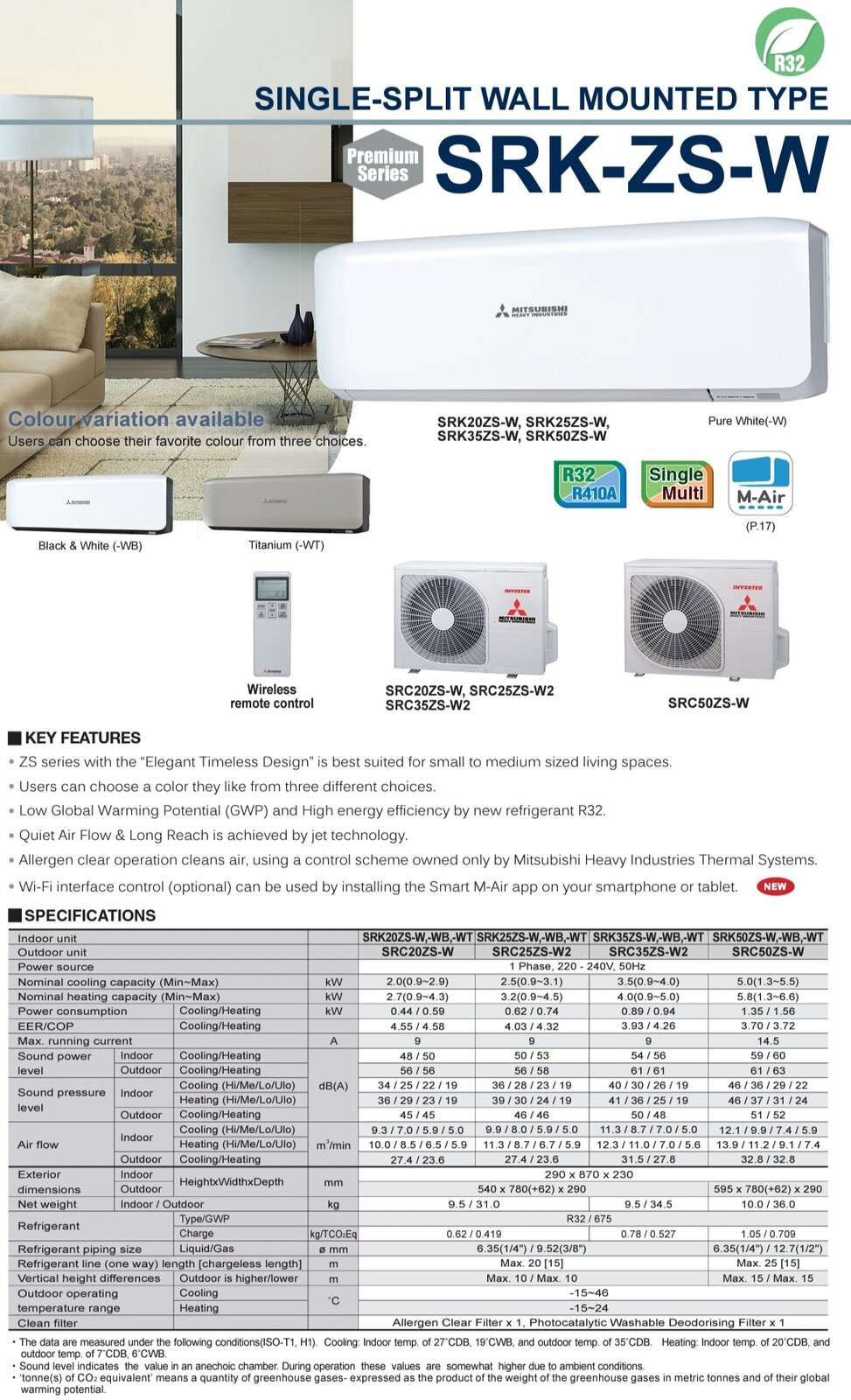

So from what I can understand, at present we run 3.15kw to get to about 16 degrees. If we get the A2A heat pumps then it would be 10kw, but we would be paying for only 2.5kw to 3kw (approximately), and probably heating the room more comfortably than 16 degrees. Note that the specific model which the installer recommended is the Mitsubishi SRK50ZS-WF.

Thanks for the replies guys. Sorry for all the confusion. I’ve specified some more accurate figures below –
Room size – 38 square meters. 5 meters height.
Current heating, which managed to get the room temperature to 18 degrees (16 on very cold days)
Fan heater – 3kw running for about 3 hours
Electric UFH – two mats covering 25 square meters (15 and 10 sqm each), 150w per square meter (this is what I failed to mention in my previous post). On a normal winter day we would run one 15 square meter mat for about 9 hours. So that would be 150w X 15sqm = 2.2kw. On a very cold winter day we would run both mats for about 9 hours. So that would be 150w X 25sqm = 3.7kw.
So basically we would be using 5.2kw heating on a normal winter day and 6.7kw on a very cold winter day (outside air temperature less than 5 degrees).
Taking that into account, do you reckon that two 5kw A2A heat pumps (air conditioners) would be sufficient or overkill, and if that would save me money on my electricity bills?
I've attached specs of the recommended unit. Note that it's the 5kw one on the far right of the specs table.
Thank you again and apologies for the confusion.
I am not attempting to answer as I am only learning about heat pumps myself. I have been reading another forum as well which has a dedicated heat pump section.
One thing I have learnt is that with heat pumps it is important for them to be sized appropriately because their efficiency varies greatly with the % output.
P.S. Thanks for clarifying. Although on reflection it should have been obvious. I was being a doofus!
A random aircon calculator says 39,300 BTU for cooling that room, 2 people, 1 PC/TV = 11.5 kW of cooling.
A random heating calculator (Dimplex) gave me 9.3 kW of panel heaters to get 20 C with -3 outside... and I made many, many assumptions about walls, insulation and windows areas and even that it is an even 5m over the whole floor area. So do do a 'proper' heat loss calculation for the room to get a more accurate number.
