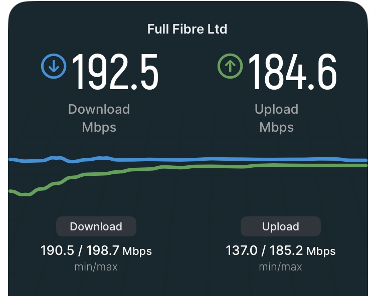

I only use Wi-Fi , get good coverage all over house and out to annex ( 40m away) with isp router and a mesh set up .
Paying for 150mbps but achieve a bit more , just under £13 a month after discounts .
