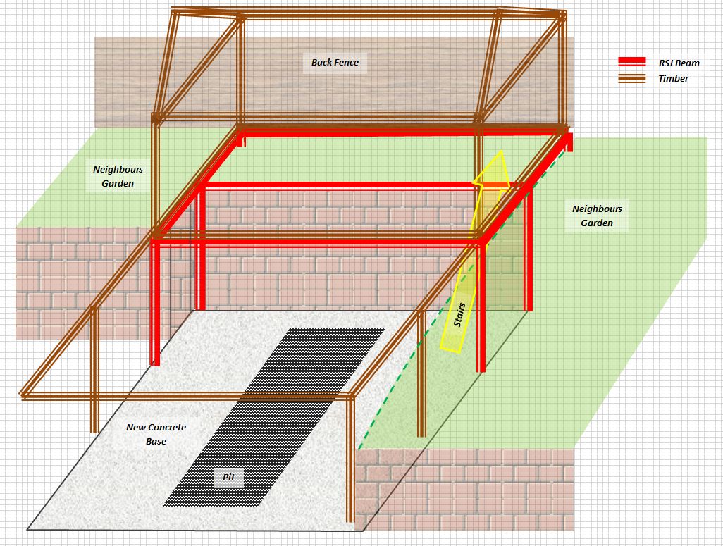

Hi, I'm looking to build a wooden workshop/shed on top of a mezzanine floor out the back of my house to allow underneath parking with a carport. Have had a go at drawing a plan, see below (in Microsoft word - don't laugh!)
At the moment the area is just a parking space with high wall at the back and approx. 2M of land running behind that, this is out the back of my house at the other side of an access lane - I would guess 8M distance from my kitchen. A few of my neighbours have built garages already, one of which I know did not tell the council.
I should also mention that the access lane is our own private property, as I understand we each own the section located directly outside our houses.
I'm wondering whether this would need building regs or any other type of approval?
I was hoping to go ahead without..

So it's not attached to the house? Planning would be required and I would predict that the chances of getting planning approval are about 1%. I would also add that if you built it without planning permission then the local authority would be extremely likely to take as much enforcement action as was required to have it removed. It would be a complete eyesore.

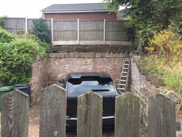

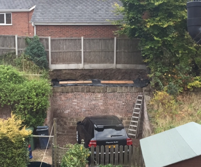

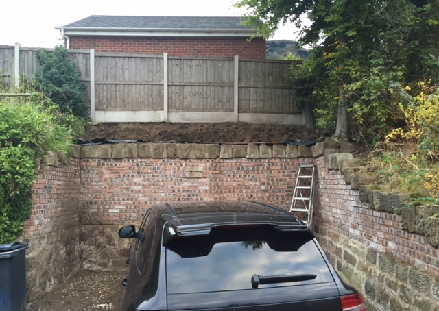

have added some photos..

It would not need building regs, and I can't see why it would not get planning permission if applied for.
You should get the proposal drawn up by a competent person to better illustrate how the work will fit in to the surroundings. Not just basic line drawings, as the planner won't fully appreciate the proposal.
