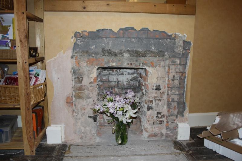

With plan to have woodburner installed...

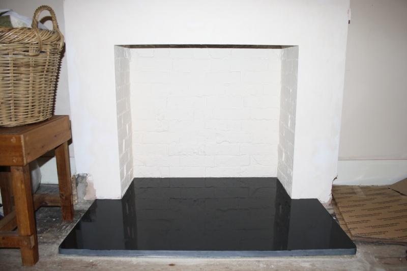

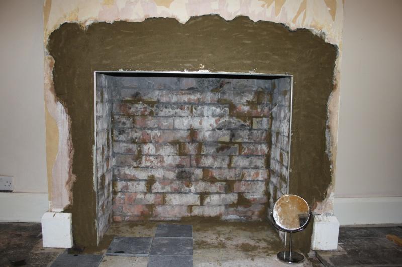

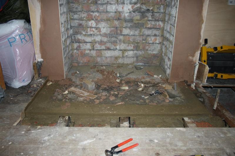

Just removed old gas fire, fireplace, and bricks to expose 1930's fire place. Extended the hearth base (built up with bricks), new slate hearth, render- plaster made good. All this with regular, obsessive (?), emails with pics and measurements back and forth to wood burner supplier-fitter. This to check that we have or have made a legit i.e., (Heatas) place to house our woodburner.
