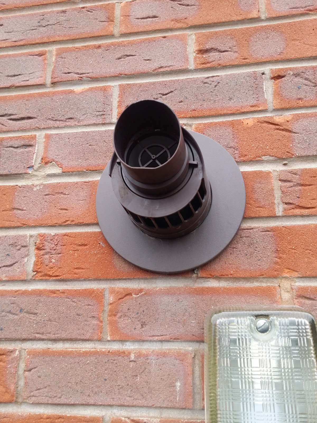

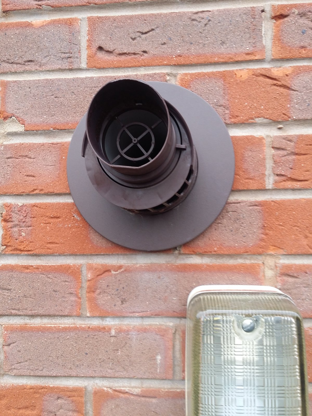

We had a new baxi solo boiler fitted but Eon did not fit the external plume pipe.. still waiting for a reply from them...in the meantime would the following link to the pipe should I buy it fit ?..I've also added some pics of connection I need it to fit

that's the exact same flue as what you have, from memory Baxis need a whole different flue for a plume kit, best to wait for your installer to have a look.
Hi...just to be clear....the photos I put up are of the fittings that Eon put in BUT they did not actually fit the vertical pipe to it....so all I really need is the vertical pipe bit. If that makes it clearer...many thanks
Because..Eon did not put a vertical pipe on when they installed the new boiler...now all the steam from the outlet (without the vertical pipe attached) clouds around the backdoor area...instead of being approx 2ft higher and away from the door.
As said you can't just stick a pipe on the end it's a whole new flue and actually it's not the most straightforward to fit either. It's deffo a job for a registered engineer
Thank you guys.I will now look further into it and once again I will contact the installer to explain and make a complaint as I have no answer from them yet...cheers
