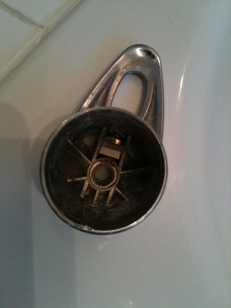

We just bought a house and as my wife turned off the hot water bath tap in the family bathroom, the handle broke off:
Underside of the handle

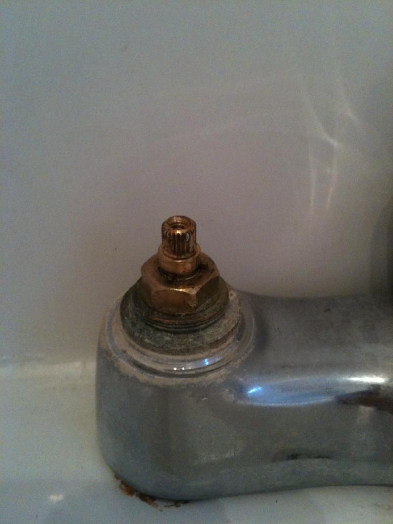

Will I need to replace the whole tap (complete with removal of the bath :confused: ) or will I get away with just fitting something like this Swirl Modern Reviver Kit Bath ¾” Lever Tap:

Presumably the original tap was the 1/4 turn type?
You will really need to remove the original insert, and compare it length for length against your proposed replacement. You also need to compare the number of splines on the tap end, their length and diameter.
Unfortunately there are loads of inserts available.
John :)

Hi,
I wish I could help but this was a one-off job a long time ago by an amateur (me) and we have since replaced the whole bathroom. I can’t remember exactly but I think I was successful in the replacement outlined above. Sorry I can’t be of much use.
