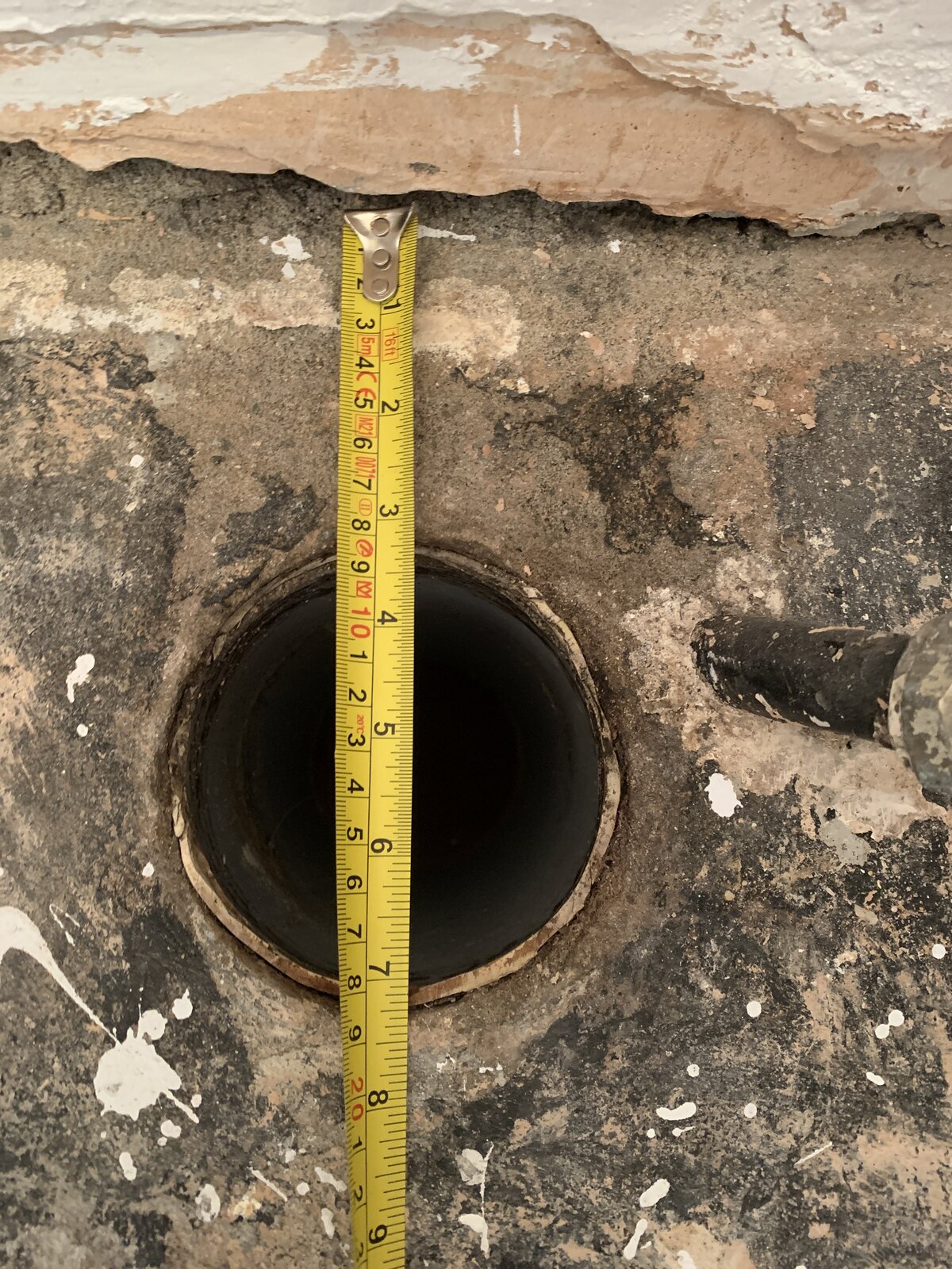

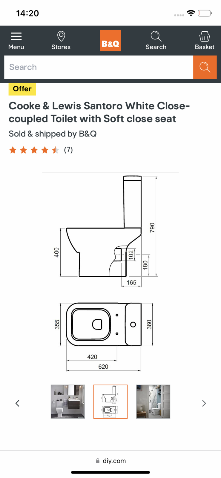

I’m looking to buy a new toilet, however I’m struggling to work out if this would be suitable for fixing due to location of soil pipe?

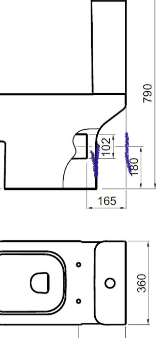

The current soil pipe centre is 130mm from the back wall, and 180mm to the end of the soil pipe from the wall. Looking at the measurements for this toilet, it’s around 150mm from where the back wall will be to the toilet (purple lines) covering the soil pipe?
Would this not measure up right, or have o not looked at the measurements on the website correct?

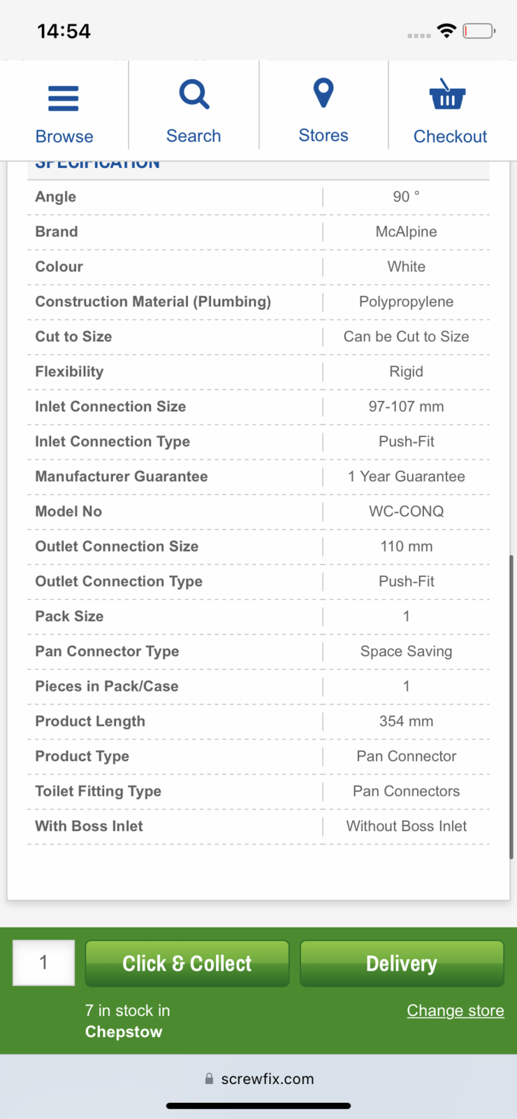

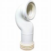

You would need to add the pan connectors (probably a swan neck connector) dimensions into that diagram and then gauge where the connectors pipe centre would be in relation to the soil pipe in the floor. That would dictate if the pan would then fit with the cisterns back against the wall properly.

thanks so much for your respone. Please are you able to give me an example of this using these swan neck measurements so I can get the gist of it please? First time doing this!

Different wc outlets to the centre of the pan connectors will be different. The only way would be to go and ask them if you can measure the centre with a pan connector fitted.
