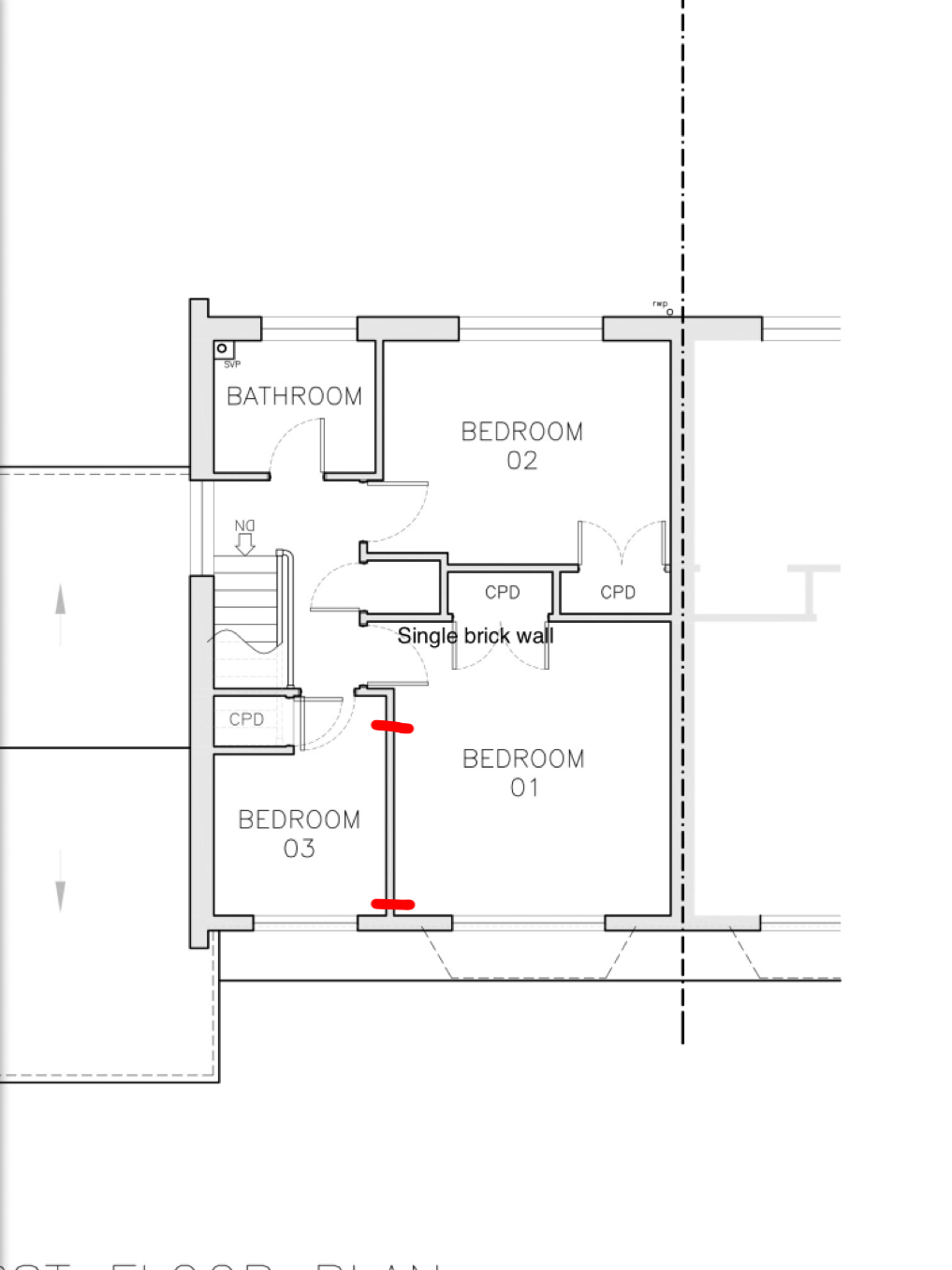

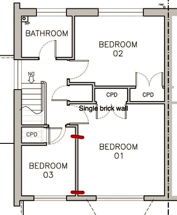

Removing the non-supporting wall (red lines) which meets front, single-brick, tile-clad wall, between the 2 front windows..
SE initially agrees removal of wall up to front wall.. Then, in report, requires a 50cm stub to remain..
..after querying this, he suggests a windpost design might suffice.
Our aim is to have a nice large bedroom - not an archway between 2 adjoining rooms.
Is there another way -- maybe we can suggest to this SE or a different SE?

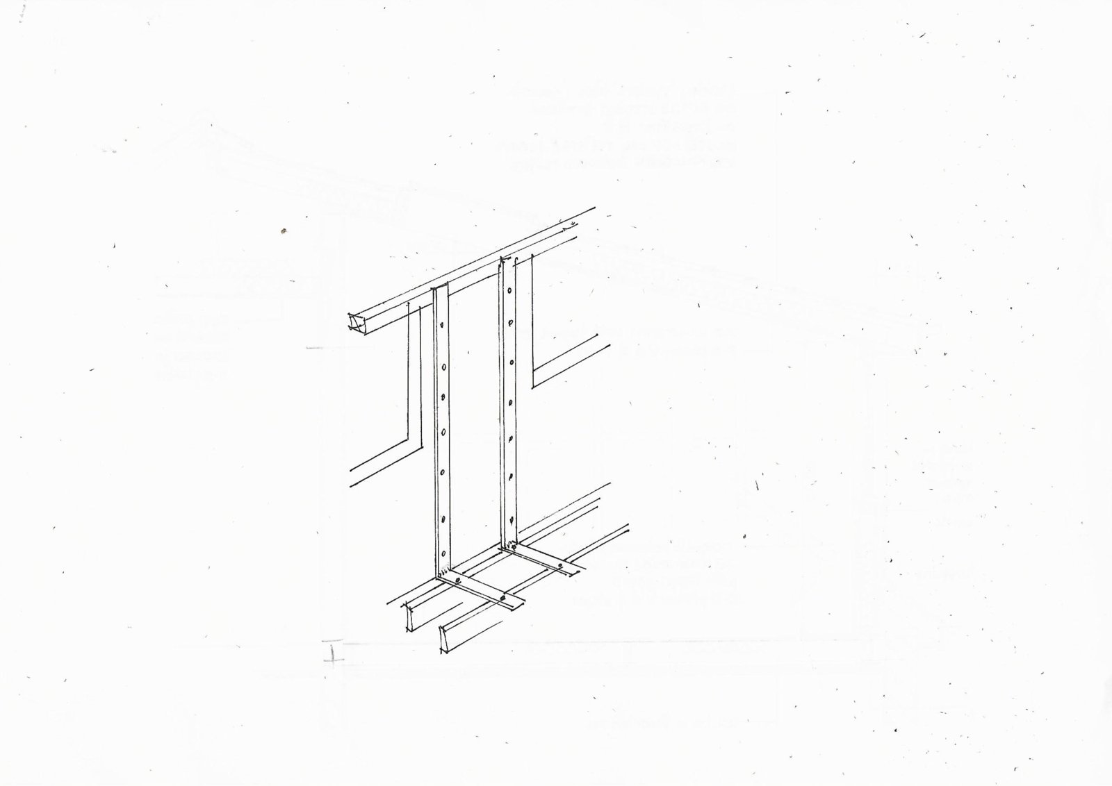

Eg. Brace the entire inside of the wall, down to lintel below (the ground floor wall is a cavity wall), with 15mm ply, screw fixed at 400mm centres, horizontal and vertical, with suitable steel straps to screw fix to joists with noggins to interlink the 3 or 4 floor joists nearest wall (they are parallel to front wall), then insert a 4x5 timber/glulam at ceiling height fixed to remaining wall by doorway, and fixed to ply+front wall with wide steel bracket. Add a 10mm (?) steel right-angle strap at floor joist height, screw-fixed to joist(s) and screw-fixed to ply/wall with resin fixed bolts...
Something like this?
I'd guess the 1" battens fixed externally for the cladding tiles are a significant part of the wind resistance of the front wall currently..
Any thoughts?

1960 semi-detached brick cavity, 9" party wall. The odd-one out is the front 1st floor wall, which is brick, single-skin, with ~1" battens and concrete cladding tiles.
I suspect it originally had metal crittal windows.. the tell-tale signs of superficial cracking to plaster suggest later UPVC windows did not give the same structural support as those crittal ones.
I further suspect the tile battens to exterior of the front wall are lending it some lateral strength.
A wind post will be a bit more costly but much narrower than a stub buttress. You might be allowed to chase the channel section into the wall to reduce the impact further, and by that time you'll be able to lose the remaining protrusion in the finishes.
I guess the se has seen the construction and decided there isn't enough stability in the effective single thickness of external masonry wall. This could be especially true if it has windows in it as effectively there's no return on the wall either.
The extreme option would be to rebuild that part of the house using timber posts and framework on the inner leaf but the se is trying to design the most efficiency solution for you based on budget and requirements. I'm not a pro just had a load of work done designed by an experienced se.
That seems like overkill to me. Maybe you should just get a new structural engineer.
It seems bonkers to me. A 50mm buttress will do very little. You're tied in at the top and bottom of the wall.
You can use angle iron and gun ties in, that will be cheaper than a windpost.
What is the total length of the wall? What are your ceiling heights?
Sorry, intended sticking with mm.
Small room is 2.1m wide, large room is 3.4m wide...
..the width of the single brick wall, once the internal wall is removed, will be 5.6m
Room is approx 2.3m ceiling height.

Your SE has correctly identified the fact that the single-skin brickwork is not suitable to span vertically between the top of the cavity wall and the underside of the roof structure. The critical weak point will be the full-height wall between the windows, because that will be taking wind load on part of the windows each side, as well as its own area.
The wind load induces bending in the brick skin, resulting in tension on the room-side, which brickwork is not capable of resisting. Rather than a chunky wind post, why not consider screwing two (or better, three) strips of steel, say 5mm thick and 100mm wide, to the bit between the windows. These should be suitably fixed to at least two floor joist at the bottom, and to the roof structure (via the wall plate?) at the top.
These would not be true wind posts, but if fixed with sufficient screws, will add some tensile strength to the brick skin as a whole and so improve resistance to lateral wind load.
I read "single brick" as a 9 inch solid wall and the drawing certainly seems to suggest that. It would make more sense for the engineer to ask for a windpost if it was actually half brick single skin?
You may actually be right. I've always thought of a single-brick wall as 102mm but even for 1960s build, such a thickness - even clad with tiles - would seem to be a bit flimsy (though the plan shows the structure as cross-wall type).
