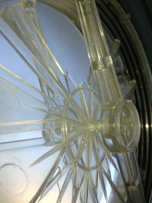

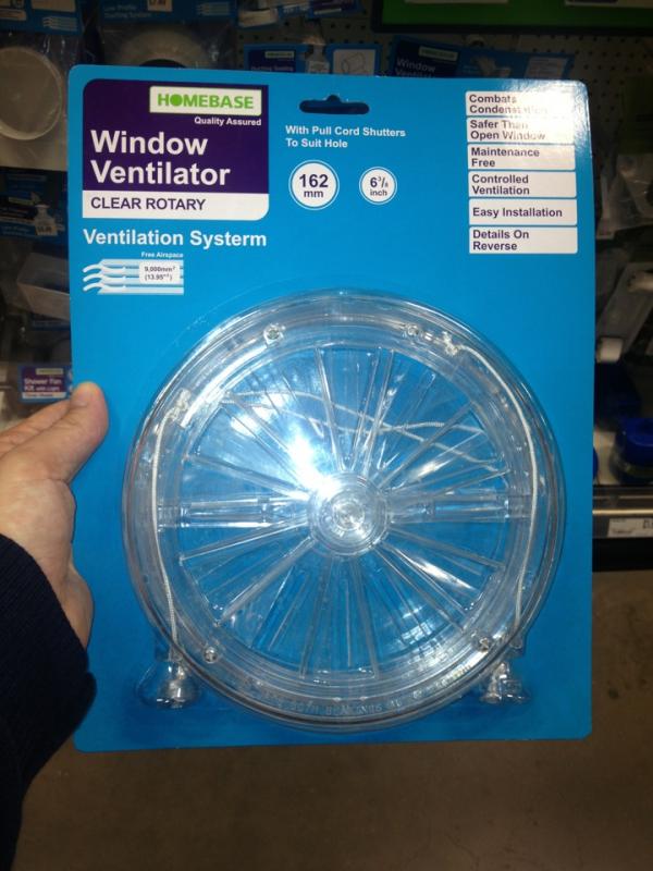

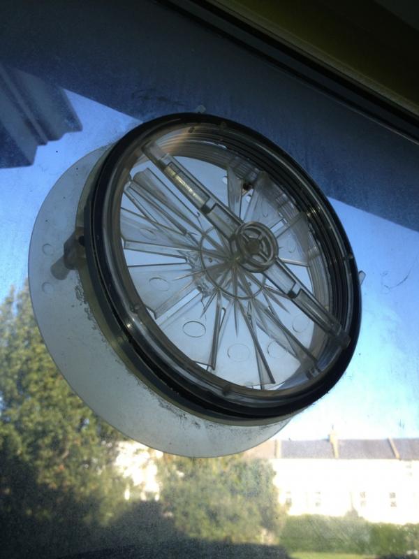

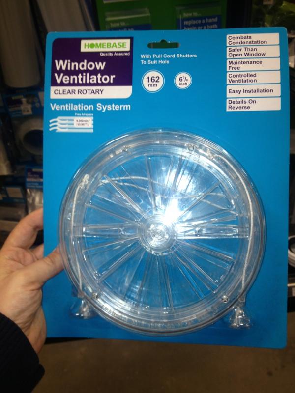

Hello,
I have a vent in the bathroom which has been broken for a while.
According to initial research online, it seems that I will need a double glaze one unit as the single one will be too small.
http://www.wholesaleglasscompany.co.uk/acatalog/VentamaticRotaryPDS.pdf
http://www.simonairmanagement.co.uk/category/VentAMatic/product/Simon_Rotary_VentAMatic/
up to 6mm for single glazed.
I have old double windows glazed aluminum frame and I sadly believe that the width of the windows is over 6mm and closer or more to 1cm.
I have a quick glampse of the double unit type....and the price was shocking...
http://www.amazon.co.uk/dp/B001KM974C
http://www.ebay.co.uk/itm/Simon-Ven...444?pt=LH_DefaultDomain_3&hash=item5d58b45b84
What do you think?
Do you think that a single glazed type can be sufficent?
Can I just buy the broken rotary fan maybe?
Any alternative suggestion?
Thanks,
I would replace the dg unit and install a vent to the wall. Always found those plastic things pretty useless.
Only cheap option would be to replace the round vent with a couple of square plastic vents siliconed to the window.
Thanks Foxhole for your comment. I am pretty newbie to diy stuff... so when you mentioned a vent to the wall, could I ask you what do you mean? what kind of vent? (any chance of a link from ebay / amazon / or Uk diy store?
when you mentioned the cheap option to replace the round vent with couple of square plastic vent, is there any chance of a picture so to see and have a better understanding of what you mean please?
Thanks,
Jeremy
Vent thru the wall , requires drilling.
http://www.toolstation.com/shop/p89...765743&gclid=CjwKEAjwqLWrBRC-_OaG-IfL0kASJAAb
Thanks,
Jeremy
http://www.amazon.co.uk/Grille-Cover-150mm-6inch-Ventilation/dp/B00BX4XYPK
couple of these siliconed either side of hole.
