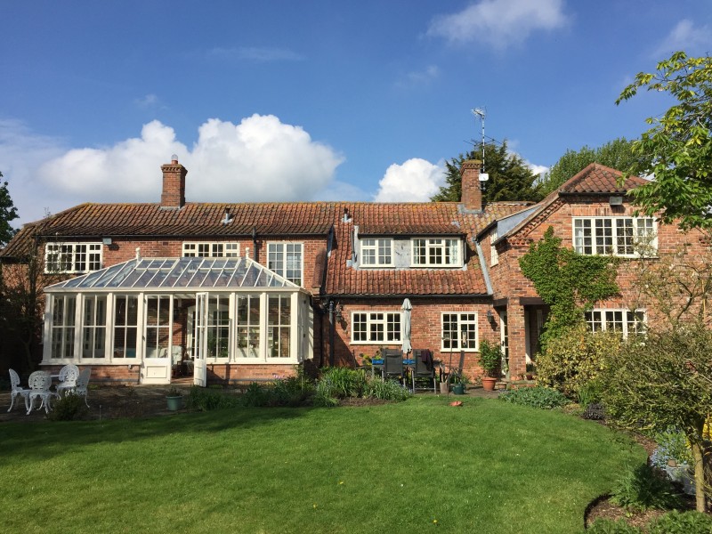

There are approx. 750 individual panes of glass in the house, each puttied into timber - it's a big place. Assuming one coat of primer/undercoat and one top coat inside and out, that's 3km of edging (ouch!) that needs to be painted, ignoring the putty repairs. It really is the old Forth Bridge proverb.
The photos below show what it looks like now and what it may look like when converted. There is huge gain in doing this, but as you say, appearance is also important. The countryside views from inside the house would be massively improved.
Quite difficult for us to have a non-biased view on this - we are now so used to it as it is.
If the house didn't have the Georgian bars from the start, you probably wouldn't think about it - most houses don't have them.
Would value any opinions on whether you consider the appearance to be better or worse ...
That's big. Not just a single window then! I don't think it looks bad at all without the georgian bars, although they do add a certain "character".

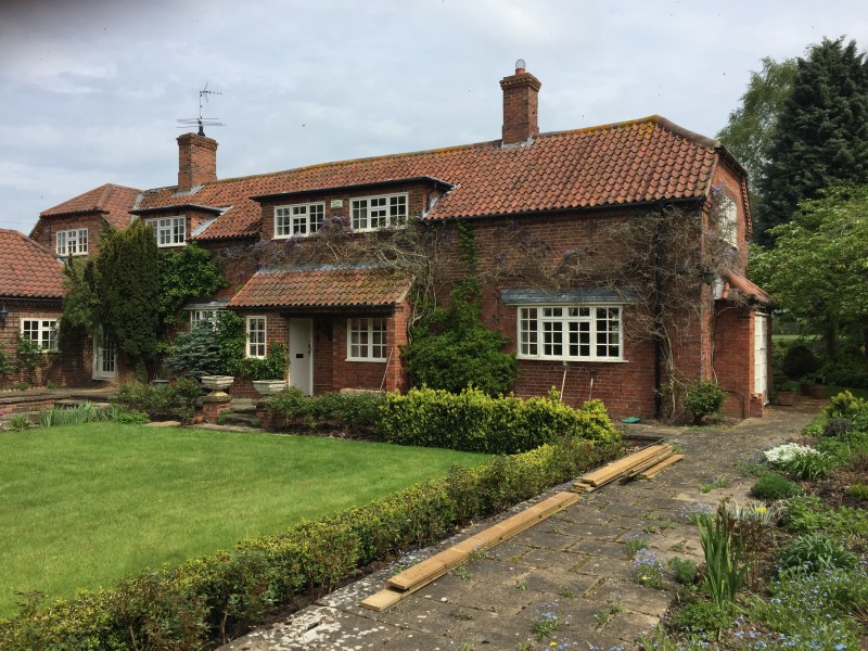

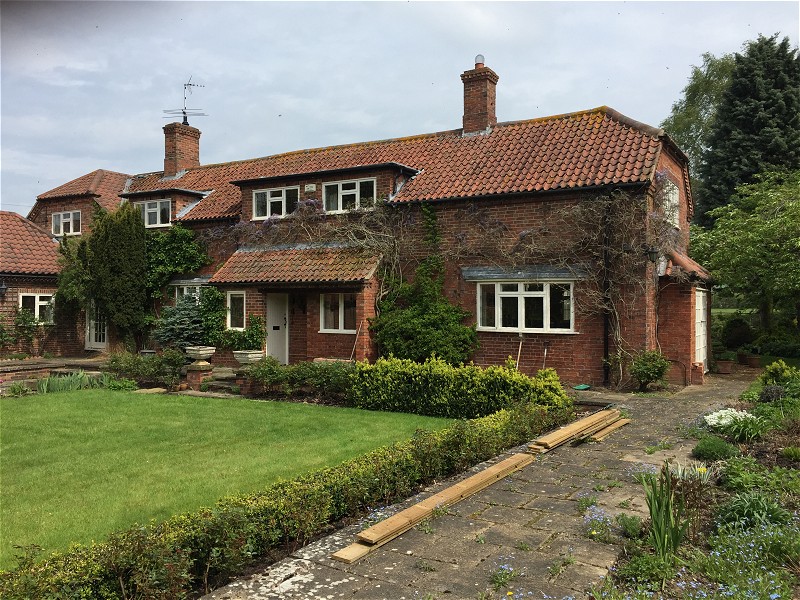

Yes, it's a big property. Below is the front elevation, existing and proposed.
Thanks again for your input - appreciated.
