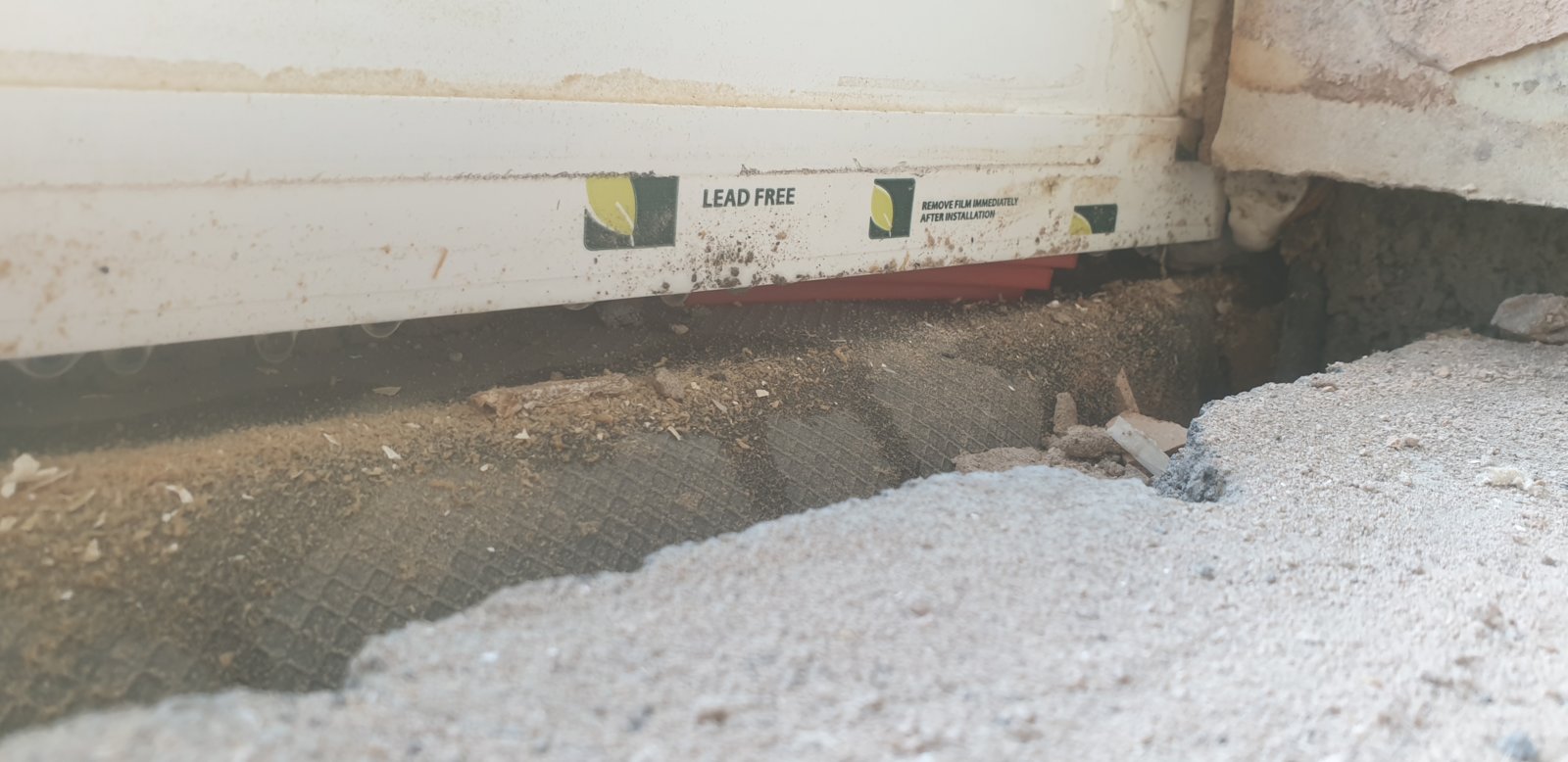

Hi Guys,
In need of some urgent help.
So i noticed that the windowsill under my downstairs hall window was getting water damaged very slowly (The wall next to it was also showing signs of damp patches.)
I mixed up some mortar and re-pointed between the metal under the weep holes (Above the window) and the window trim which i though could be where the water was getting in as the mortar line was poor and it made the situation a whole lot worse!
I woke up the next day and the windowsill has completely blown with water (As its MDF)
I obviously haven't got any mortar in the weep holes they haven't been touched and water shouldn't be getting into the holes into the house as there should be a moisture barrier... any ideas why this could have happened? There was obviously an issue in the first place but how can me re-pointing exacerbate it so much!

It was getting wet directly under the left vent on the windowsill inside but from underneath
do you mean the water was dripping down from the head of the window onto the cill?
I would start by taking off the external trims, see what the silicon is like and re do it.
if its getting damp from the bottom it would be helpful to know the external cill detail -is it upvc cill or brick / concrete
Drips from underneath

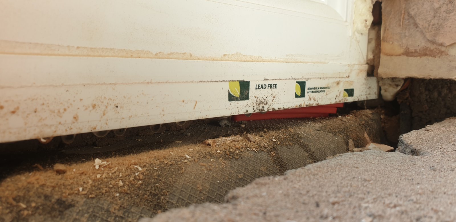

25 years so no NHBC. No drainage in the actual window but I think the water had blown in from outside maybe? I have used expanding foam in the void and will monitor before fitting another board

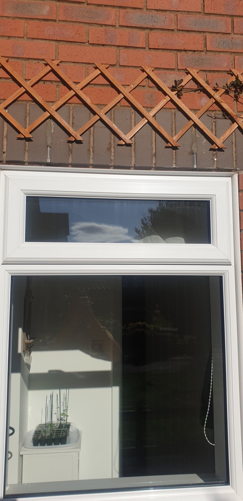

check window drainage holes.
youve got a window that is direct glazed below a fanlight.
the direct glazed part could let in water in high winds which should discharge out through the extermal cill

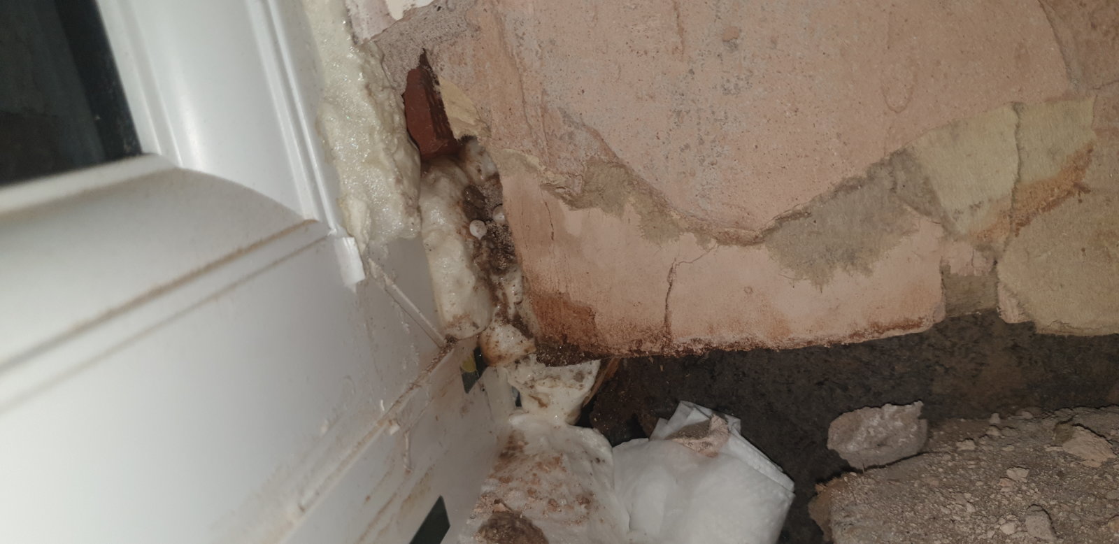

Update.... after filling the cavity under the frame with foam the water bow only comes in the corner one side. Hopefully you can see the picture but it's on the inside of the brick an inch away from the window frame. Any further thoughts guys?
