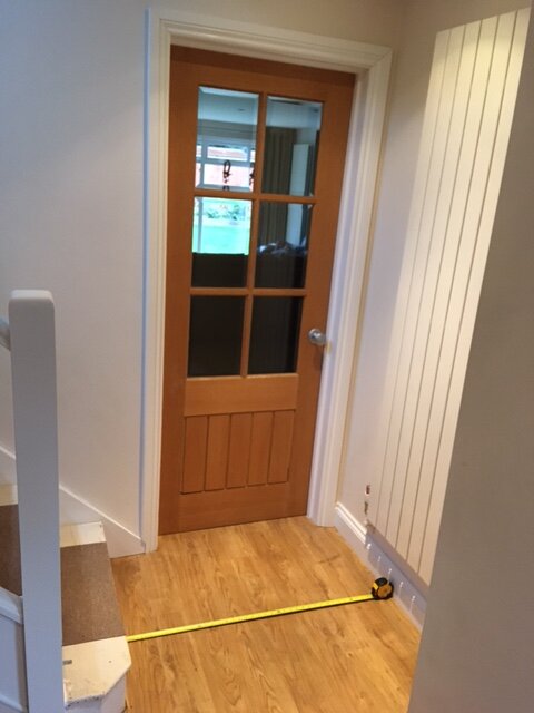

I’m looking into the possibility of installing an internal window in the stud wall opposite the bottom of my stairs
My stairs are 180 switchback stairs (6-1-6)
Can anyone confirm please if this is allowed and if so, are there any regs regarding window size, height from floor, overall height, glass type, thickness etc ?
TIA
Sean

Jeds - thanks for reply !

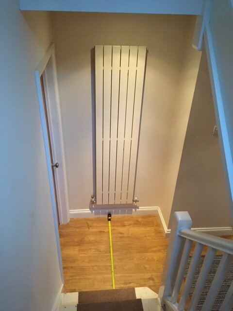

For info and a little more context, the window i am hoping to fit is in place of the radiator as shown in my photos
I plan to fit a smaller radiator at the bottom with a window above so based on any regs, the height and width of the window can be whatever is allowed
The door next to it has safety glass already (EN12150) so was planning to source something similar
As shown by my tape measure, the distance from the bottom step to the radiator wall is 1100mm
So to remain within building regs, is the only stipulation that the window CANNOT be lower that 800mm from the floor and must have safety glass ?
Obviously the risk i am thinking of is if someone were to fall forward from the bottom or perhaps 2nd step...not sure if i'm over thinking this :cautious::cautious:
Can you explain what you mean by "protected fire escape stairs" please ?
Our property is only a 3 bed link detached so these are our only stairs
Thanks again for advice...appreciated (y)

You say within 300mm of a door that it MUST be safety glass anyway so i'm curious in my situation, why that would be needed considering that the door is 90 degrees to the left of my proposed window and the risk would be falling forward not to the side ? (or is that just how it is and doesn't cater for every scenario, nook and cranny etc)
Are you able to confirm which section of the building regs is relevant here please ?
I've had a look through an online doc that i found but couldn't locate the relevant section
Thanks again for your input (y)
It's just how the reg is written - anything within 300mm of a door. I think it is meant to catch windows that adjoin doorways but as always - unintended consequences and all that.
