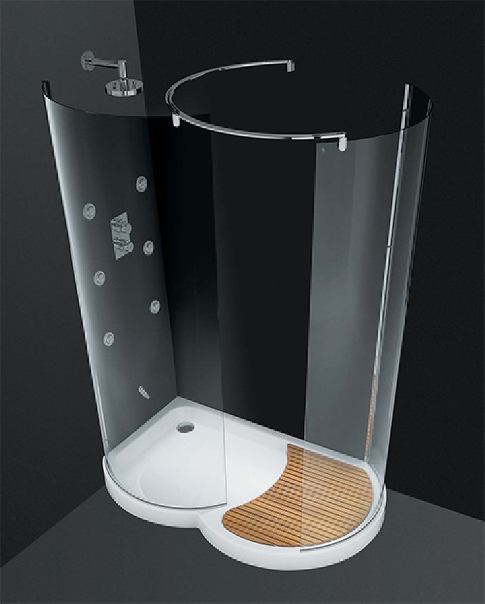

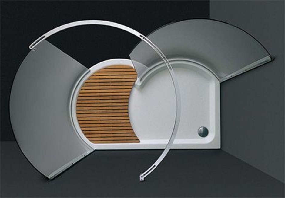

Curved glass might be able to miss the window and still butt up to the wall...
...but I daresay they are remarkably expensive!!
