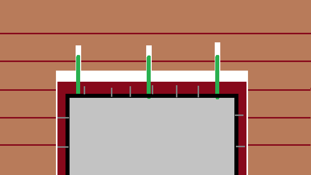

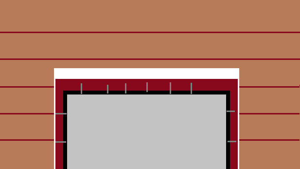

  • Let's picture the basic set up, and how to affix at the top to stop someone pushing the window out:
The window (black and grey) is mounted into a wooden frame (red) using screws and then sits in the whole in the log wall, with an expansion gap at the top.
We cannot constrain the movement.

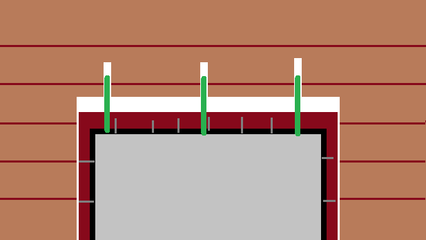

So what if we have a kind of dowel type affair:
We drill holes up into the log(s) above the hole say 100mm. Then we put some sort of rod through the wooden window frame fixed in place, sticking up. Like say an M12 bolt but the hole in the log is wider than the bolt so it can't engage the thread.
We make the bolts long enough they cannot fall out of the holes, and the holes long enough the bolt will never hit the top.

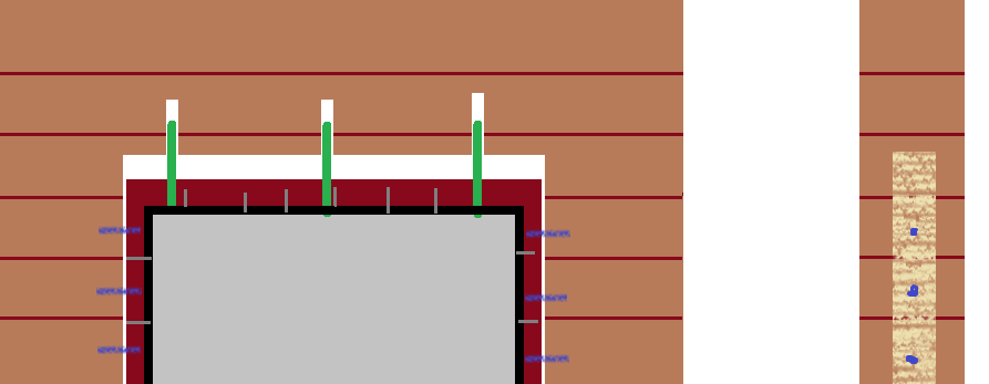

  • What about at the side? We can't do the same idea with the bolts but we could rout a channel down the middle of the window, and put bolts through that are held in the channel, a bit like the way your wheel holds the tyre in place:
Are these sensible or stupid ideas? If not totally idiotic, how would you improve them and in particular, what fixings might I use? Are there things out there more designed for such things than "a bolt that's not as big as the hole"?!
