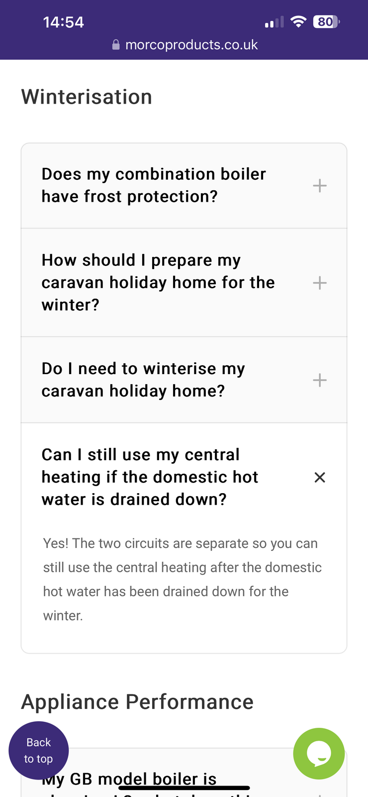

I have a Nest z3rd generation learning thermostat fitted in my static caravan which controls the heating on my Morco GB 24 boiler. I will soon need to winterise my caravan and will be draining down the hot and cold water system using a Floe 868 and setting the boiler to frost stat. Am I right that I will need to turn off the thermostat, set the heat link to manual - but also switch off the safety temperature control on the thermostat to prevent it from trying to override the manual setting? Grateful for any advice? Thanks

Wouldn't running a boiler that has been drained of water be a bad idea?
According to Morco it’s ok to run the boiler

Yes, the frost stat will only do the boiler. The radiators and pipes have antifreeze protection but I don’t want them to heat up. I don’t want the nest thermostat safety temperature to override the frost stat on the boiler and try to heat up the caravan - because it can’t on that setting

You would be safer letting the nest handle the frost protection, the boiler frost thermostat only protects the boiler not the pipes and rads, even with anti freeze in it is still a risk

Thanks. I’m planning to get the concentration checked to minimise that risk. Just wanting to test my assumptions
