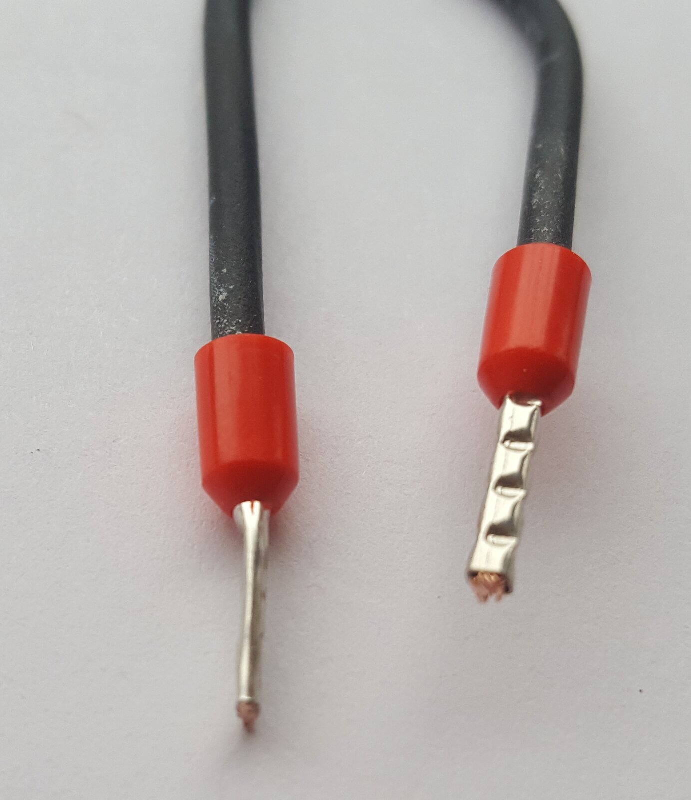

Although, depending upon your crimpers you may be able to get flat blades just using the normal cord end ferrules (Bootlace crimps).
Mine crimp it square but a subby we have in gets them flat with his.

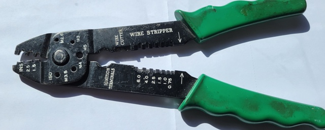

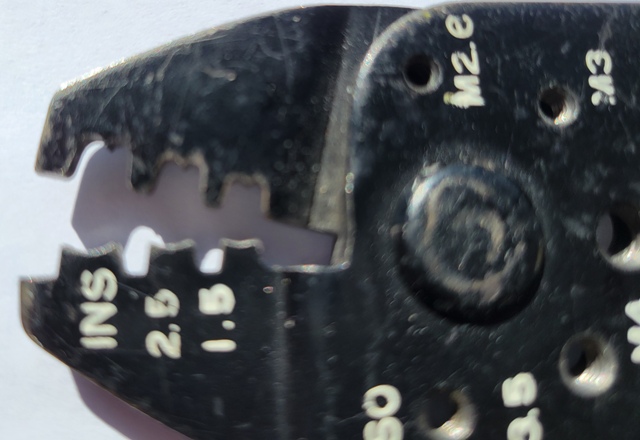

Cheers @mattylad They're the only ones that I seem to be able to find as well. My crimpers for the bootlace ferrules crimp square as well (a kit I bought from TLC) but I might see if I can find the other crimper type you mention. :unsure:
Not tried it (yet!) but would normal bootlace ferrules and a pair of pliers work to produce a flat blade
i have a pair of parallel jaw pliers so I might give it a go.20240503_102019.jpg it does seem to work though
Or you could get a pair of the correct crimpers for the crimps I showed.
