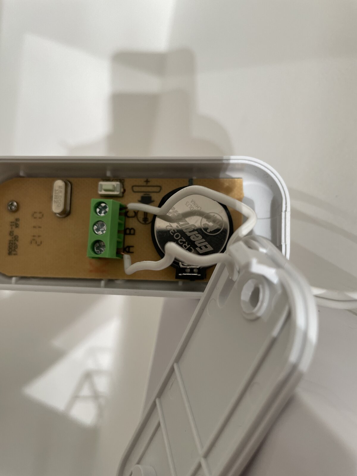

Any advice appreciated.
I puchased a Byron BY32 wireless doorbell extender - manual here https://cdn.shopify.com/s/files/1/0054/2054/8214/files/BY32.pdf?v=1637834150
My existing bell push and chime just isnt loud enough so this provides me with 2 additional plug in chimes around the house. When its working it works well.
Wired it all in as per instructions and it has been working fine with one flaw. It eats batteries. A new (quality) CR2032 every 6 weeks or so. Obviously we don't realise the battery is gone until we miss a delivery or visitor. I've contacted the vendor, but wonder is there something I am doing wrong and/or can it be powered without the battery?

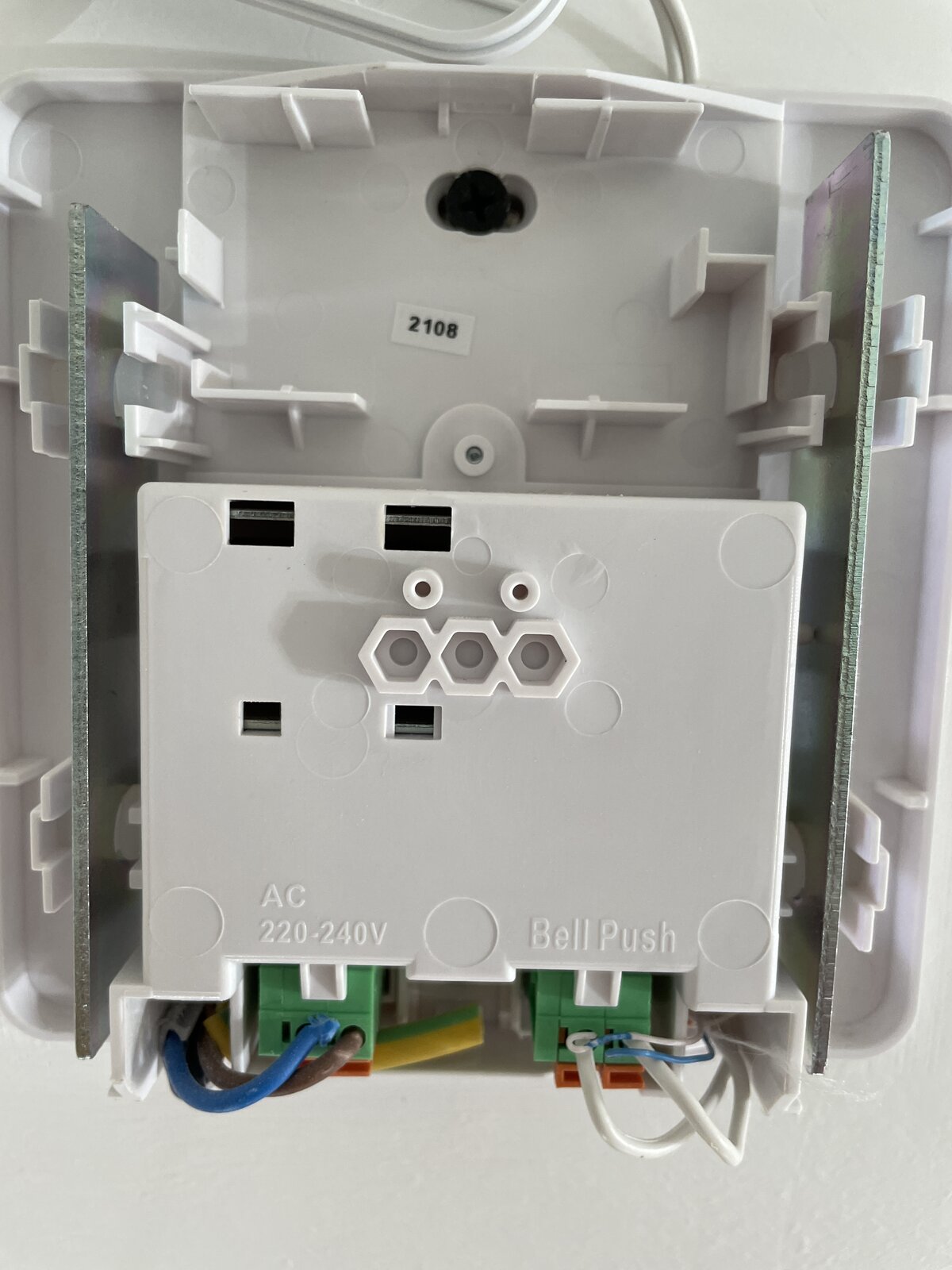

I have opened the existing original chime and wired the BY32 from the bellpush terminals. I note the 240v input to the chime unit.
I've looked at the BY32 manual and note it can be used without the battery, but I'm just unsure if thats possible with my set up.
Photos are attached of the existing original chime unit and the BY32. Any advice on how to wire this up so I'm not changing a battery every 6 weeks?

You have option two in the manual at present ,https://cdn.shopify.com/s/files/1/0054/2054/8214/files/BY32.pdf?v=1637834150
This is where its tricky as we don't know what's the bell push on the bell housing is attached to , I would assume that its a circuit that is closed when the bell is pushed thus activating the solenoid. you can try swapping the A to b in the extender and the c to a but without knowing how the bell is wire up internally that's a guess.
I tried terminals A&B on the sender but the chimes were chiming constantly. The manual suggests if that happens to switch the wires B&A which I did but pressing the bell push has no effect at all now.
I've put it back to A&C with a new battery (again) and am awaiting further info from the vendor that might help.
I read those instrction as you CANNOT use it without a battery.
And I feel you are reading the manual slightly incorrectly.
When it says with battery - it means the actual doorbell is a battery type of Doorbell (which I believe yours is even though it is mains as it works bt detecting the push switch and sounding an electronic buzzer.
When it says with transformer - it means the actual doorbell is a transformer type of Doorbell that uses the transformers magnetic field to mechanicually sound a bell.
The two types of doorbell attach to different contacts (A, B and C) within your extender, becuase they use diffrent mechanisms to make their bell sound.
