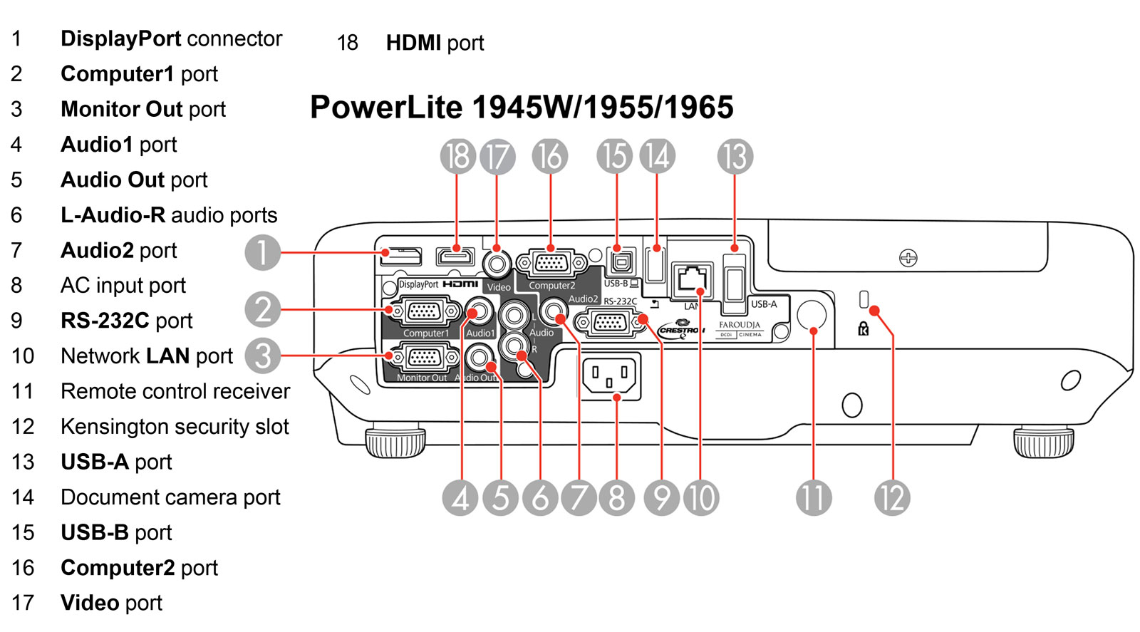

The hall also does have a ceiling-installed Epson.
https://www.epson.co.uk/products/projectors/installation/epson-eb-1945w.
https://files.support.epson.com/pdf/pl1940/pl1940ug.pdf
We use a VGA adapter and a Mac adapter if necessary, which trail across the floor....:(

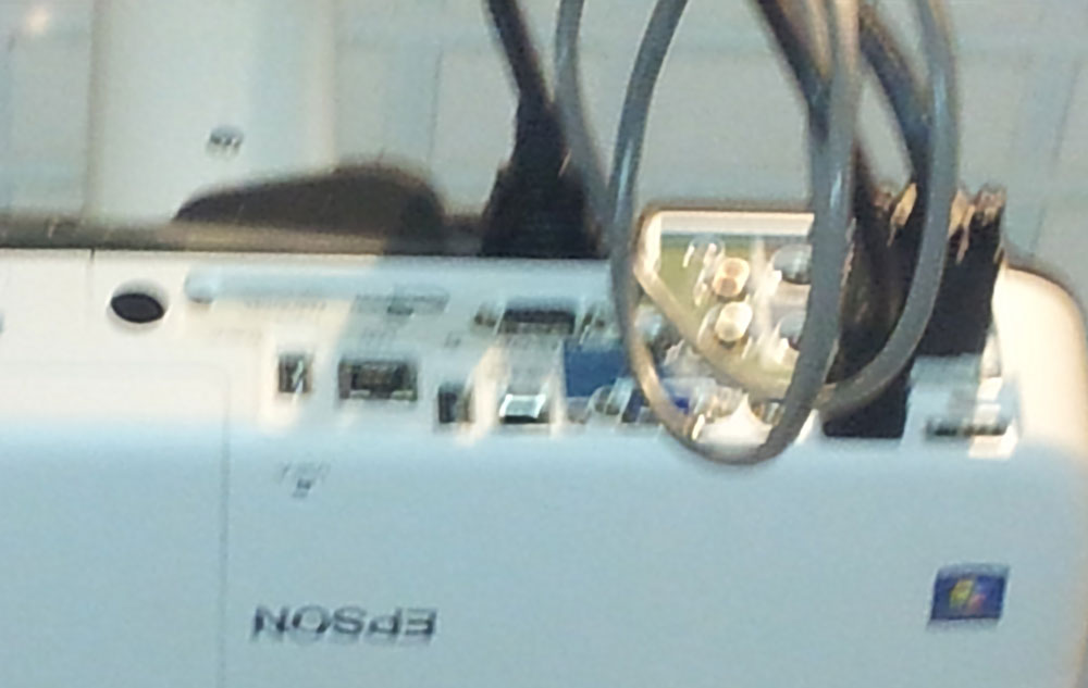

It looks like the ceiling Epson's HDMI is connected - sorry the pic is lousy:
as it seems the HDMI ole has a plug in it. I assume the lead comes out somewhere! Access to the hall is only when we have meetings so I can't looksee easily.
If we had to leave something dongling from the projector, I expect we could.

Your projector has two video/data connections wired up. One is HDMI, the other is a VGA socket. HDMI is digital and VGA is analogue.

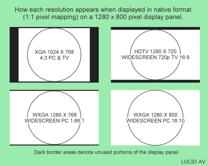

There are four optimum resolutions for your projector. 'Optimum' is defined as the signal resolution can be displayed without needing to be expanded or reduced or distorted in any way. We call this 1:1 Pixel Mapping. These four resolutions are:
XGA - 1024x768 - a 4:3 PC & TV format
HDTV - 1280X720 - a widescreen HDTV 720p format
WXGA - 1280x768 - a 16:9 widescreen PC format
WXGA - 1280x800 - a 16:10 widescreen PC format
If a laptop is set to output any of these resolutions, and the projector's Aspect setting is selected as Auto or as Native, then you will get the sharpest clearest image that the display panel is capable of producing.
The other aspect ratio choices from the projector menu will result in the image being expanded or shrunk, often with either a squashing or stretching effect that would turn a circle in to an oval, or it can show up as cropping so that some portion of the image is missing.
The thing that gets a bit messy is when the laptop is a different resolution to the projector.
Your speakers will generally want to use their laptop screen as the monitor during their presentation. Since most laptop and desktop VGA and HDMI outputs support only a single resolution at any one time, then if the laptop screen is say 1920 x 1080 resolution, the choice is either to feed the projector with a signal that it then has to compress, or run the laptop at 1280 x 768 which results in either a shrunken image or one that looks horribly distorted on the laptop screen.
There is a simple answer to this. Buy a desktop monitor that is also 1280x800 resolution, and then have the laptop set to 'external monitor only' mode and feed the one output signal in to a two-way distribution amplifier (an amplified splitter). Thus the presenter gets a good image and so does the audience.
