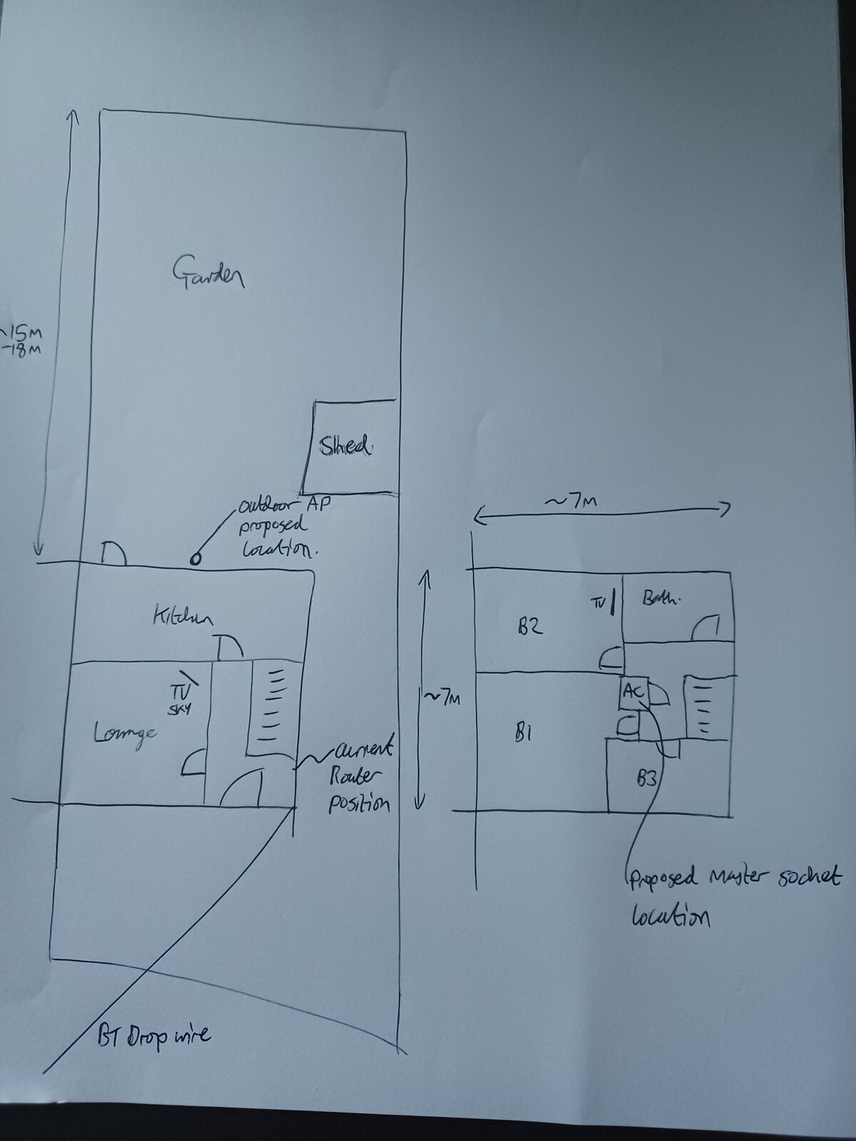

Picture below. Wondering if anybody here can help with this. At the moment I have a newish sky router on an old copper line. It is in an unfortunate position on the hallway windowsill in the front corner of the house, where the master socket is. Reception is poor in both large bedrooms and the back garden.
There would be enough slack on the main phone wire coming into the house to reroute it through the gable end, loft, and into the airing cupboard which is central to the house. I can then fit a socket in there and centralise the network. From there I can run cables to access points and all the rooms where necessary for TVs etc. However, I still suspect reception would be poor in the garden. Openreach are currently putting in cables for fttp, which when my contract expires I will be signing up for. They can fit their termination point in the box room and I'll run a cat6 cable to it from the airing cupboard. I have a growing family with demands from smart TVs, tablets and phones, as well as smart switches in the house, shed and garden (when I can get a signal to them).
Is it possible to buy an access point such as this one
TP-Link EAP110-Outdoor 300Mbps Wireless N Outdoor Access Points, 24V Passive PoE, Easily Wall or Ceiling Mount, Free EAP Controller Software https://amzn.eu/d/fA9amZP
And configure it to broadcast the same network as the sky router for seamless transition from home to garden? Or would I be better buying an additional two APs for the house as well and abandon the sky router for WiFi?
I'm not fussy about a 5ghz network unless it's somehow beneficial - frankly I find it slightly troublesome when setting up certain smart switches which insist my phone is on the same 2.4 network as the device I'm setting up.
Turn off the Sky box WiFi, connect a dedicated router to the ethernet port on the sky box. I use the Asus RT-AC86U, with multi directional antenna. It's by no means the best anymore I'm sure, but the signal across the house is double what the Sky box can achieve.
I then use powerline plugs from TP-Link to get same network up the garden

Yes you can buy any access point/repeater/wifi device you like and have it become an additional node on the same wifi network.
Just set the SSID and Password the same, and it will behave as another point of connection for the same wifi network. The client devices will (should/might/probably won't) pick the best quality signal.

Look for mesh wifi systems to replace the ISP router wifi - they are designed to be more seamless that multiple APs using the same SSIDs. Mesh units also tend to allow the 5GHz to be turned off temporarily when adding smart devices on 2.4GHz.

I use Deco home mesh system, one unit plugs into router ( and actually provides better speeds than router) and one more units send to rear of property and rear annex where third unit sits ( about 100ft away).So far faultless performance .House units sit in loft (bungalow).
Don't bother moving the master socket, leave the router where it is, turn its wifi off, fit commercial grade PoE access points (eBay for ubiquiti unifi) in the upstairs hall, downstairs hall and outside. Run cat6 to all points - one wire carries power and data. Run more cat6 to sockets for TVs on bedrooms etc and hard wire them back to a decent gigabit switch connected to the sky router
