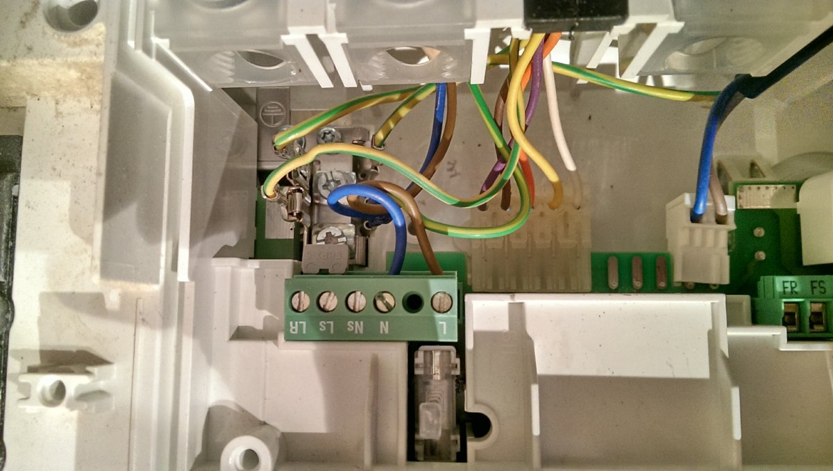

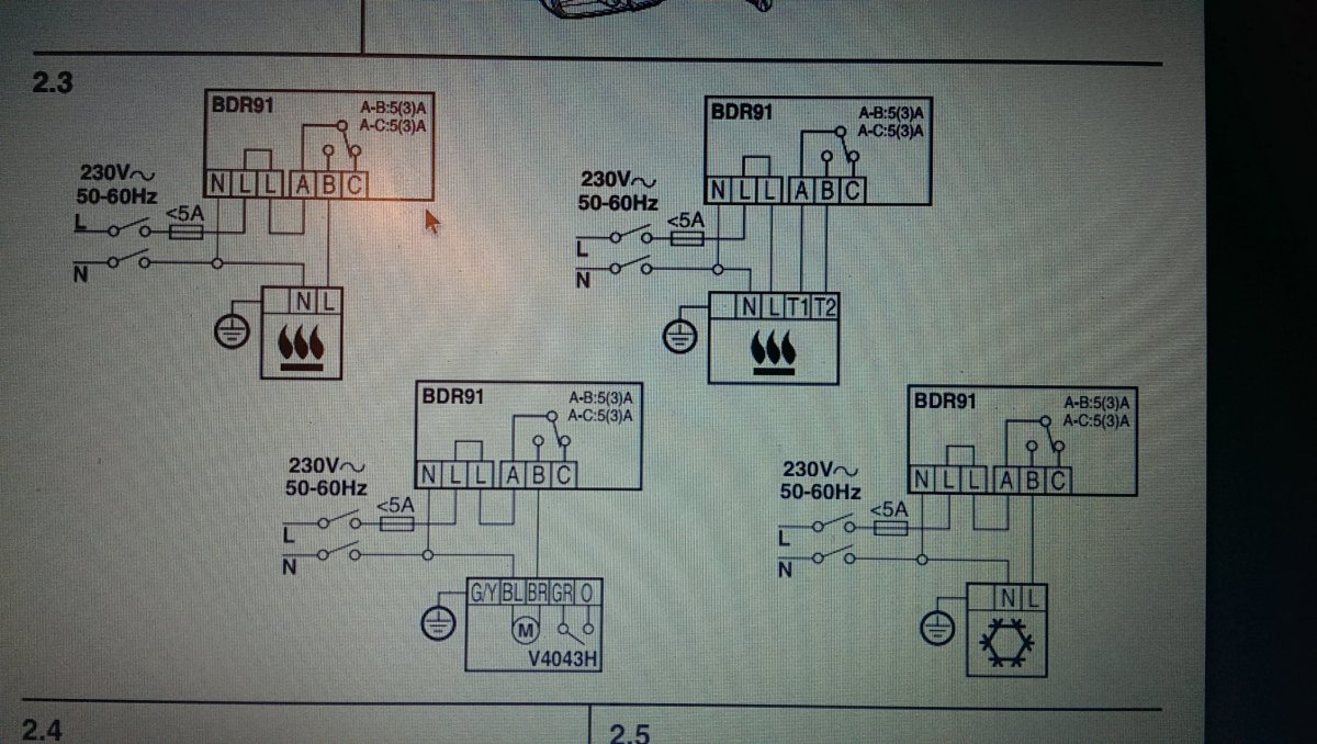

Hi,
I have a Worcester Bosch Greenstar 24i Junior, and need to fit a Honeywell DT92E Wireless room thermostat.
I have the following connections on my boiler:
LR, Ls, Ns, N, and L, see pic attached.
Also attached is a pic of the DT29E relay box/ base unit wiring diagram. I think the bottom two diagrams are for a motorised valve, and frostat, right?
I have taken the power for the relay box from the switched spur. I've connected 'LR' on the boiler, to 'A' on the relay box, and Ns on the boiler to B on the relay box.
I'm really not sure this is correct, but from google searches, this is what I've come up with.
So, before I put the fuse back in the spur and switch on, can someone offer their advice pls?

The correct wiring is:
Connect Ls to A
Connect Lr to B
That's it. C and Ns are not used.
(You got the power side right.)
yep, did some more digging, and it is Ls- A and Lr- B
