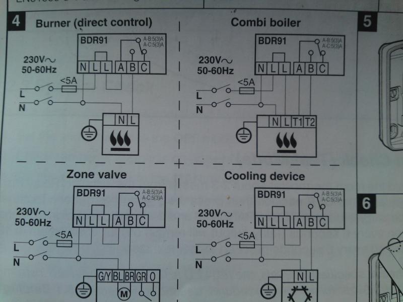

Hi Guys,
I have a brand new Vaillant ecotec plus combi boilder installed and need to wire up my new wireless CM900 thermostat and BDR91 relay box.
At the moment i cant see how the to 2 wiring diags marry up so id like some help with what needs to connect to what.
combi boiler diag:
relay box diag:
Cheers.

Switch wires from stat to 3 and 4.
L&N to feed outside boiler, but I guessed you worked that part out. :D
here is how to connect the bdr91
boiler....................bdr91
5...........................N
3...........................L
4..........................B
link L and A in the relay box.

Just to confirm, i must remove the bridge between 3 and 4 on the boiler as it says?
Also, would it be ok for the relay to get its power from the L and N terminals inside the boiler, marked as Mains Supply: 230 V/50 Hz?
I ask because its going to be difficult to get another cable from the switched spur.
or is this not a good idea?
Remove bridge.
Connecting to he live terminals in the boiler is effectively the same as connecting to the spur, should work fine.
just realised, the relay box has 2 L's. Which L needs to be connected to A?
Are the 2 l's internally bridged?
I only have the diags that i posted pictures of to go on and they do show a connection between the 2 in each one.
I guess iv answered my own question as either will do since they're connected in the device itself?
