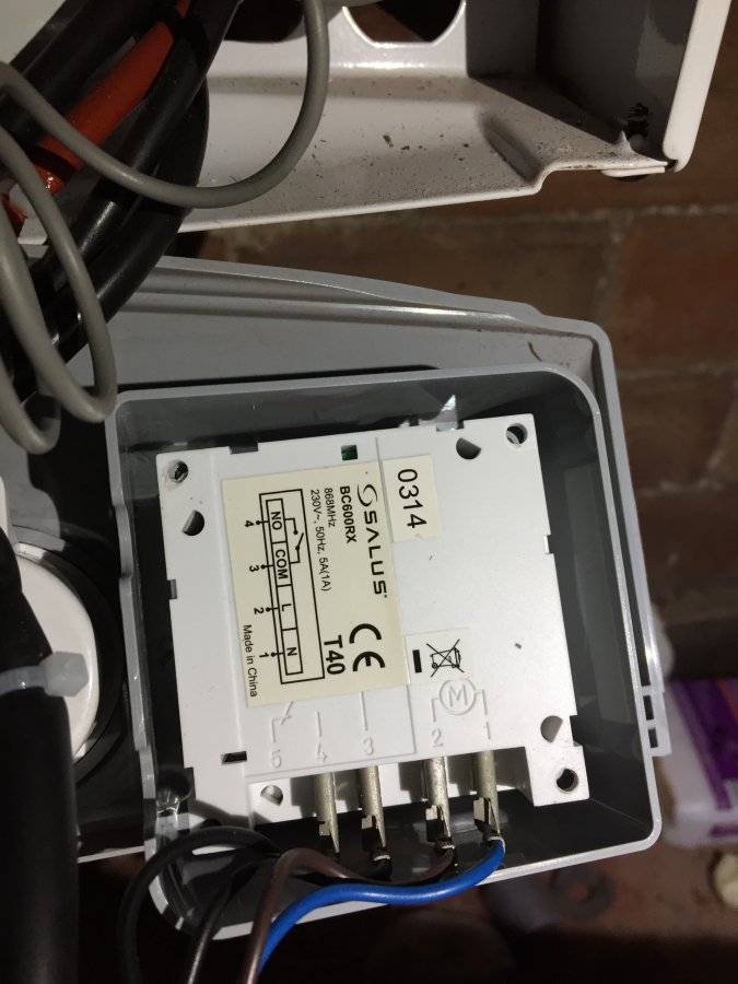

Currently I have a Salus wireless thermostat connected to a RF boiler control that's already wired to the boiler.
I've taken some pictures of how the RF control is wired at the moment and it's manual.
Is it just a case of me removing the RF and wiring the Heat Link to the same terminals the RF was wired to?

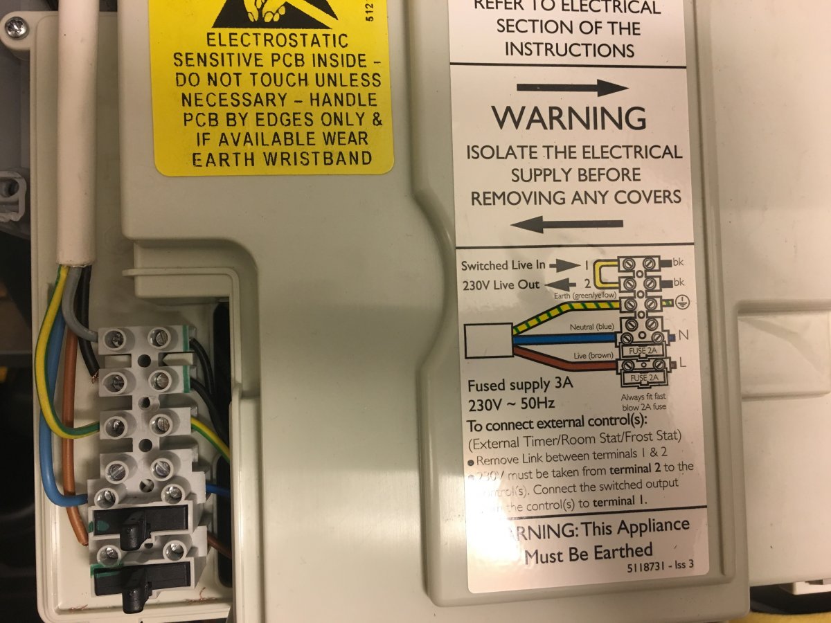

From the boiler picture you have referred to, which I have copied below, and as it was posted by someone else, I assume you have linked to for illustrative purposes and is not actually your boiler. The top two terminals shown with the yellow link are the ones you are interested in. If still present, the link should be removed, and one of the terminals connected to the Salus RT500RF 'NO' terminal and the other to the Salus 'COM' terminal
Then the Salus receiver also needs a Live and Neutral supply, this should be connected to the L & N supplied from the same fused connection unit as the boiler.

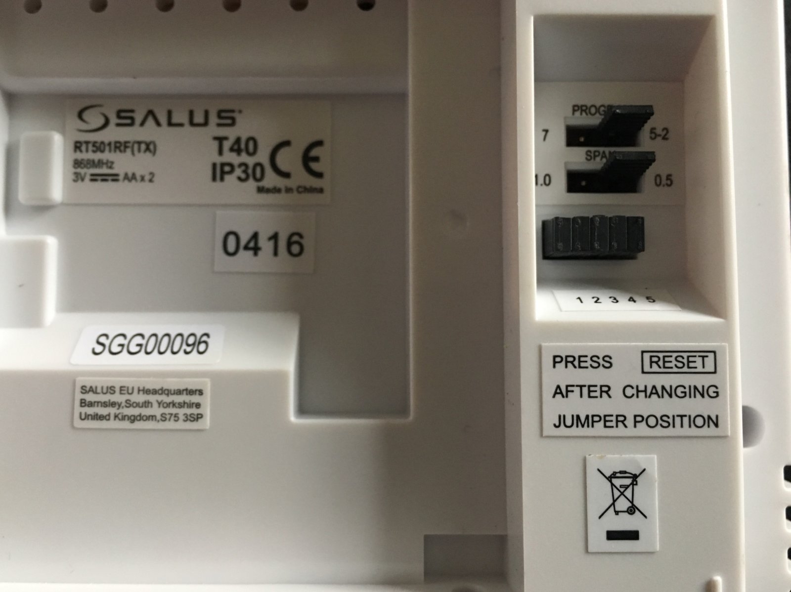

B3B0AA4B-EC08-4A1B-8A52-E967EE87B89F.jpeg There isnt anyway of wiring the thermostat to the no terminal and com as you can see from back of the salus. As for the reciever i have replaced the old dial bit like for like wiring. Them 2 top wires are there from the old hard wired to the thermostat so the link isnt there now.
Correct, the Salus thermostat is battery operated and doesn't need any wires. The wring goes to the Salus Receiver, as I have described for you, and the thermostat communicates with the receiver by RF.
Sorry I don't understand any of that, (other than the link isn't there, which is as it should be) How many wires were connected to the original thermostat, where were they connected to at the thermostat and what was each connected to at the other end of the cable?

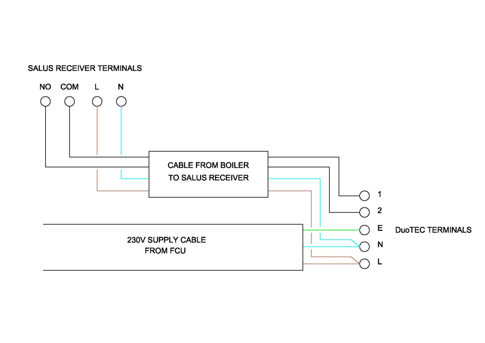

Regarding the boiler and Salus RECEIVER, this is what you should end up with.
If you still have problems decommissioning the existing timer, then.....
