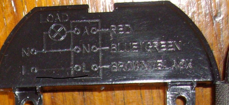

Hello, I hope you can help. I have a stand alone MiniSun PIR sensor and I am trying to wire it to a strobe light (as a heron deterrent hopefully!). The sensor has 3 terminals - 'A' Red 'N' Blue/Green and 'L' Brown/Black. The strobe light has 2 wires, blue and brown (no earth). The power source will be a three pin plug and cable. I am not sure how to wire it up, the wiring diagram makes no sense to me, sorry to say.
Any ideas? Thank you.
Is that a Red,Black, Yellow cable?
Supply:
Red to L
Black to N
Terminate earth wire safely out of the way.
Light:
Brown to A
Blue to N.

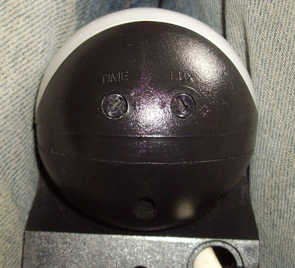

Hello and thanks for the quick reply. Have wired it up but no response from the PIR. No click or anything? Please see picture.

Hello and yes. Even though the instructions state to 'Turn the LUX knob anti-clockwise to maximum (SUN) - the arrow points to the moon. 'Turn the TIME knob clockwise to the minimum - the arrow is on maximum. That doesn't help does it!
Thanks for that. I hope that I am learning from my mistakes too. There appears to be a contradiction in the 'settings'. I assume the pic shows the correct setting.
