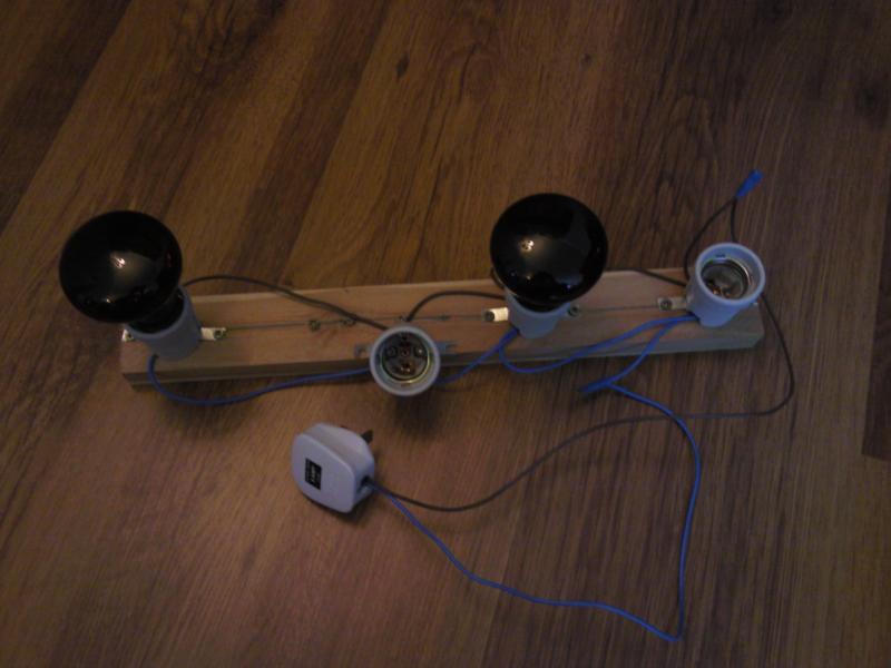

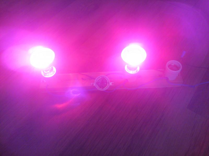

Hi everyone im new to the forum
I need help wiring 4 E27 light fixtures in parallel to a plug safely.
on the bottom of the light fixtures it says 4A 250V & each bulb will be around 30 watts
question 1 which fuse do i need for the plug?
question 2 which flex cable do i need? rating in amps & cable size ?
question 3 what is the safest way to connect the wires?
question 4 do i need to use a earth wire?
I would really appreciate as much help and advice as possible

So that is 4 lamps at 40 watts making 160watts in all. So you would need a 3amp fuse. Cable size 0.75mm² minimum.

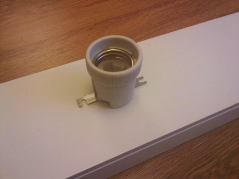

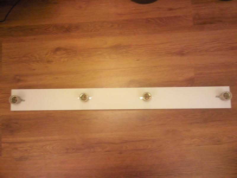

i found some old PVC trunking 1000mm the plan is to drill 4 holes to hide all the wires inside and have just 1 wire with a plug coming out the end.
So you'll just loop the wires from lamp to lamp
Live down one side
Neutral down the other
Earth connected to the securing bar at the centre
There's a drawing of how to do it in the much ignored WIKI
see it here //www.diynot.com/wiki/electrics:lighting:parallel
For all the effort you are planning to put in, it would have been much better to just buy a 58watt fluorescent strip lamp. No work involved and the lamp will last 10 times longer than E27 tungsten lamps.

By using the terminals provided.
But have you thought about what you will do for strain relief?
Have you thought about what you will do about the exposed connections?
Have you thought about what you will do about unsheathed conductors?

My advice is that no way on Earth should you be attempting to make your own electrical items.

But joking aside the questions asked do indicate a lack of the basic knowledge and experience to do the task safely no matter how much information is provided here.

What bits of using sheathed cables and providing strain relief do you not understand?

My idea is that you should go and buy something properly made and safe.
