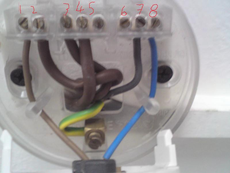

Hi I am trying to wire up a new extractor fan to the light fitting in my bathroom, the instructions for the fan ask for L, L1 and N I am not sure which terminals I need to connect it to, I have attached a picture of the light fitting:
You will require 3c+e to connect it up. I'm guessing this is a timed fan?
In between L/L1/N and the following terminals you will require a 3 pole isolator.
Brown between L and 5.
Grey (sleeved blue) between N and 6.
Black (sleeved brown) between L1 and 2.
Work in a bathroom is notifiable and RCD protection is required.
Hi stephen L=Permanent Live, L1=Switched
Bongos, this is a switched fan
I dont have much electrical knowledge! Do you suggest I call in an electrician or do you think I would be able to do this myself? The fan is labled well just not sure where to wire up the other end! If I were to call an elctrician how much do you think they would charge? Thank you both for your quick replies.
new install, the fans set up, just needs wiring.
Get in a spark. You need to run 3 core and earth (Live Switched Live and Neutral) from the light to an isolator and fused spur if required then back to the fan. This all needs to be tested and inspected and notified (Part P). Plus there are other factors like the location of the fan, safe zones, earthing, RCD protection, etc.

Connecting the fan via an isolator is a fairly straightforward job to complete. But it's not worth putting your or anyone else's safety at risk if you are not happy to do the work. Also, as it will require notification to the LABC to do the job properly, it would be cheaper to use a spark who can self notify.
The cost of an electrician to intsall the fan could vary. It may be that your CU needs updating if it doesn't have RCD protection. Also the protective earth bonding may need to be upgraded. If the former is the case then it would definately be a job for a spark.

But if your existing CU/bonding is upto scratch (which is more likely as you have new wiring colours) then it will be less. FYI, all circuits in bathrooms require RCD protection now so a RCBO may be required if your lighting circuit is not protected by an RCD.
