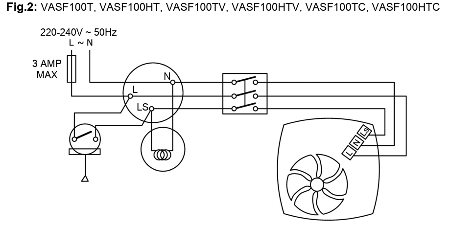

i suppose with installing the switched fused spur i have the isolator there
Well, it'll serve as a fan on/off switch, I suppose. But it won't isolate the fan as it is connected to line, switched line and neutral.
These three are all defined as live conductors, and an isolator has to break all three to properly isolate the device.
But you are where you are now, but you'll have to decide which two of the three will you run through the fused switch. Really the easiest place to get all three (plus earth) is from the light itself - not the switch - as shown in the Vent Axia diagram in post #13.
ok, i think i get you. The fused spur isnt needed (as you said earlier) , but instead buy a fan isloator switch.
Put a junction box (or similar) in one of the cables in the loft from one of the lights and take that down to supply the switch with L, N & E.
And then feed out of the isolator to the fan with L, SL , N as no earth is needed.
Thanks for your patience, i can usaully work these things out but dont want to risk getting this one wrong.
Changing things around isnt an issue if needed, ive got the room, time & patience
