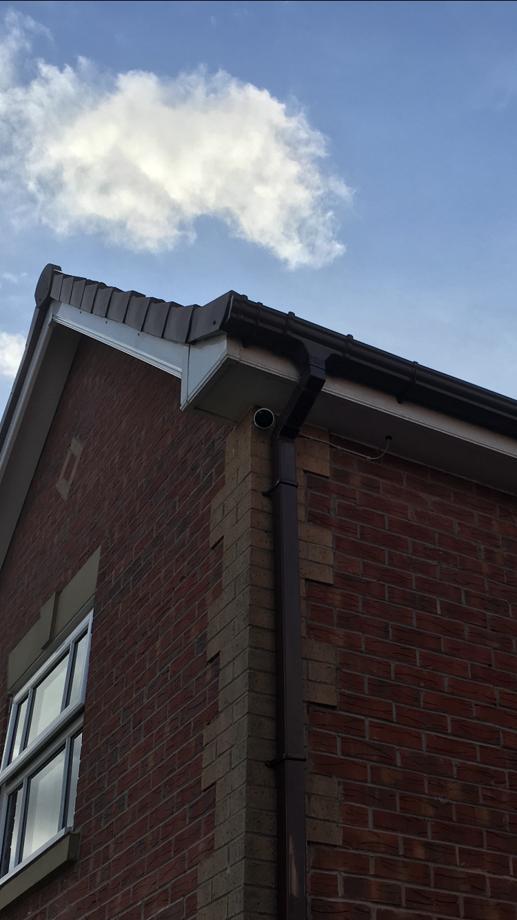

Well my last thread got locked so I’ll start a new one to show what I did:
Camera added just below the eaves so it’s not too conspicuous. I threaded the attached cable through a 20mm hole in the soffit which was then plugged with a grommet.
Standard socket spurred off the loft circuit and cables routed along joists with clips. Camera plugged into socket - job finished. Thanks for all that helped on previous thread.
