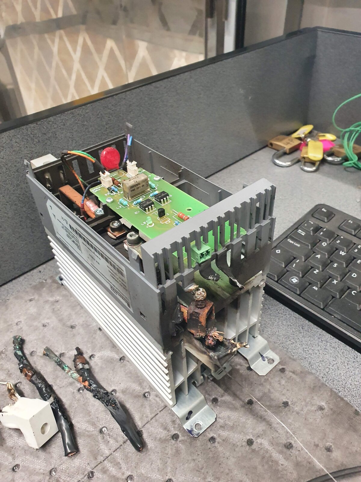

Not entirely relevant to the post, but we've just had an SSR fail at work, a 100amp SSR protected by a 160amp fuse...
The cables next to it are the remains of the supply cables
My role isn't electrical I just use the facility

I imagine that fault wasn't hard to track down :eek:
I'm guessing that the fuse protection wasn't within the spec for the device, and so a downstream fault took the SSR out with it ?

Hi SimonH2,
Upon further investigation the service engineer believe the output / load cable from the SSR to the heaters was loss which overtime generated significant heat slowly degrading the cable to the point of failure. At the point of the failure the resultant heat from the arc as the cable failed fried the SSR's circuit board opening the connections and thus removing the power to the damaged cables.
In total this facility has 2 SSR's controlling 74kW of heating load!
