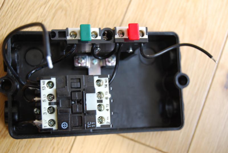

recently purchased an old dewalt planer thicknesser, which is 240volt. The guy who sold it to me said the capacitor needed replacing. Having opened it up i found he had also disconnected the wiring to the starter and a few bits were missing etc.
Ive replaced the capacitor and having wired it up to bypass the starter it does work. Ive now bought a replacement, but im a bit confused since it came with no wiring diagrams.
Basically i have a live neutral and earth from the suppl and likewise for the load going out. WHich goes where, and whats confusing me more is where do teh two black jumpers connect to? one comes from the terminal 13NO and the other comes from the red off button.
Ive seen a similar post on another site a few years old which appears to show a similar dol, but with a thermal overload relay in there as well. The jumper wires appear to go to that in the picture. The original dol didnt have one in it, but the box containing the capacitor does have a reset button.
So in short do i need a thermal overload relay, and if so, what size ampage do i need. If not, what do i do with the jumper wires?
many thanks for helping out a confused idiot.

Looks like the black wire to red button wants to be in a contact terminal with the incoming live. The black from the n/o would either go to the A1 or a n/c on an o/l, if required.

You have no overload in that DOL starter. I assume you only want it for the no volt release and not to portect the motor? The black links are to connect into the overload when fitted. Just join these together if you do not fit an overload.
Mains in the top, load out the bottom. Earth together in a terminal block.

I drew a pic for someone some while back which will likely help, although not identical.

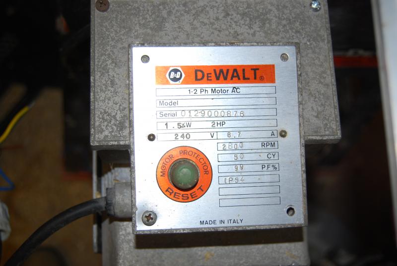

Yes its correct there is no overload in the dol starter, it didnt have one in the original. Ive attached a photo of the box containing teh capacitor and the motor protector
now ive got confused by the other replies!
so keeping it simple fill in the blanks for me
SUpply live goes to
Supply neutral goes to
Live load goes to
Neutral load goes to
(ive got the earth bit sussed dont worry chaps!)
The black jumper from 13 goes to
the black jumper from teh red switch goes to
or are thses both wired together?
Can you just confirm that the coil within the contactor is rated at 240v and not 415v?
The retaining contact is usually part of the green button on most DOL starters - not in this guys case though.
