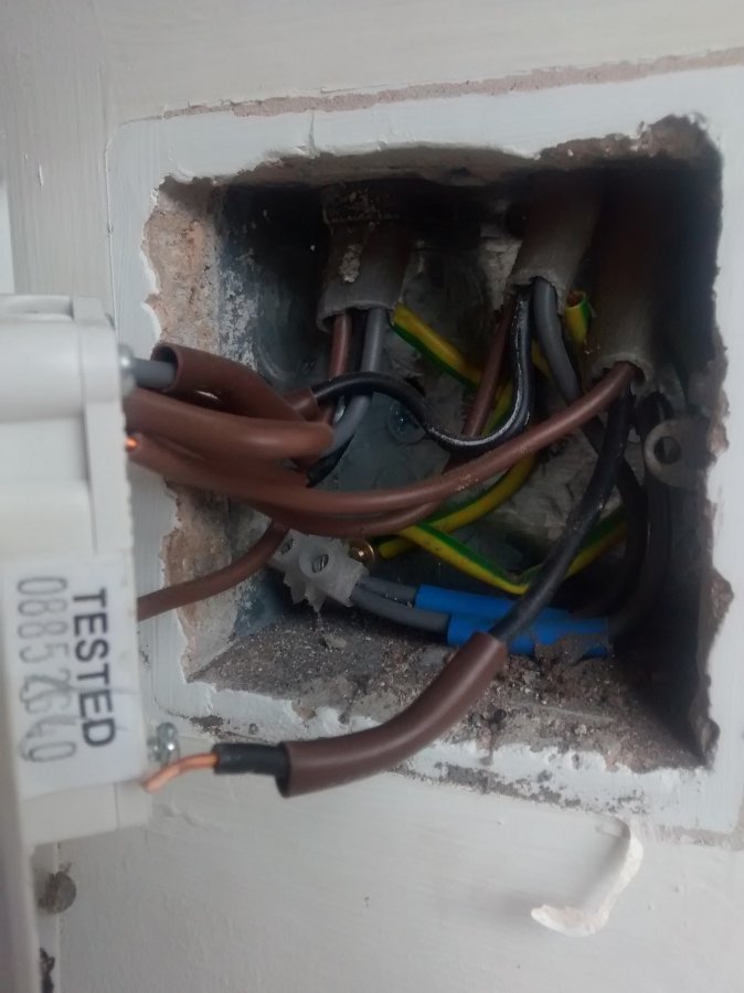

Our outside light (PIR and dusk activated) has started staying on all the time, even when the switch (inside the house) is turned off.
That switch is in the hall - it's a double, with the right hand switch controlling the outside light, left hand switch controls the hall light.
There's another switch for the hall light at the other end of the hall - so those switches are 2 way.
(If it's relevant - there are actually two pendant lights in the hall, both controlled together)
I've turned off all lights at the fusebox, checked there's no current, and unscrewed the wall switch.

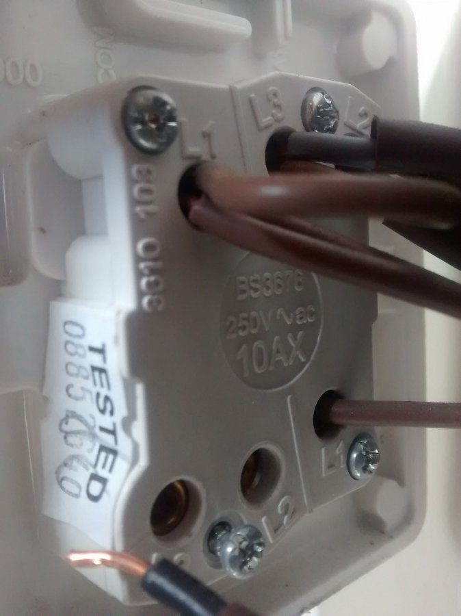

It looks to me like a wire has become disconnected from the right-hand (outside light) switch - but I don't know if it should be in the L2 or L3 connection. You can see the wire at the bottom of this pic:
Here's a look at the wiring coming into the socket if it helps:
All advice much appreciated!

The wire is probably L2, if the switch operates upside down (as in up is on), then move the wire to L3.
However the light staying on is unrelated, the hall switch is presumably an override to turn it on all the time, or have the light in 'auto' mode when the switch is off.
The light is on all the time because the PIR sensor inside has failed.

There is a 3 core and earth cable to the light.
Grey (with blue sleeve) is the neutral.
Brown is permanent line, and is one of the brown wires into the top terminal of the switch.
Black with brown sleeve is used to override the PIR sensor so the light is on permanently (this is the loose wire).
To echo what has been said, the wire needs to go in L2. (It's a Crabtree, know all about them!)
However, on closer inspection, it seems at least one of the screws that holds the back of the switch to the front of the switch has become loose, as it's sticking out. A little coss-head screw.
Would be wise to tighten that and any others up.
