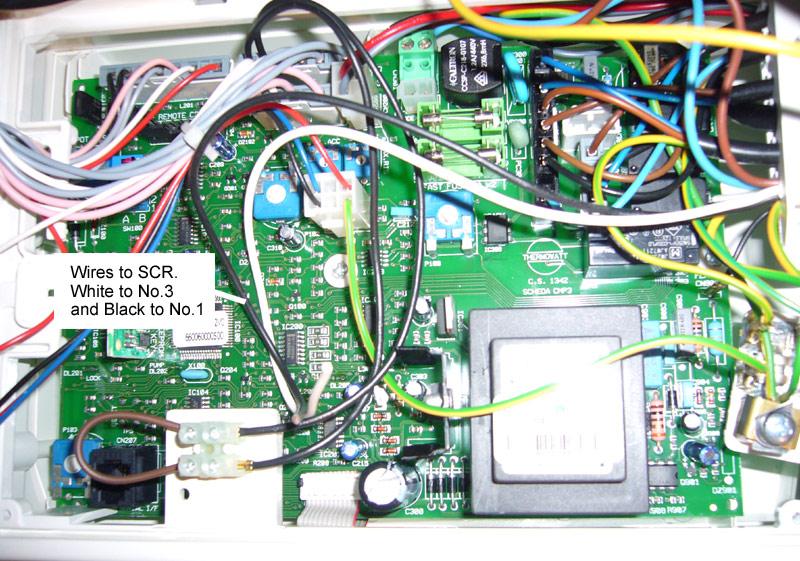

I have got a Ariston MicroGENUS 28 MFFI and I am trying to install a Drayton +2RF wireless programmable room stat.
I have managed to wire the SCR (single channel receiver) with the black wire going to No1 and the White going to number 3.
But what do I do at the boiler end?
Ariston said I can put the wires in anyway round as long as they are not supplying any voltage, as the boiler takes low voltage, volt free connections. I am not sure. So from the picture below what do I remove and put where?
Martin
Hi
Remove the brown link as shown in the photo and connect the wires from 1 & 3 in the reciever.
Steve
Right,
I removed the brown loop wire and placed the wires from the receiver in there. But the boiler wont fire from the Reciever, it is still working on the mechanical timer.
Am I supposed to remove the 2 black wires on the right hand side of the terminal block which are connect to the PCB?
Also am I putting the receiver wires into the correct side of the terminal block?
Martin
Martin
You need to remove the mechanical timer and all wires from it to the pcb. The RF2 is a programmable room stat and will enable you to control the times on/off of your heating and also the room temperature. Make sure that you follow the instructions to the letter when comissioning the unit.
Steve
Just had a thought, do you mean the circular in built timer? If so do not unwire it, simply move the slider switch on the timer to 1 i.e permanently on, this will alow the RF2 to take over.
Steve
Ok thanks Steve. I'll give that a go.
So I have put the wires in the correct place. I just need to remove the mechanical timer.
Ah yes, Steve you're a legend. It works!
Though I wish I had read your second reply before I took the boiler apart again. LOL.
Thanks.
I've got to work out how to use this programmer now.
