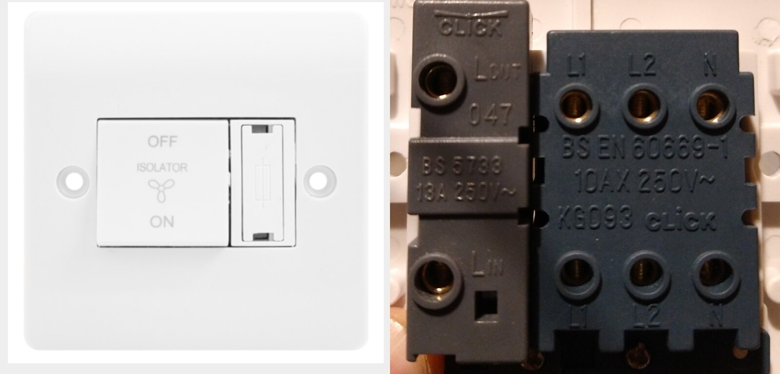

Hi
I am installing an extractor fan that has a built-in humidstat and timer. I ordered a
'10A 3 Pole Fan Isolator Switch with 3A Fuse' to combine having both a fan isolator switch and a FCU.
Has anyone wired one of these up before or would they have a good idea how to do it? It's more the 'L in' and 'L out' element on the back of the fuse that I am not sure about.
The fan is a Xpelair CV4SR that has 3 connections.
I am planning to wire:
L1: Black (Switch live) to 'T' (within the fan unit)
L2: Brown (Permanent live) to 'L'
L3/N: Grey (Neutral) to 'N'
That being the case, where do L in and L Out wire into?

It depends where in the circuit you fit the Switch, how it would be wired.
If you are just locating it between the light and the fan, then -
The Lin and Lout are the fuse connections so Permanent Live to Lin, then a link from Lout to L2 (as you have stated).
However, this will mean that the Switched Live is not fused.
Some say it is not necessary to fuse the SL, but as the fan is on the lighting circuit then it is not necessary to fuse the PL either.

No you don't, you can put the fuse before both the fan and the light, but the fan isolator only in the feed to the fan.
Incoming live to Lin
Incoming neutral to bottom N
Link wire from Lout to bottom L1
Permanent live to switch from Lout
Switch live from switch to bottom L2
Live to light from bottom L2
Neutral to light from bottom N
Permanent live to fan from top L1
Switched live to fan from top L2
Neutral to fan from top N

If it was my house and assuming the fan and light in the room were switched separately, I would:
  • Permeant line to L in
  • Neutral in to the bottom N
  • L out to the bottom L1 and Bottom L2
  • Top L1 to fans permeant line
  • Top N to fans neutral
  • Top L2 to the every day switch for the fan
  • From the every day switch for the fan to the switched line of the fan.
Obviously and of course all CPC's of the circuit would be connect as well.
