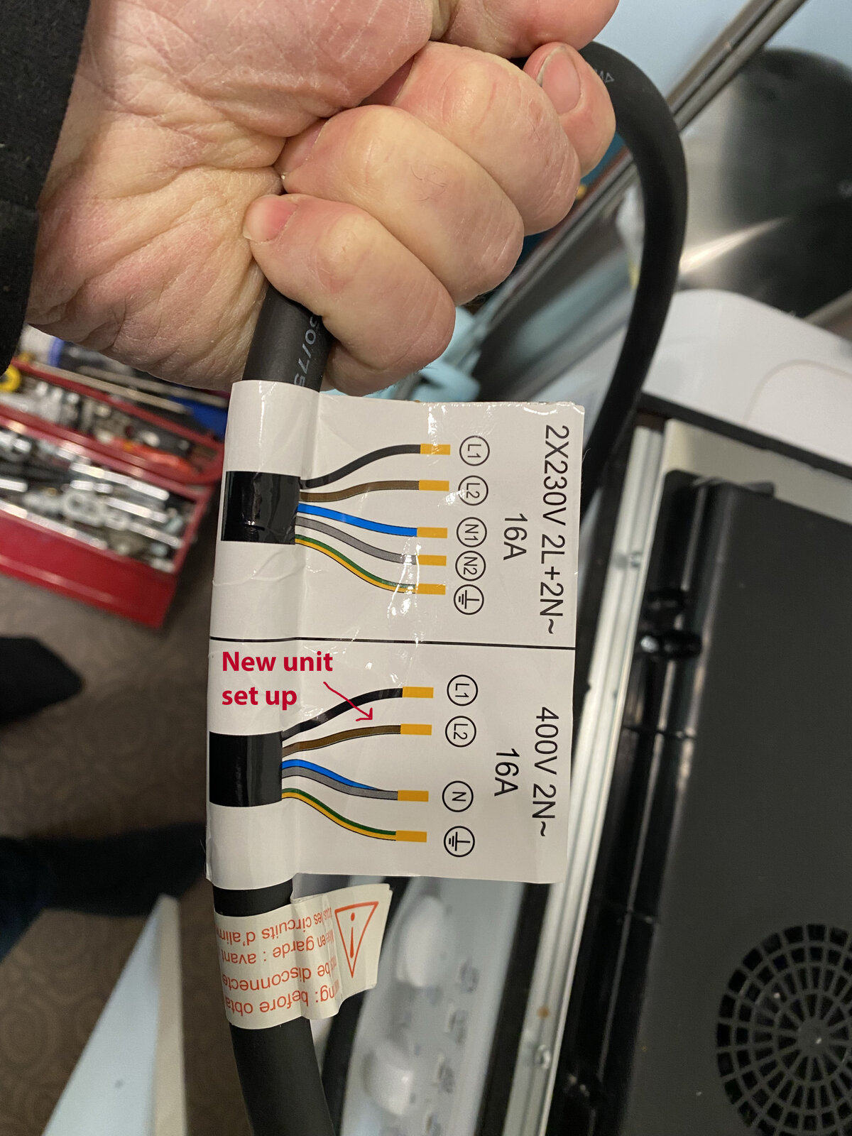

I've bought a new Samsung induction hob which has 2 lives and 2 neutrals. The existing wiring to the standard electric hob has 3 lives and 3 neutrals in 3 sets of wires joined together (3 cables taped together with the 3 neutrals twisted together from each to form a single neutral).
I can't access the other ends of the wires, so my idea is to buy a 45amp connection box and plug the 3 neutrals / 3 lives of the existing wires into one side and the 2 lives / 2 neutrals from the hob lead into the other.
Also, any links or suggestions for an appropriate connection box for this would be very helpful.
Will this be ok or do I only use 2 lives and 2 neutrals from the existing wiring?

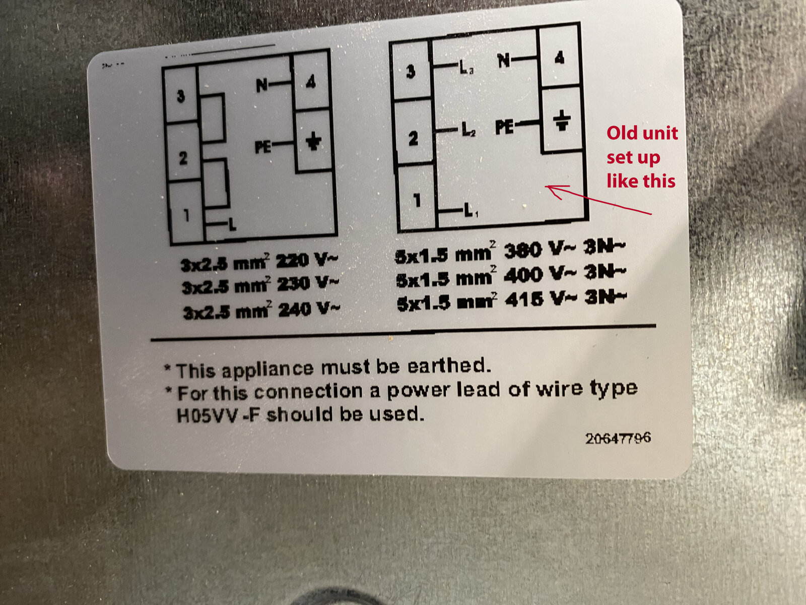

Your oven has been designed to either deal with different numbers of phases, the electrical wiring instruction that come with the appliance show how to wire yours to single phase.
Follow the diagram.
Follow the diagram
This is beyond my knowledge, if I hire an electrician, will they be able to use the existing wires to connect to my new induction hob?
I’ve just fitted a Neff induction hob to my kitchen when I was doing a refit. Like yours, my new hob had a cable supplied with the hob with 5 wires too - two lives, two neutrals and an earth. I already had a 45amp cooker control unit fed by a 6mm cable going to my old oven which is where I was fitting the hob (new ovens are now in a different location with their own dedicated circuit) so I used that. I just connected the two lives going to the hob to the live in and did the same with the neutral. It’s working fine. It looks to me that someone has used 3 x 2.5mm cables instead of 1 x 6mm cable (possibly for cost reasons). I don’t know if that’s safe but you now have a 7.5mm feed and it’s obviously been working. Are they going to their own breaker in the consumer unit? My 6mm cable goes to its own 50amp breaker. If it was me, I’d do as you propose and get a 45amp cooker switch and connect it up via that, the same as I did with the 6mm cable - 3 x 2.5mm lives into the Live in, 3 x 2.5mm neutrals into the Neutral in and the same with the earth. Then connect the cable supplied with the hob to the corresponding outputs. I must say, I’m not an electrician so I expect I’m going to get a telling off from the electricians on here!

That sounds good to me, I think the Phase thing is confusing me. As you suggest I reckon they used 3 cables because they had them handy rather than purchase a new thicker one. I'll try it and see. The kitchen has very budget units and is a bit shoddy, so it makes perfect sense
Wired in parallel. It could have been that the person whoever wired that only had 2.5mm with him. The CPC gets oversized in this configuration but its no biggie. The OP should be wiring the oven as usual (single phase as stated in the instructions.) CPC will also need sleeving.
